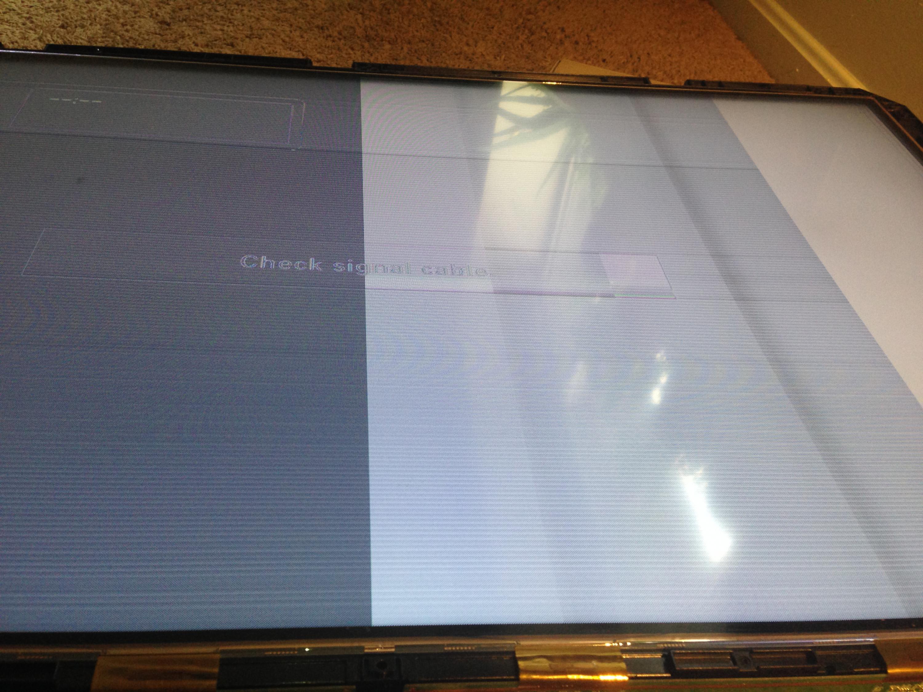

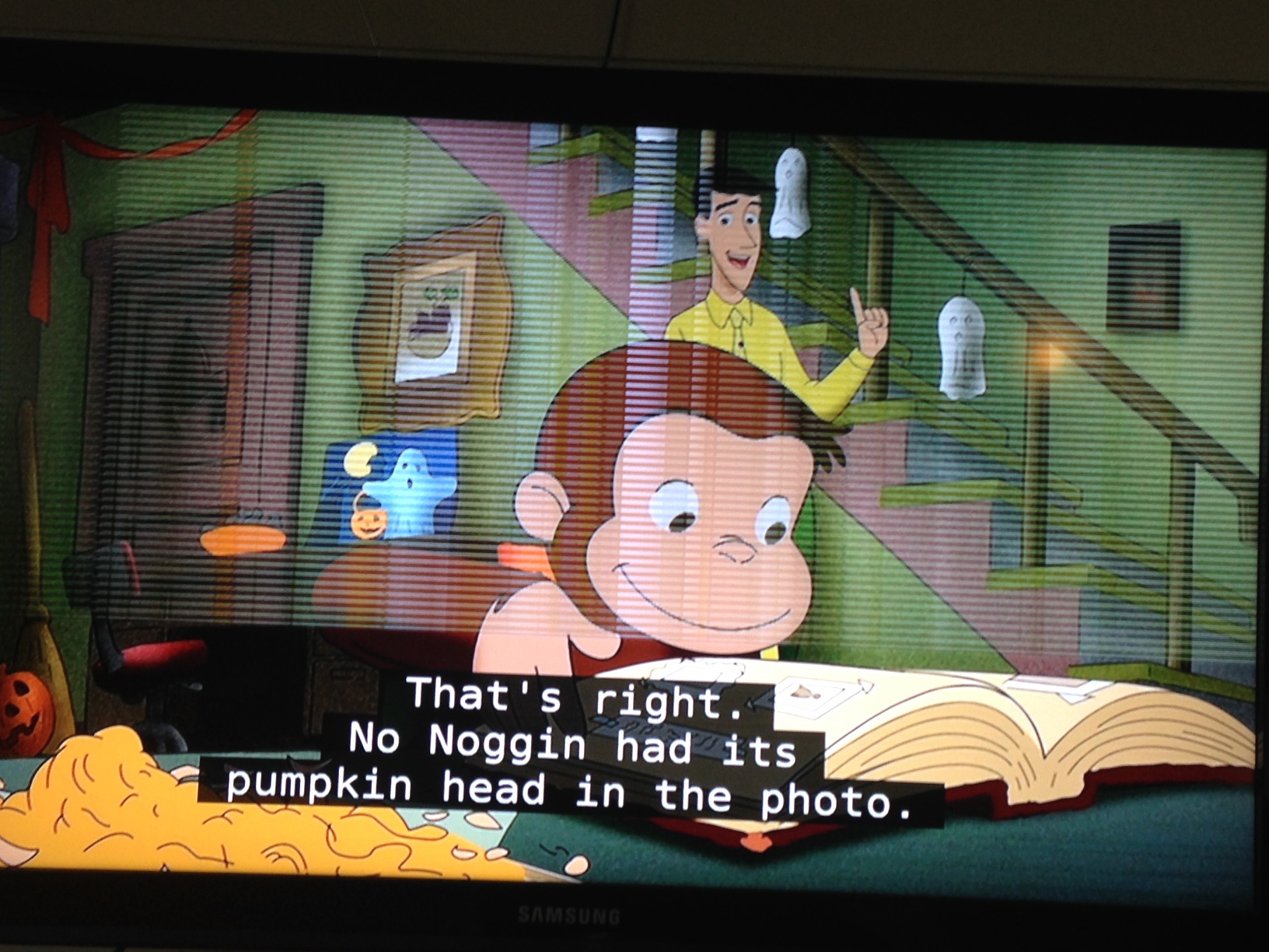

          I have replaced the LVDS cable and I can see the picture now (75% with horizontal lines and remaining 25% with good picture). Please see attached image.
          When we replaced a T-CON with Sears TECH, we were not able to verify the pitcure as LVDS was faulty that time. Now I am going to order a new T-CON and see if this resolves it.
          I will also try shuffling T-con cables. Thanks for all your suggestions.
          Please post your comments after looking at this image, anticipating to hear that it is not the panel and something else.

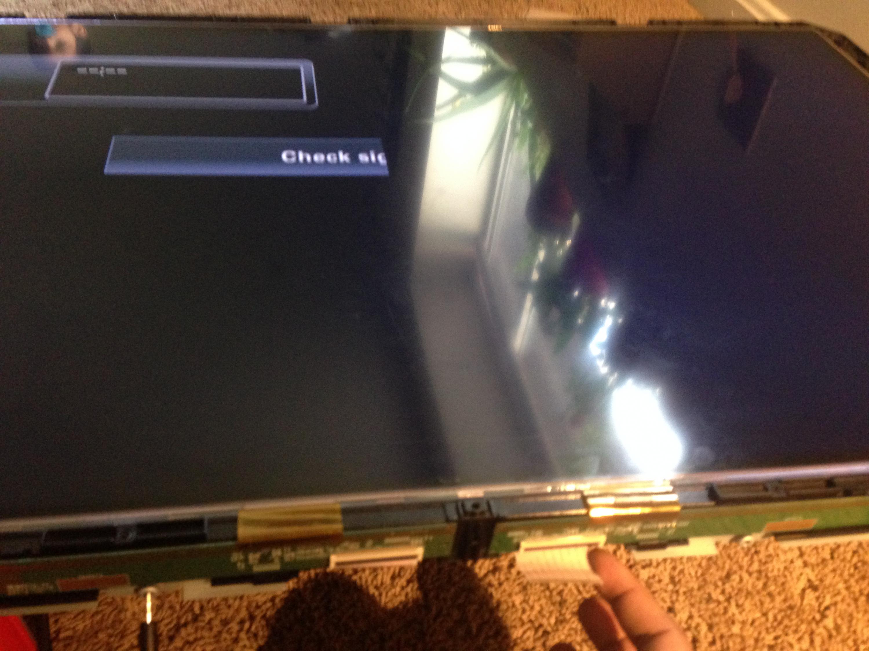

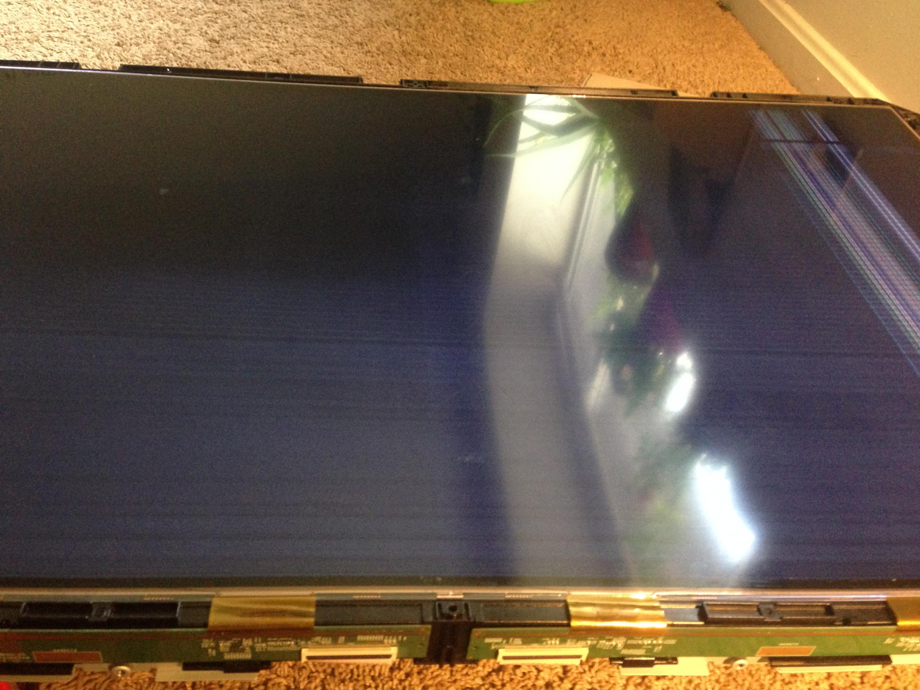

              Ok. I got a new T-CON board, and display is still worse. As Shinju suggested, I tried disconnecting Right side of T-CON leaving Left side intact with panel.
              Half screen display was perfectly fine, when disconnecting left side of T-CON and connection RIGHT side to Panel, There is no image All I got is only vertical lines and display fades off.
              I tried tapping the TABS and noticed nothing. I suspect that right side panel LCD driver board is at fault and wondering if there is any remedy to it.
              Please take a look at the pictures and suggest
