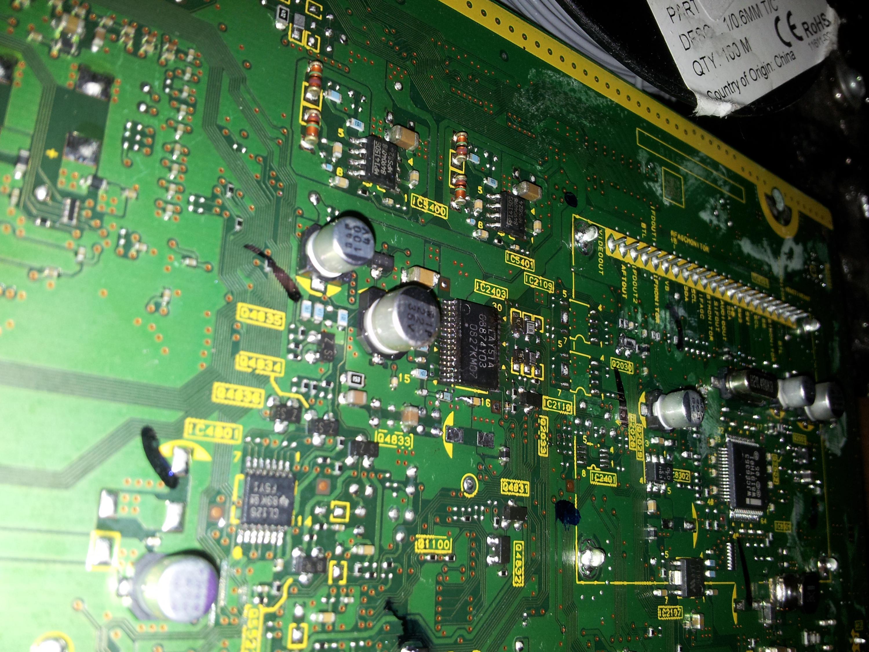

    Got another PZ80...actually two. This PZ8BA for £35 on eBay I'm working on now, and a 10 blink PZ85 (which is already fixed, common fault) for £50. Nice to score two at once...
    This one is different to my previous PZ80 which had same symptom: that one had no 5VSTBY, due to AC DET fault on PSU. This one does have 5VSTBY so it points to A board.
    Going to look into the A board now...
    Re: Panasonic TH-42PZ8BA completely dead (no standby LED), 5VSTBY present)

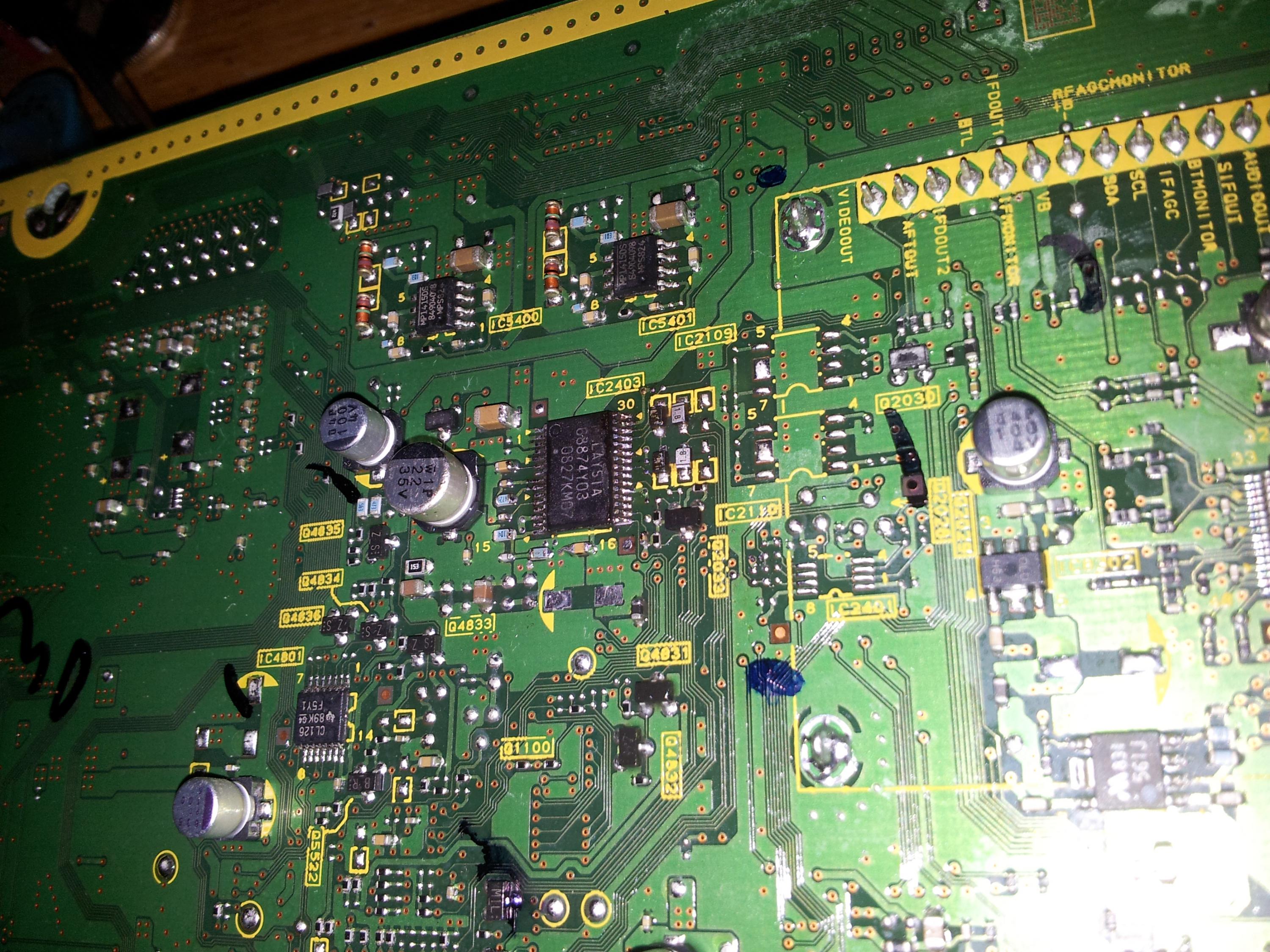

    Hmm, STB3.3V is dead (47mV), STB5V is present on A board...
    15kohm to ground so not shorted. Generated on A board.
    I am thinking IC2403 (C1AB00002877) is bad, as that appears to be STB3.3V source... hope I can source it. Looks easy enough to replace.

            Tried feeding in 3.3V, no joy, board just sucked up 700mA and no power light, so guessing that the ASIC does a few other things too and it's bad.
            Will try swapping A boards over soon.
              Bingo, unplugged A board completely, click-click, primed screen followed by white. Panel looks good, as expected no burn in. Will try swapping A boards next.
                Swapped A boards over and it fired into life with a perfect picture.
                So need to fix this A board, hmm...
                  If anyone knows of or has a good source of 68874Y03 please let me know (IC2403)
                  Can find one from Italy for £12 but that will take over a month given how Italian post works.

                                  Managed to get another chip, from an incompatible board... (TH-42PZ800B) which I promptly swapped over.
                                  STILL DEAD! 3.3V is dead. Checked soldering... all looks good (did it again to be sure)

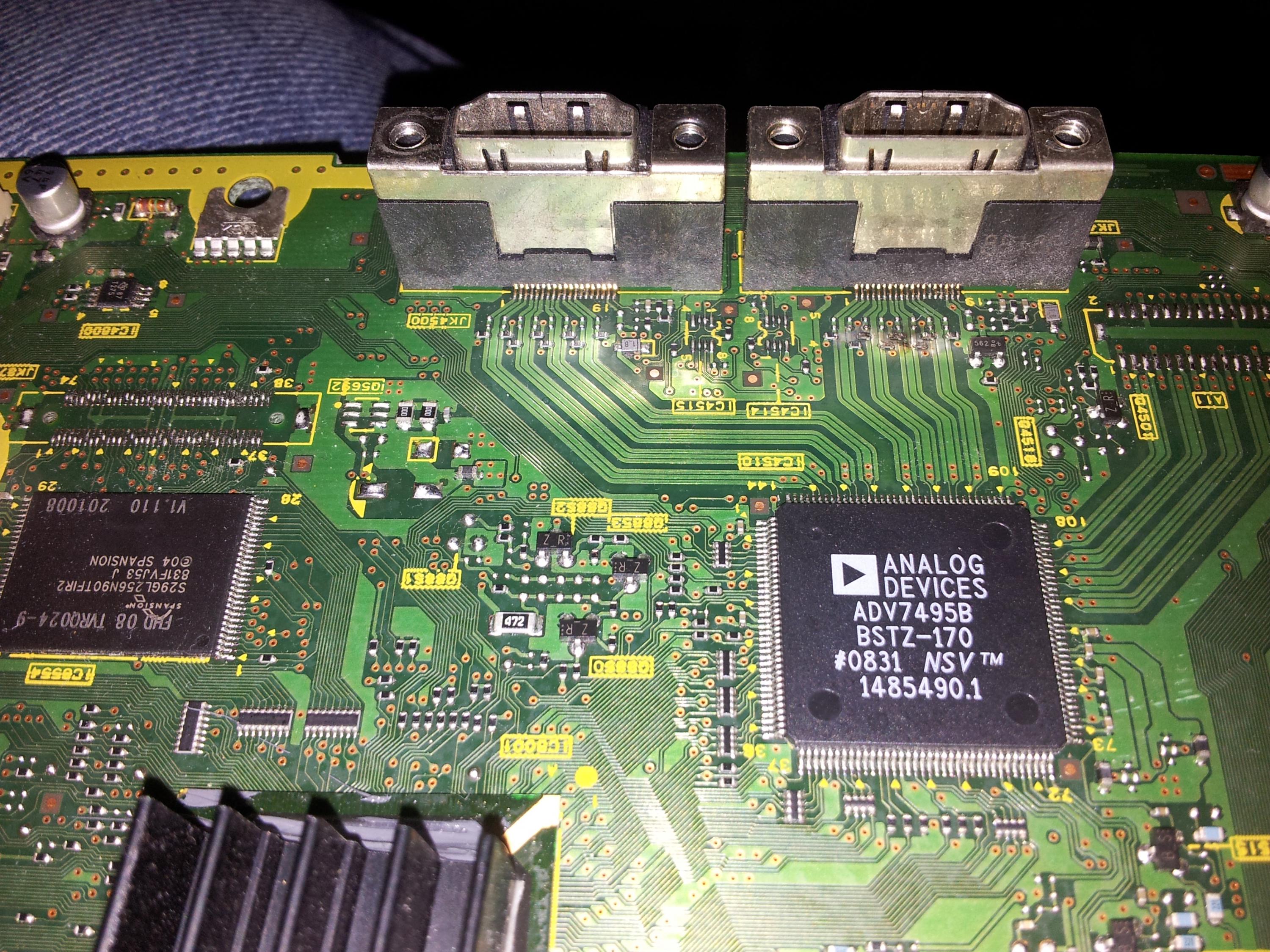

                                  Then I noticed burn damage around one of the HDMI ports. I figure this is power surge damage. I've found a pricey board on eBay (£45) but have ordered it... it's got an additional VGA port but I should be able to make it work.
                                  I figure this TV has been a victim of a power surge through HDMI, maybe the Analog Devices HDMI part is damaged, and that has an active short - perhaps loading the 3.3V down too much. Even if I could get this set working, there's almost no chance the HDMI port(s) would work. Hence why I need a new board.

                                    Perhaps the burnt protection components are causing a short. At least remove them, clean the area and see what happens?
                                    -David VanHorn
                                      Not shown in the photo, but the HDMI IC also has a burn hole in it... and they are only termination capacitors/resistors not protection components unfortunately.
                                        nasty, lightning comes to mind
