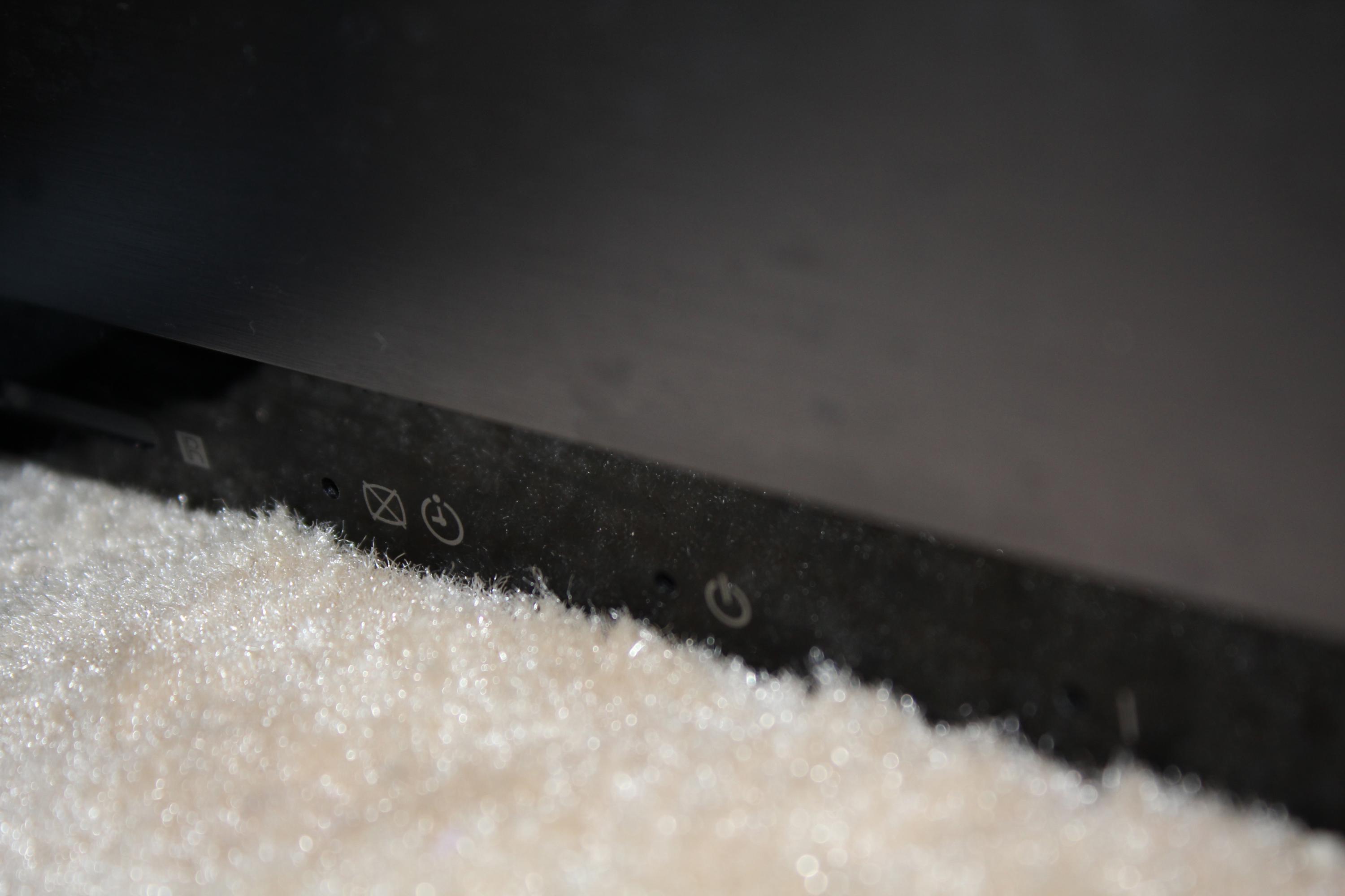

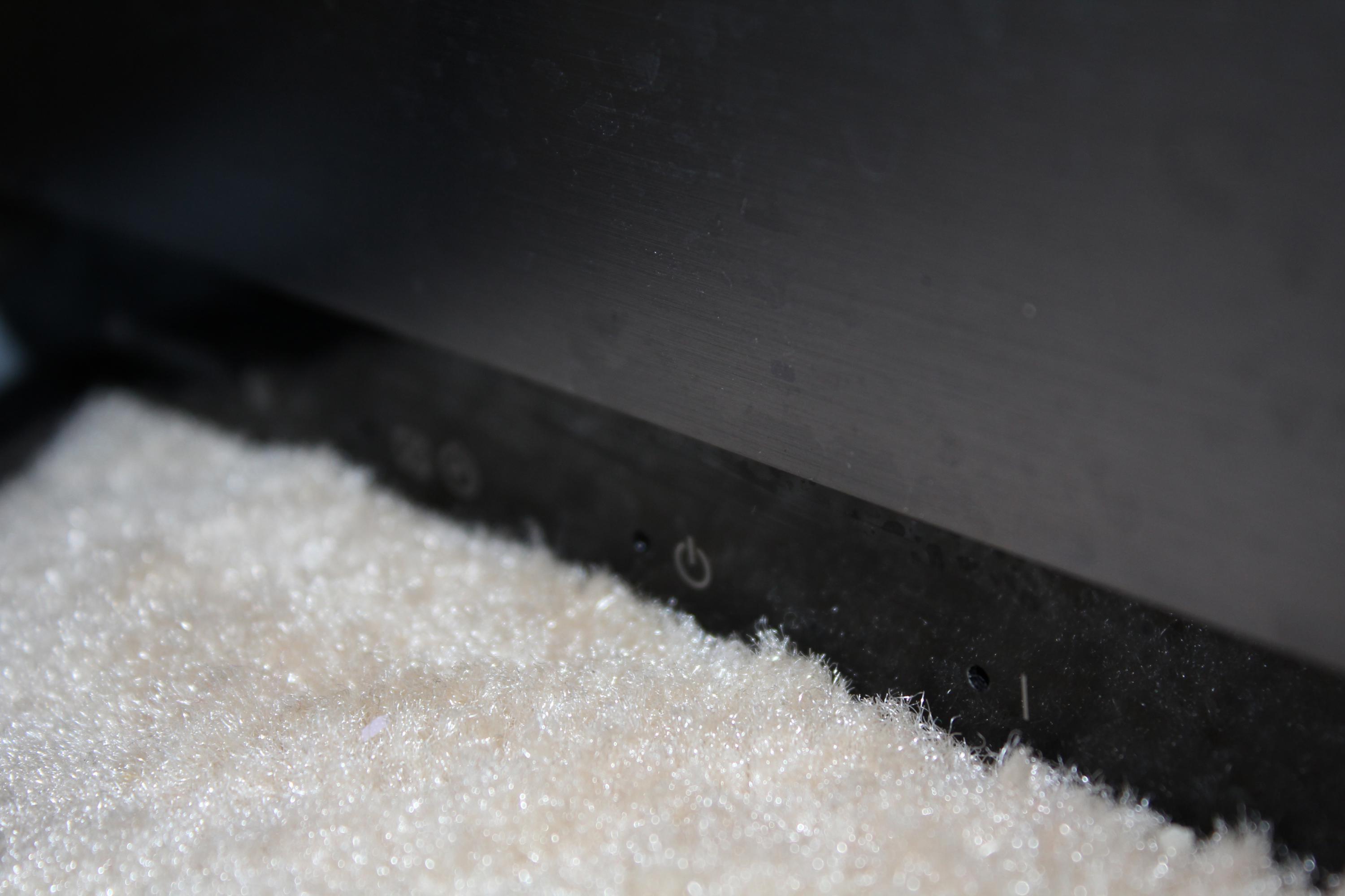

    Issue that I am having before this happen was that I had 3 blinks. From the service manual it said it is possible that the BAL board was defective. I replaced the BAL board and now I am having a constant amber (timer) and green lights (power on) blinking at the same time. I posted a video of this happening. I also have the updated firmware on a USB stick and put in the service USB slot on the BAL board, still the same result. Any help would be appreciated.
    Here's the webpage of the blinking amber and green lights.
