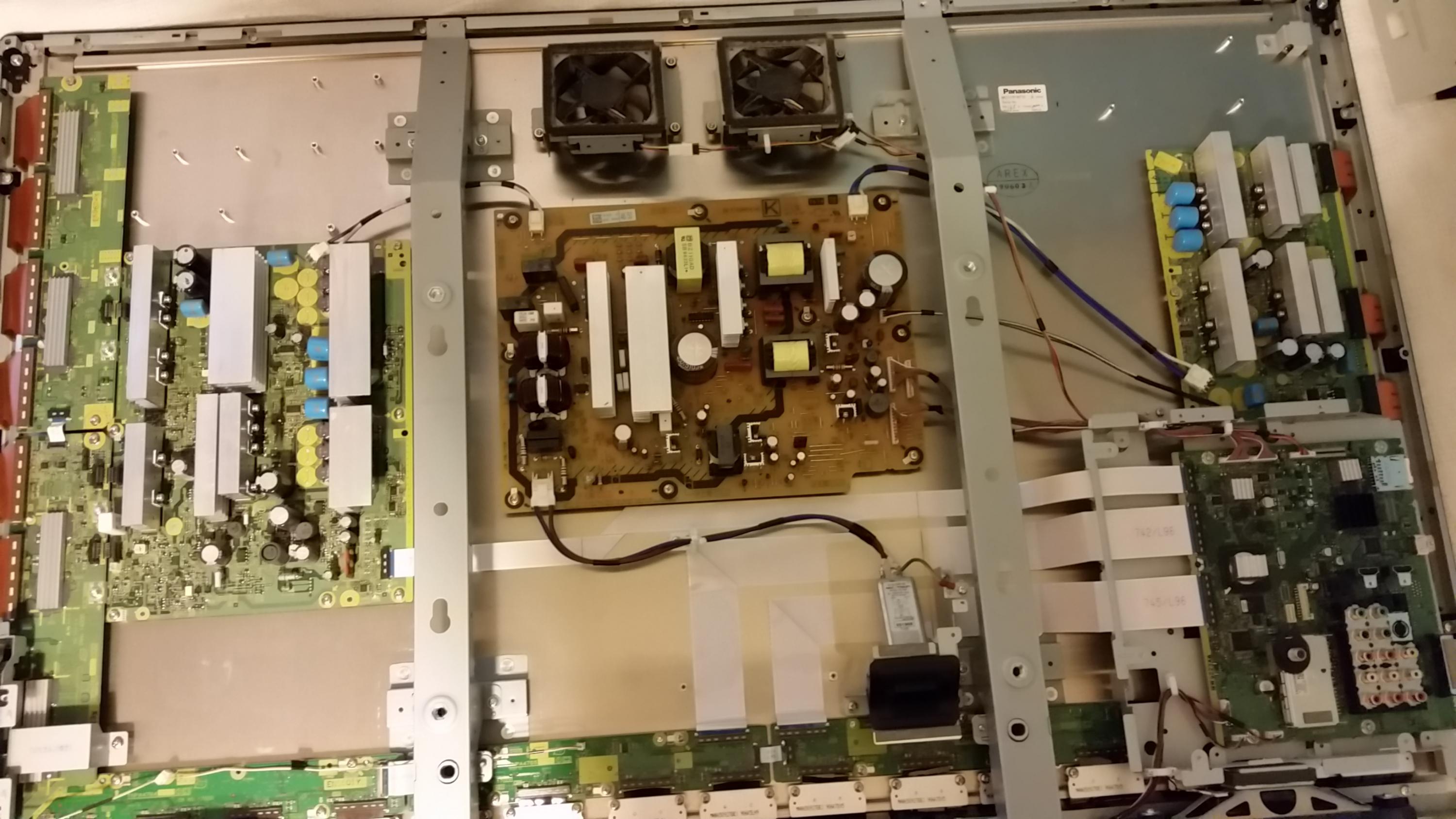

      I have the TV , and just opened the bonnet . Some pictures in A minute.
        Re: Panasonic TC-P46S1
        what one is the SC board ?
          I found it going to start de soldering now . I have the famous atlas DCA model DCA55 made by you blokes. lol
            Had to stop, I don't know how the connectors for the flat cables, disconnect.

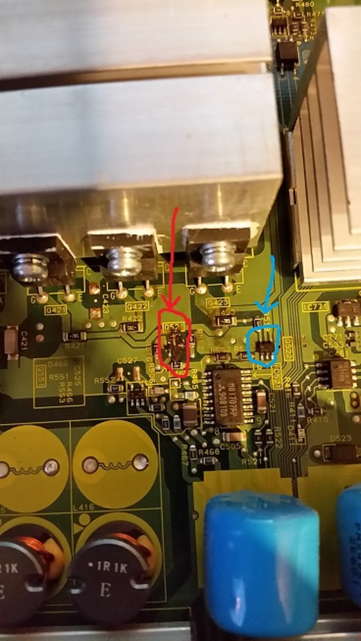

              Any one know if the burnt one in red is the same as the one in blue?

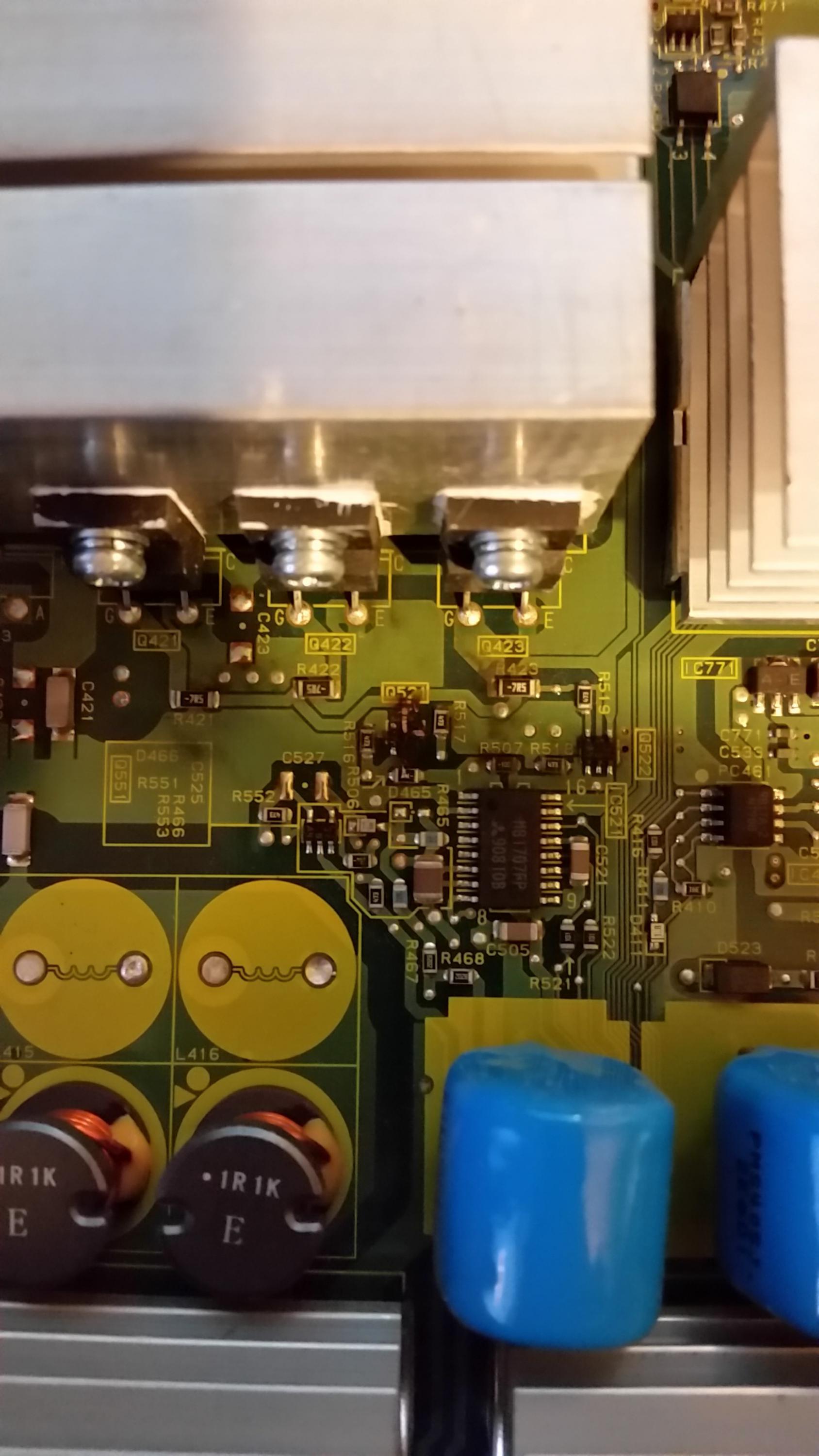

                better picture
                  Did some home work, they are the same... B1HFPFA00001 TRANSISTOR ... Hope this helps anyone with the same burnt spot.
                    Going to order a couple and try to solder back on board. The pads are just about hanging on. The IGBTs check out all right, no open or short. Just hope I get lucky for once.
                      Replacing that FET driver might be a good idea too. Unusual to have only 1 blown part and no shorted IGBTs.

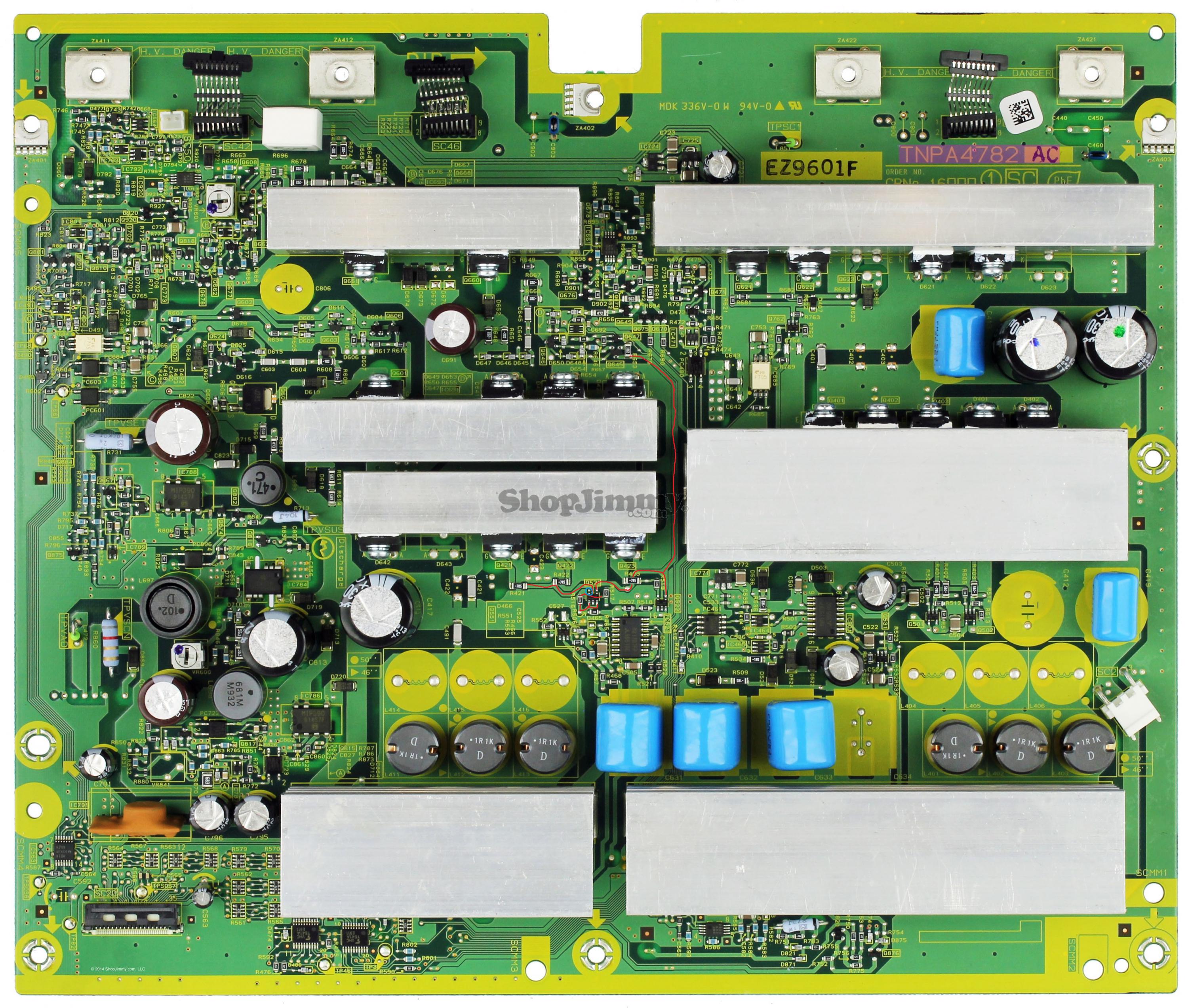

                        HOMBRE did manage to get his TBPA4782 going eventually
                        https://www.badcaps.net/forum/showth...light=tnpa4782
                            I bought a kit from Shop Jimmy and it is very big kit over 30 parts.
                            I changed all the fets the fet drivers some diodes .Etc .

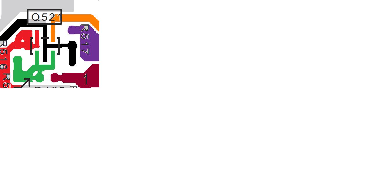

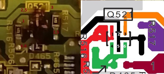

                              Here is where I think to solder the wires to.
                                see if this enlarged image helps to confirm the traces.
                                  Thank You tw that helped me out so much.
                                  I almost bridged r516 and r517 . Almost done with this beast.
                                  If Q521 wasn't blasted off the board I think it would have been just a re work job.
                                  Tomorrow I will solder Q521 in and turn her on.
                                  Thanks again

                                    How clean is the board? All that carbon conducts. How exactly are you going to mount the new transistor?
                                    Any info from the kit can you post up like part numbers/locations covered? Who's kit is this?
                                      I have been trying to solder thin wires to the transistor,
                                      but it is so small. Any ideas ? The board had a crater where it was once soldered.
                                      I can't do a trade in because the board is damaged. What now ?
                                        Shouldn't be too bad, I wouldn't be buying a new board at that point... I attached a picture where you need to wire everything (confirm yourself before doing it)
                                        Just use some very thing wire and scrape soldermask off from the places where you solder them.
                                        Make sure you clean all that carbon residue thoroughly off before doing anything
