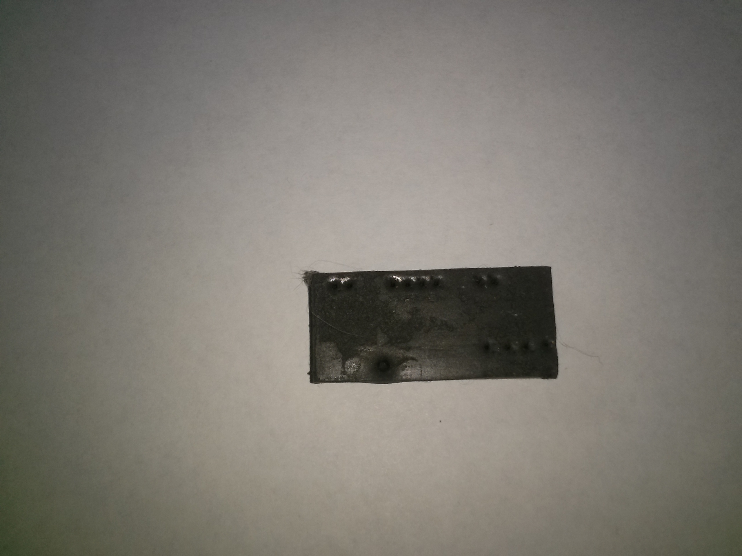

    Working on a Maxent MX-42HPM20 and had a thought that I think merits a separate thread.
    My thought process is as follows:
    My Plasma TV seems to have a bad ZSUS IPM (unconfirmed) and maybe a bad YSUS also (no reason to think this yet), and while doing research on these IPM's I get the impression that it's a common failure, and while there isn't much consensus on what causes these expensive IPM's to go bad, most people assume that it's heat, as they run hot, and there's this (11mm thick) thermal pad behind them. You'd think it was there for a reason. They get hot.
    When I pulled my ZSUS board off, there was an obvious trace of liquid emanating from the pad, and some of the material from the pad stuck to the IPM, and it was almost "glued" to the IPM. I interpret all of this as a breakdown of the thermal pad material. So, while doing research on replacing this pad, maybe with a larger and more effective pad (it's too small, IMO, 19mm x 41mm x 11mm (thick), and it could easily be twice that large, or even larger), I note that a lot of the thermal pads listed by Digi-Key contain the words "Aluminum Oxide" in the description, which seems appropriate because my bad is unusually heavy, dark grey and it might have some aluminum oxide in it, and then I had the idea.
    The idea is that, what if these pads work okay when they are new, and are not conductive, or capacitive, or whatever, but after (in my case) 7+ years the material breaks down (seeping liquid, glues itself to the pc board and material rips away when pad is removed), the electrical characteristics of these pads change and THAT is what is killing-off these IPM's. I've read at least one anecdote that the ZSUS IPM fails after replacement, and that would make sense if it is the pad that is killing them off.
    The idea of forcing the pins of a (small) mass of electrical components into a solid material made out of aluminum oxide seems highly counter-intuitive to me. You wouldn't mash a flat piece of metal into the back-side of a pc board; so why would you assume a spongy material filled with aluminum oxide is not going to short, or allow some conduction, or act as a capacitor, or whatever. Cause problems, is what I mean here.
    Those are my thoughts. I'd be interested in whether or not I might be on to something, or (due to lack of knowledge) I'm missing something.

    Also (I'm giving this a separate post because it's crazy), I noticed that the back of this ZSUS pc board had a film of hard, crusty dried liquid on it. I assumed it's some kind of flux material, or maybe some kind of corrosion-inhibitor.
    So, WHAT IF the pad is fine, and it's not degrading due to heat, but instead it's degrading and chemically reacting with this brown stuff? At the factory. So in some lab somewhere, the brown stuff doesn't harm anything, the pad doesn't harm anything, but after they are assembled maybe the two do some kind of chemical reaction that turns a non-conductive pad into something that 1) bonds to the pc board 2) creates a liquid that seeps out 3) changes the electrical characteristics of the thermal pad that 4) kills-off ZSUS IPM's?
    Whazzup? Huh? Do I get a parade? Or a Federal Investigation?
    (cause this is my grand conspiracy theory, & I'm either a hero or a nutjob)

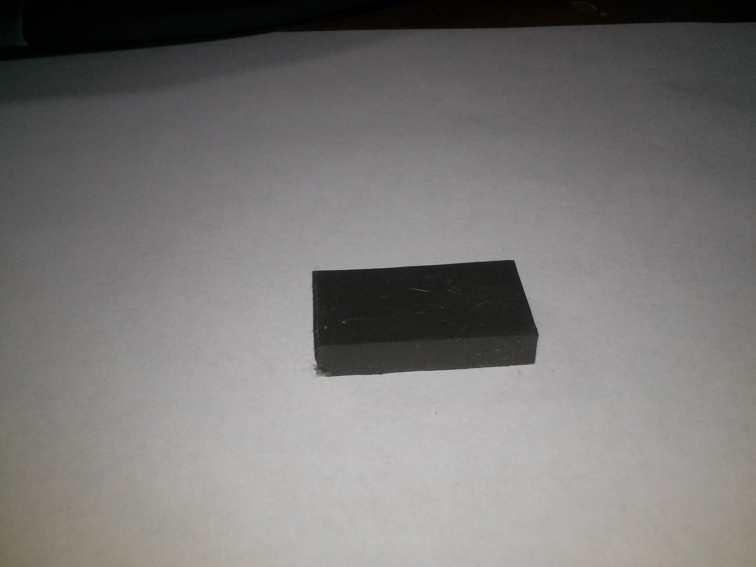

            Re: Thermal Pads and Bad IPM's: What if it's NOT Heat?
            Originally posted by SteveNielsen
            How about some pictures?
            Here is the pad (front and back). I have to figure out how to get attachments in one post so show up in another.
            Here's the thread/post that shows the ZSUS board with the leaking liquid and the scrap of remaining material stuck to the back of the pc board.
              The stuff that comes off the dead-toad pad is only silicone oil, so nothing to make issue over.
              The flux coating left on the board doesn't cause the trouble either.....
              Blame the Greenies and their Damnable RoHS Directive!
                Why do you call it a "dead toad pad"?
                I did a Google search and you are the only person on the entire planet that puts those 3 words together in that order. The only other hit besides this thread, is a post you did here:
                I think this is what causes the odd failure--not of the actual chip, but of that rotten lead-free solder holding it on.
                They basically suffer metal-fatigue on the solder-balls and connections break between the chip and the board.
                --Some makers make the situation worse--by trying to cool the chip from the other side of the board, using a dead-toad pad to the chassis.
                Which is exactly what's happening here, and you say the pad makes it "worse", where in my original thread, someone else says the IPM would burn up immediately without that pad. So which is it? Worse, or necessary?
                Since you know so much about pads, etc.., do you know a source for larger pads? Isn't it safe to assume that bigger is better in this application?
                        Those pads can only transfer a minute amount of heat. The bulk of heat transfer is done through the soldered connection of the IPM to the board. That's why they're such a bitch to remove.
                            Dead-Toad....
                            Cold, Clammy--Just like those silicone pads......Summit Ive always called 'em.
                            I said-- IN SOME CASES--Where a chip is mounted On Top Of The board--like a large processor, and the toad is Under the board between the chassis metal and the board--The Unequal Expansion is greater due to the toad removing heat from underneath the board, the chip itself still getting quite hot, Ive measured 55 degrees on the top of a processor chip before now, and the chassis still cool at 18 degrees.
                            IF the chip is cooled by adding a heatsink to its Upper face, the problem is reduced--Note, Reduced, not cured, as you're taking the heat from the chip--not the board via the soldered pads etc. Failure of the through-hole soldering --like IPM--isnt such a problem as it is for the soldering of those processor-chips using solder-ball technology
                            For IPM its the Die Chips soldering to the substrate that fails, causes local overheating--as the thermal bond is less-- of the IGBT that eventually dies or the electrical connection between the chip die and the substrate fails. Result is the same--IPM goes tits up.
                            Must be remembered--This Usually happens at the 15000 to 20000 hours point, as thats when they seem to last to. Thats a Huge amount of time--For a Consumer Electronics item.
                            Makers know that Toad is cheap, heatsinks are expensive--relatively. They don't care if the set fails 2 years or more down the road, and tell you to go buy a new one, hence the poor service-info availability for many parts of a Plasma chassis.
                            I disagree with the above statement--'Those pads can only transfer a minute amount of heat. The bulk of heat transfer is done through the soldered connection of the IPM to the board. That's why they're such a bitch to remove.'
                            Yes--IPM sinks to the board, the toad then heatsinks from board to the chassis....
                            Ask yourself why the toad is Always stone cold to the touch. Its conducting the heat outta your finger!
                            --Try an experiment. Put some toad onto ice-cube, touch it and see for yourself!
