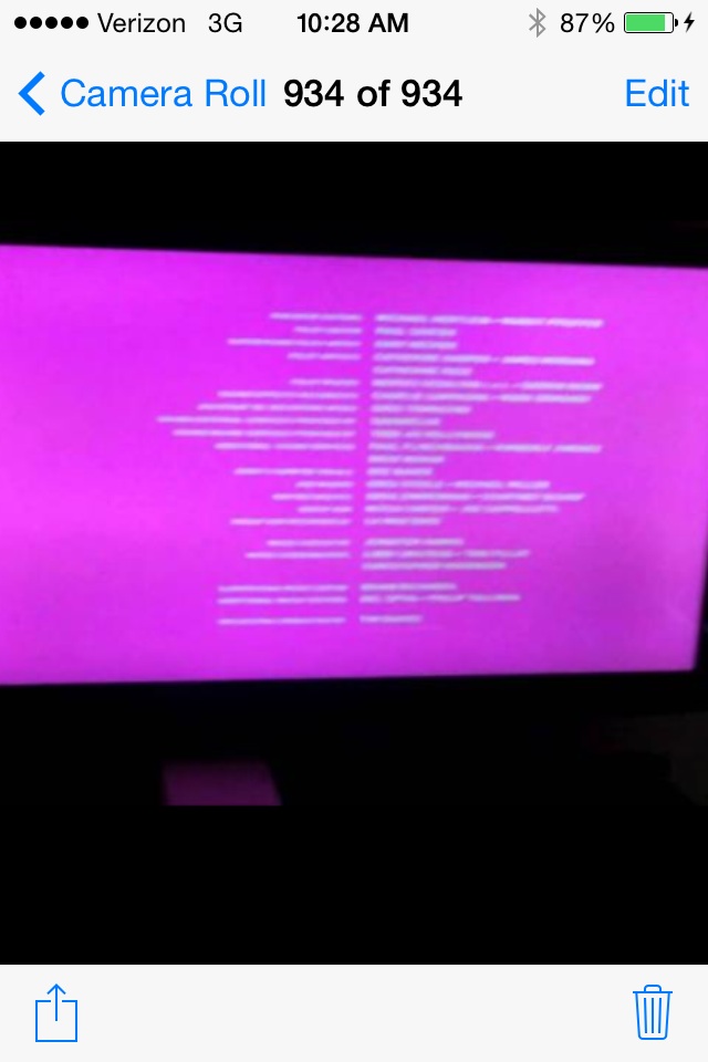

LG plasma 60PA6500-UA purple tint, entire screen, at startup
  • Poor Flick
    Of sound mind
    • Jun 2014
    • 3167
    • U.S.S.A. The flophouse of the world.
    What would cause a purple tint on the entire panel when turning on? When it would happen (not often) the tv would be cooled down as in overnight. All of the image would be there, but everything was in shades of pink/purple. Turning off and re starting after about 5 minutes, it would be fine. THANKS!

              Re: LG plasma 60PA6500-UA purple tint, entire screen, at startup
              Could you supply a photo of the problem?
                Sorry Tom, I should have included that at the very beginning.

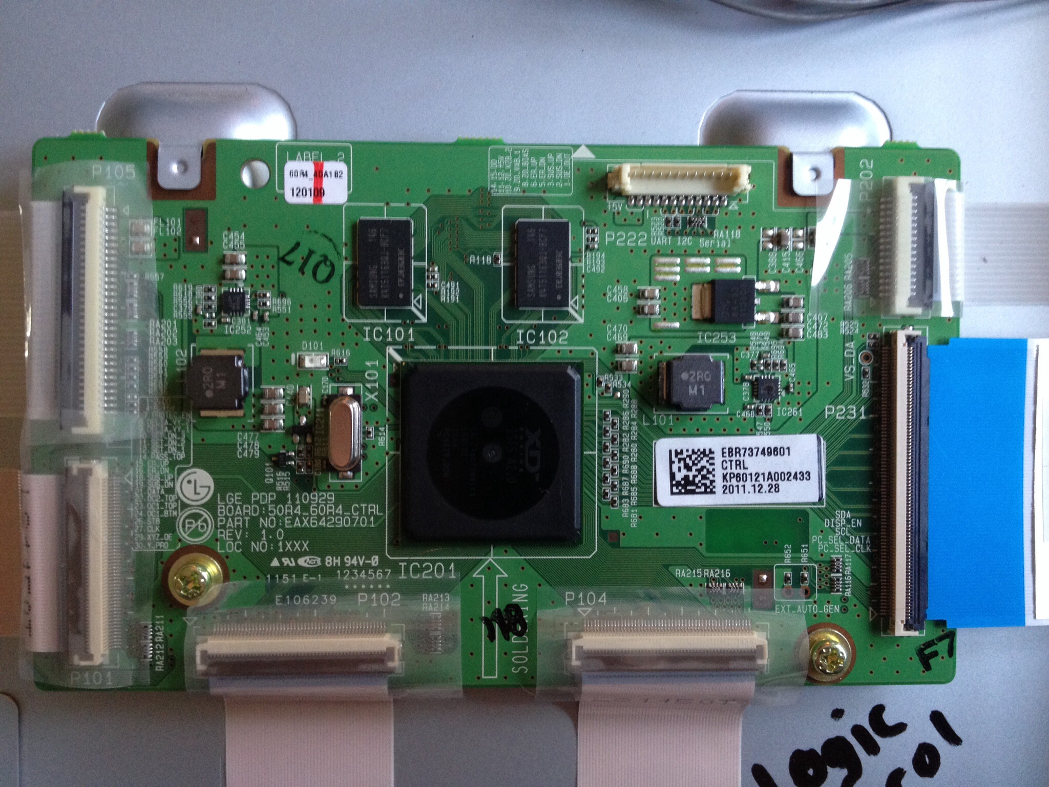

                  Interesting.... Not a Z-sustain fault, that's for sure.
                  Can you post a picture of the control board? It's the one in the centre of the TV, green in colour, connects to a lot of other parts...
                    Dodgy LVDS cable/plug/socket possibly.....?
                      I think this is it, is the LVDS cable the silver one? The terminals and plug pins looked clean. I didn't think to check if they were seated completely before removing for inspecting earlier. All ribbon connectors were removed and inspected without checking to be fully inserted first. I still have my training wheels on! If I need to generate the test pattern, I'll have to get back with you guys a bit later, I'll be away from home for a while. I had these pictures on my phone. Thank you guys!
                        The LVDS will be the cable that goes from the Mainboard,--one that has all the input sockets on etc, and that control-board....
                        Carefully remove the cable, wipe over the contact area of the cable with some contact-cleaner/WD/40 on tissue then refit--Do Both ends.....
                          Ok Alastair, I'll actually go back over all the ribbons as I think the WD-40 would be a good idea to prevent corrosion. Would it be a good idea to spray it into the ribbon sockets on the boards also? I can hold some paper towels around the plugs to avoid other areas.
                            No, no need to fill the sockets with the stuff--just a little on some tissue, wipe over is fine....
