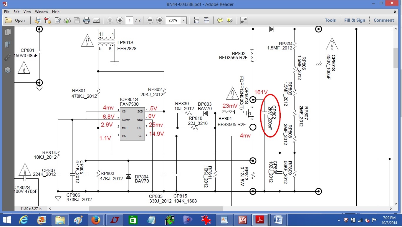

    How is this circuit supposed to work? Obviously 23mv won't turn on the MOSFET but what happens when the MOSFET turns on? Looks like it will force positive voltage onto the ground? You can see I don't understand how an SMPS works.
    So you still think the IC is the problem? I ordered some but likely won't see them for a week or so, coming from Hong Kong.

        Re: bn44-00338b
        Hi Bud,
        I hope you are still monitoring this thread. My replacement IC finally arrived so I installed it. That wasn't the problem. I still have exactly the same voltages I show in post #17. For some reason the IC is not turning on. I have read through the docs for the IC and though I understand it a little better, I'm not sure what to look for as to why it is not turning on. Any other things you can suggest to look for?
        Thanks, Terry

            Re: bn44-00338b
            Exactly the same, everywhere. I bought more than one IC so I even swapped in a second one. No change. The docs say the IC compares the inverted and the non-inverted inputs. I'll assume the inverted in the INV pin but I don't know which pin is the non-inverted. Something is not sending the correct voltage or current to make the IC happy. Have you had the chance to mark down the correct voltages for each pin on the IC? That would be very helpful.

              Re: bn44-00338b
              I'm attaching another partial of the schematic with the voltages to hopefully give a better picture of what's going on.
              Thanks, Terry

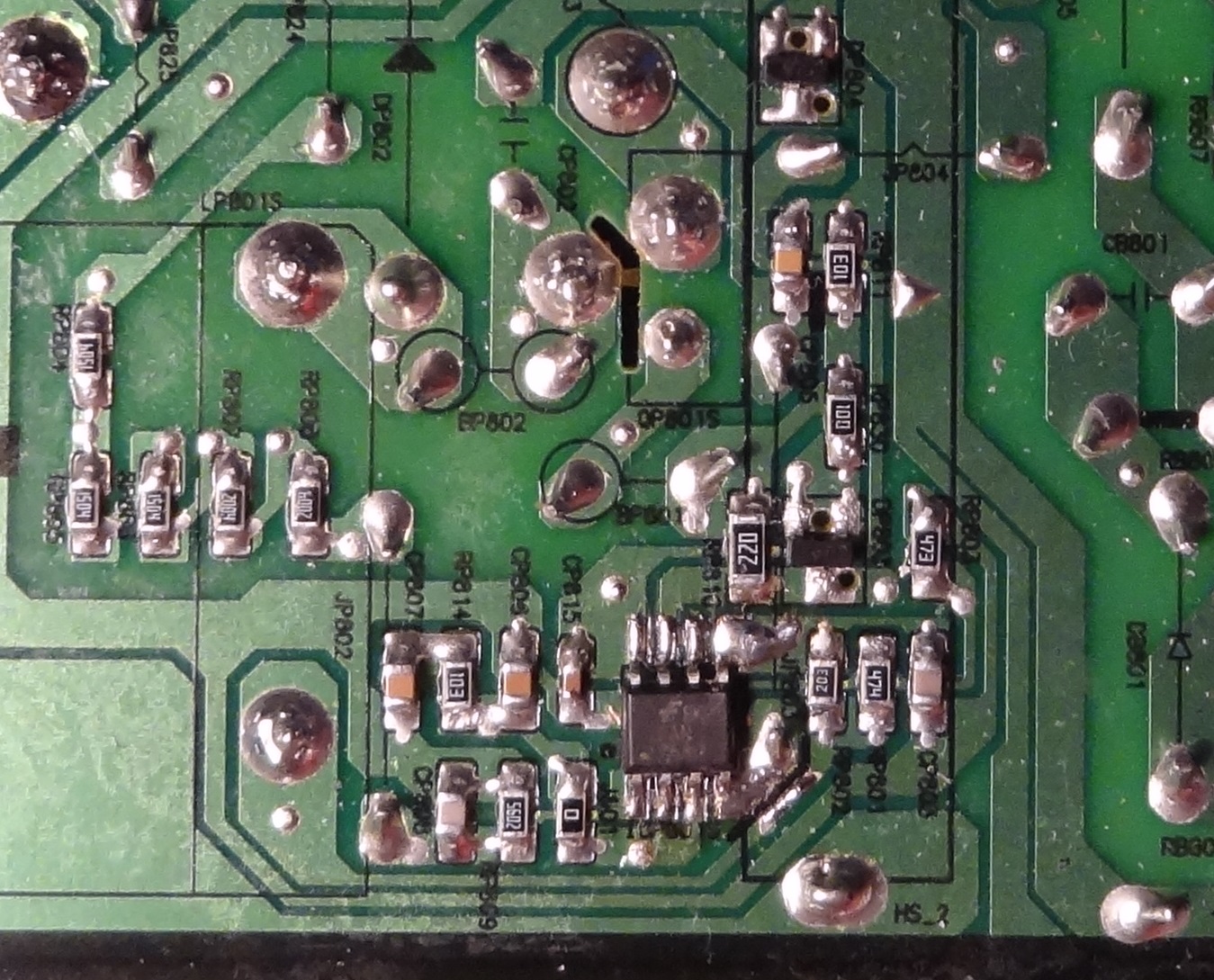

                Can I see the bottom side of the board around the MOSFET and the IC you replaced?
                DP803 Diode (Gate discharge diode) is connected in parallel with low Ohms resistor so it will show conduction on both directions.
                Something is locking out the IC from generating the output signal to drive the MOSFET.

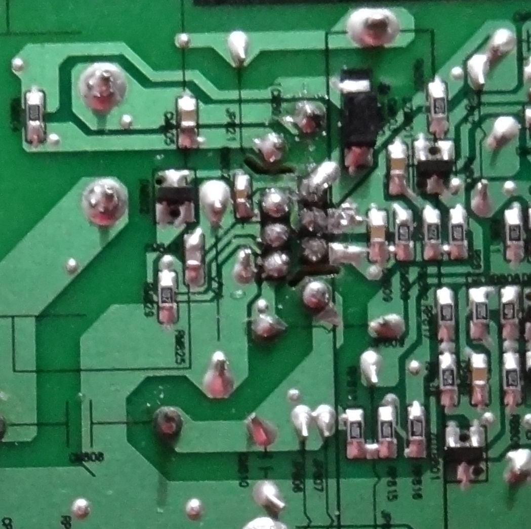

                  Re: bn44-00338b
                  Here you go.
                  Edit; adding a shot of the bottom where I replaced the FSR

                              Hola, el problema que tienes esta en la linea que sale desde el diodo DP802, atraviesa BP803 y BP804 y continua por RP813, RP814,RP815,RP816, RP817,RP818 y RP819.
                              Mide estas resistencias, lo mas probable es que una de ellas esta abierta.
                              Cualquier variación fuerte de voltaje en la linea de entrada ( 120vca) provocara en daño del circuito o el daño de estos componentes.
                              Apagada la fuente o en standby , debes tener 180vcd aproximadamente 180VCD en BP803, con la fuente trabajando al 100% debes tener 380 - 400vcd

                                See notes en datasheet in page 3:
                                The OVP comparator shuts
                                down the output drive block when the voltage of the INV pin
                                is higher than 2.675V and there is 0.175V hysteresis. The
                                disable comparator disables the operation of the FAN7530
                                when the voltage of the inverting input is lower than 0.45V
                                and there is 100mV hysteresis

                                  Re: bn44-00338b
                                  Originally posted by Alastair E
                                  Tried a new MOSFET...?
                                  No, I have not tried that. Do the voltages indicate it is faulty?
                                  I don't quite follow you. INV pin is 1.1V which is higher than 0.45V and lower than 2.675V. I don't understand the term hysteresis nor how to check for that.
