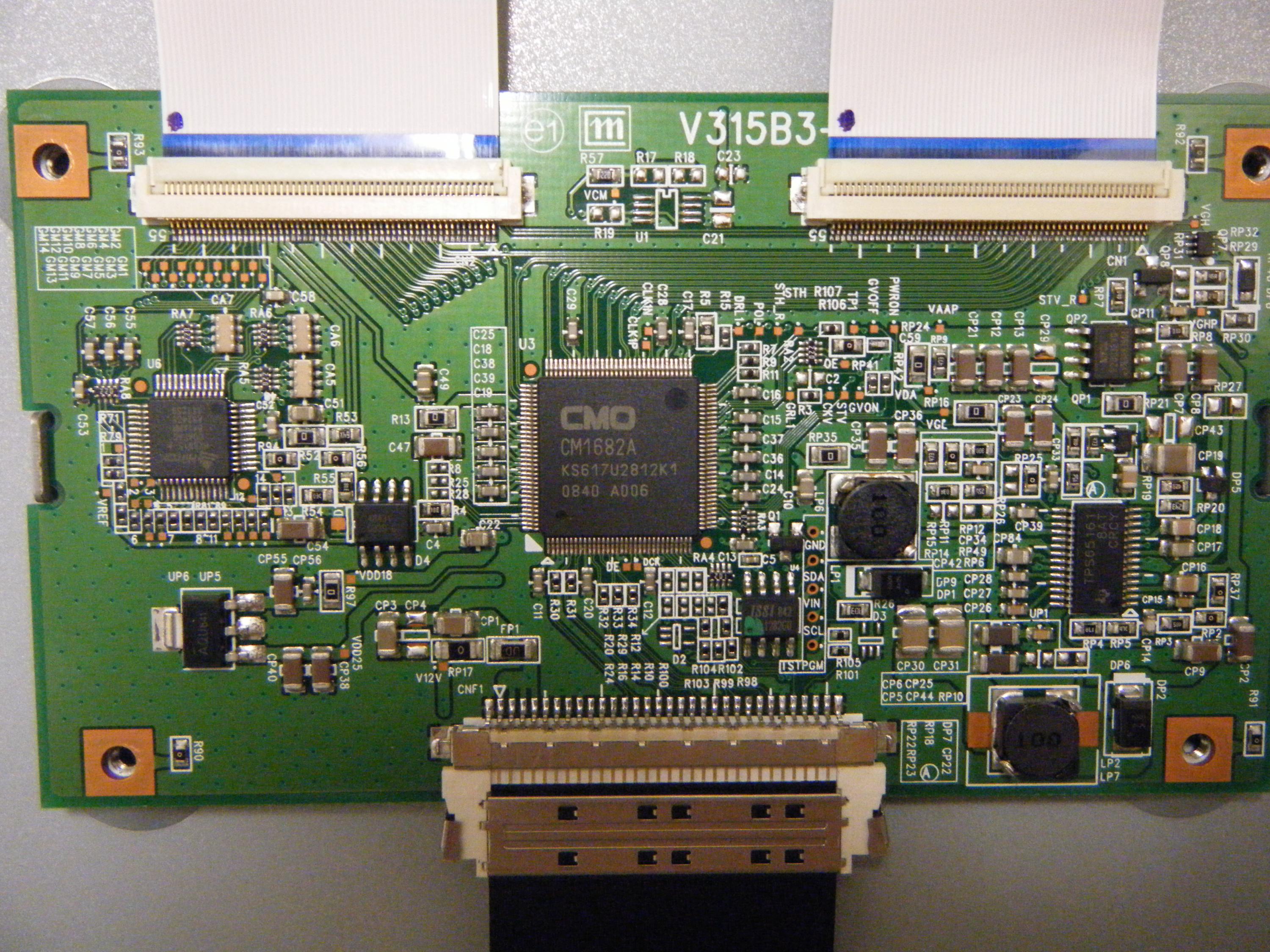

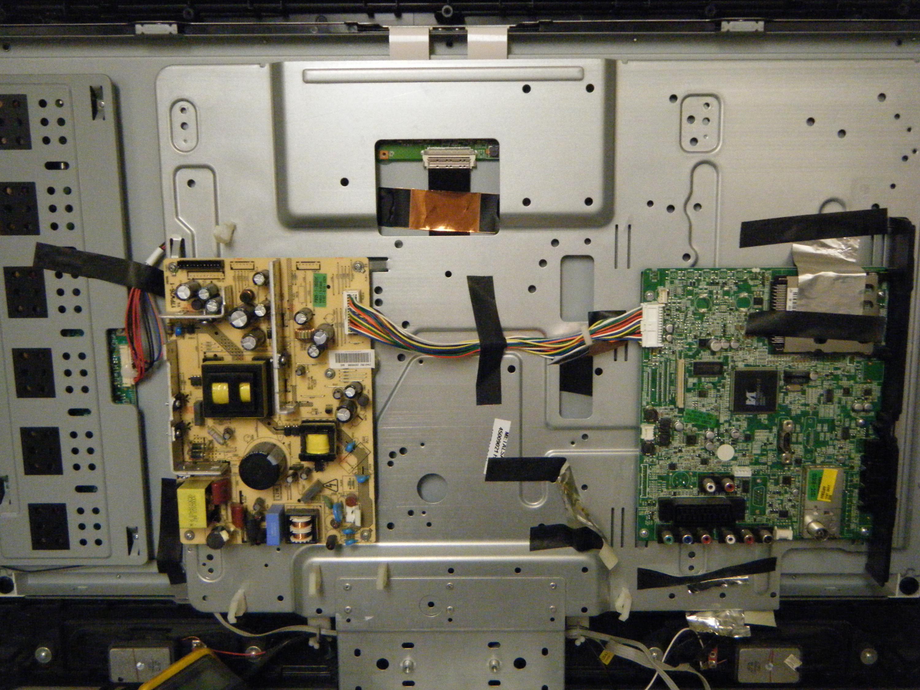

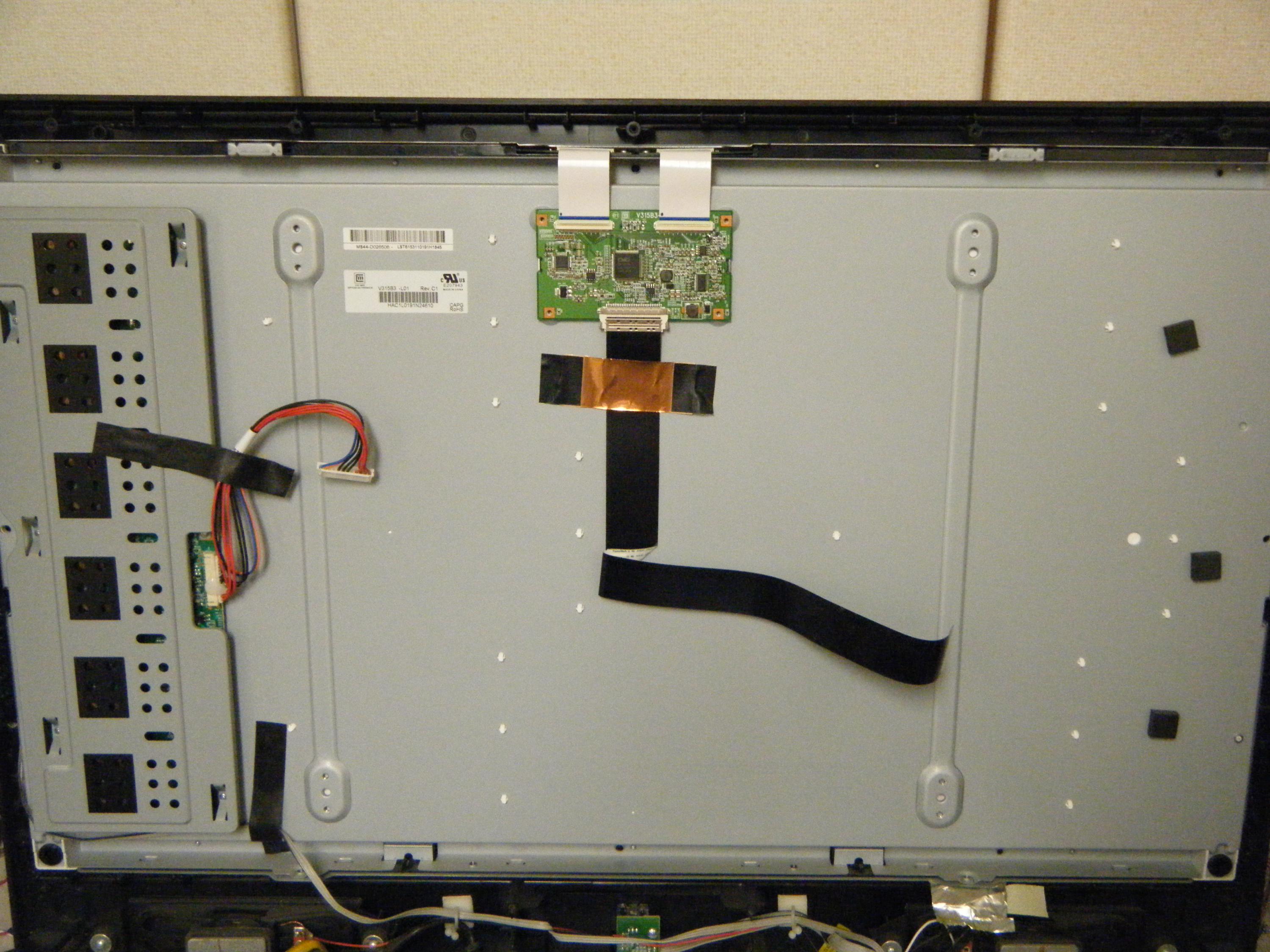

Matsui M32LW409 no picture but sound
  • Andyd1970
    replied
    Re: Matsui M32LW409 no picture but sound
    Hi Tom,
    See pictures, the TCON was behind a large metal frame that has the PSU and AV board.
    Leave a comment:
    replied
    Re: Matsui M32LW409 no picture but sound
    How about some pictures of the boards and chassis layout?
    Leave a comment:
  • Andyd1970
    replied
    Re: Matsui M32LW409 no picture but sound
    Hi had thought that but could not see anything obvious that was like a surface mounted fuse, I have noticed a components called FP1. Is that the fuse?
    Leave a comment:
    replied
    Re: Matsui M32LW409 no picture but sound
    Checked the T-con fuse?
    Leave a comment:
  • Andyd1970
    started a topic Matsui M32LW409 no picture but sound
    Matsui M32LW409 no picture but sound
    Hi Guys,
    I have just taken in a Matsui M32LW409, that has sound but no picture, I have switched it on in the dark and you can see the screen being illuminated.
    Any thoughts please
  • TR103
    by TR103
    - it keeps rebooting
    01-22-2025, 04:12 PM
  • Mgiffune
    by Mgiffune
    06-09-2024, 10:28 AM
  • Ierwin
    by Ierwin
    05-13-2025, 03:31 PM
  • jchang
    Samsung UN70NU6900F no picture and no sound
    by jchang
    Hi all
    I was just given a Samsung TV with the issue. I read various threads and videos and attempted the ribbon tape method to gain an image, but no luck.
    Symptom:
    No picture no sound.
    When I plug in the power cord, Backlight LED turns on for a half second and then turns off. The red LED next to the power button located center bottom flashes 2 or 3 times. When the power button is pressed after, it does the same thing.
    No sound at all.
    What I tried:
    1. I tried unplugging the left or right ribbon...
    01-09-2023, 06:28 PM
  • ChaosLegionnaire
    what i went through dealing with my mobo with dead onboard sound!
    by ChaosLegionnaire
    so i took out one of my spare gigabyte ep35-ds3r mobos from storage for use to do some cpu, ram and video card testing of stuff i bought from ebay and got for free from momaka. he bought 50 e8400 cpus for cheap from ebay some years ago and i decided to help him relieve him of some of his supply since he had waaaay too many!! what did we say about hoarding too much stuff and depriving others of them?! *cough* socialism *cough* lol!
    i had to blow some dust off the board and heatsinks with the datavac as i didnt clean it up before putting it in storage. after finishing...
    09-13-2022, 09:02 AM
