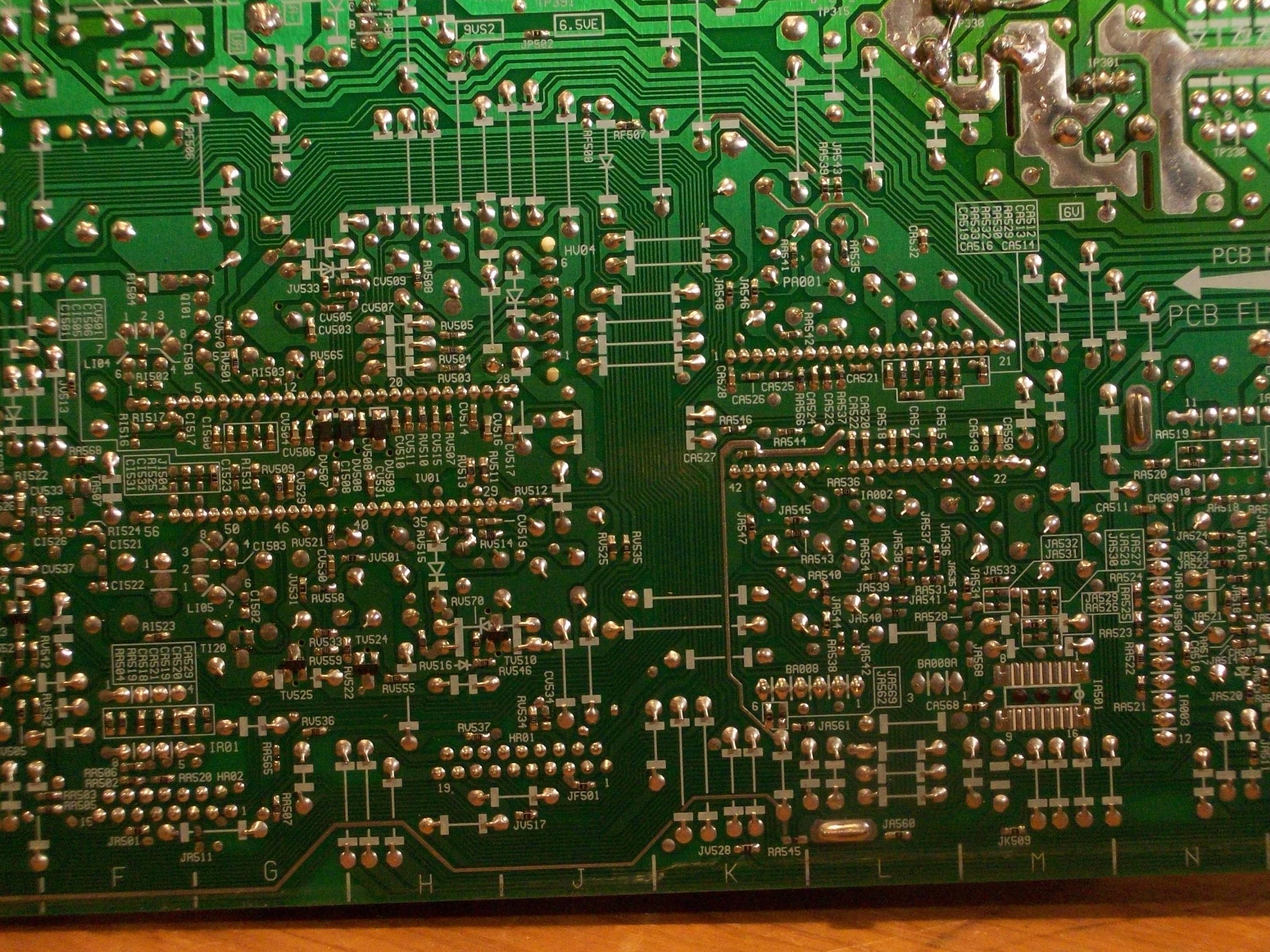

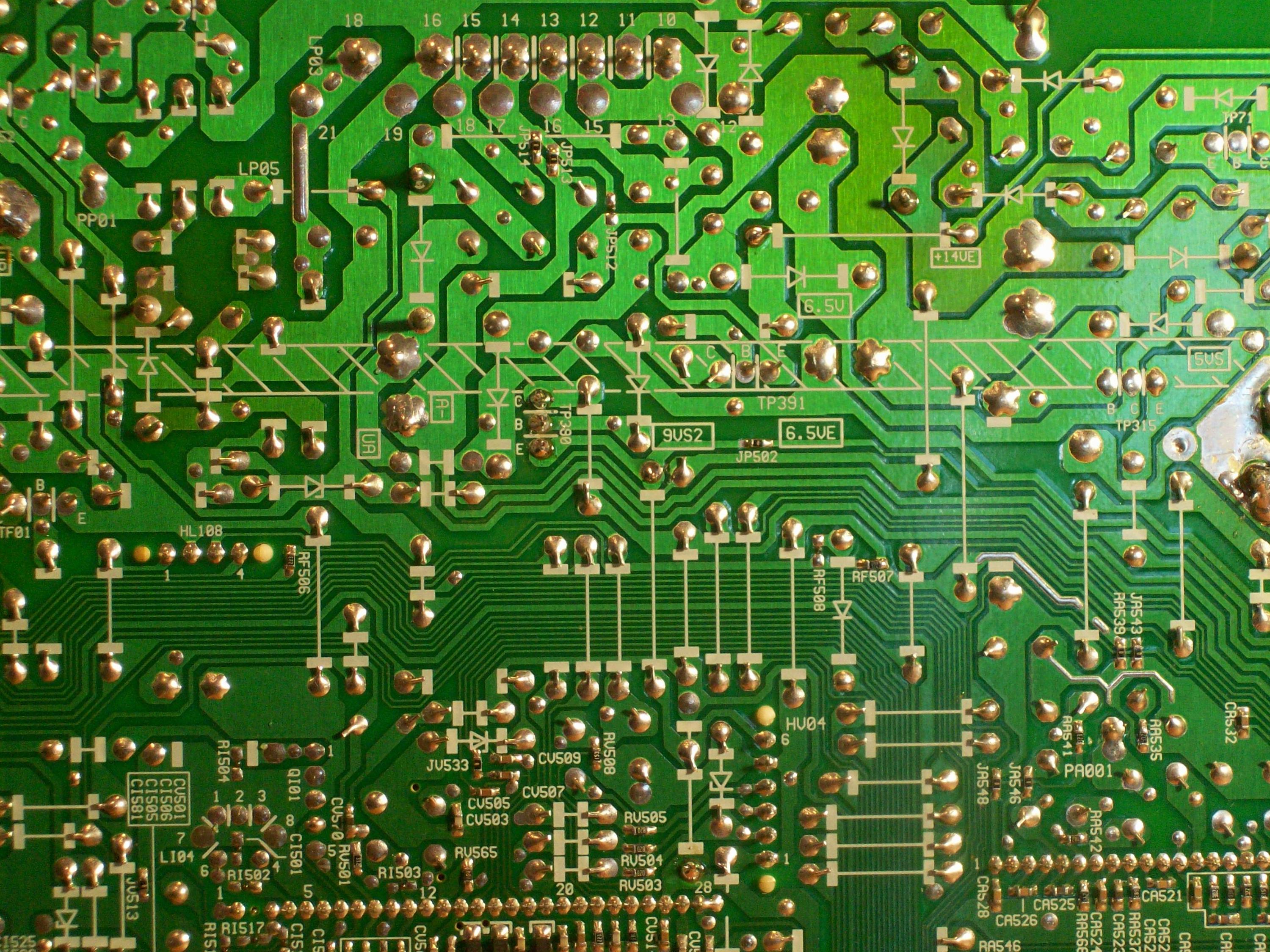

      Re: RCA (Thomson) F20TF10 in a coma
      Sorry for the delay. Here are some pics of that area that are clearer I think.
        I study photos. IP301 now is voltage on pins ?

          #104
          Yes, IP301 still has proper voltages; 9.2v on pin 1 and 5.9v on pin 3.
          I've got some of the circuit traced out from pin 26 on the video chip but not completely. So far it goes nowhere near the flyback.
              Need actual voltage IP330, TP390 and TP391
              • SteveNielsen
                Retired Tech
                • Jun 2012
                • 2327
                #107
                Andrew, the cap isn't bulging, it's the lighting and shadows. It's labeled CV28 on the other side of the cap.
                Kasfamily, here are the voltages:
                IP330
                Pin 1 = 10.4v
                Pin 2 = 0v
                Pin 3 = 8.6v
                TP390
                E = 0v
                B = .5v
                C = 8.7v
                TP391
                E = -.01v
                B = .67v
                C = .03v
                When measuring TP390 I accidentally shorted B to C which turned on HV to CRT anode.
                  TP390 has already been tested ok out of circuit.
                  I just pulled TP931 and it tests ok as well.
                  My accidental short of B-C on TP390 turning on HV tells me something is not turning that transistor on.
                  Wish I had a schematic for this board.
                    OK!TP391 controls the supply of 9 volts on pin 26 TA1268 through TP390. Enable signal is applied to the base TP391(may be to press POWER button). If not, need photo area board from N to R and 0 to Z, with two sides. What would follow the chain of signal control base TP391

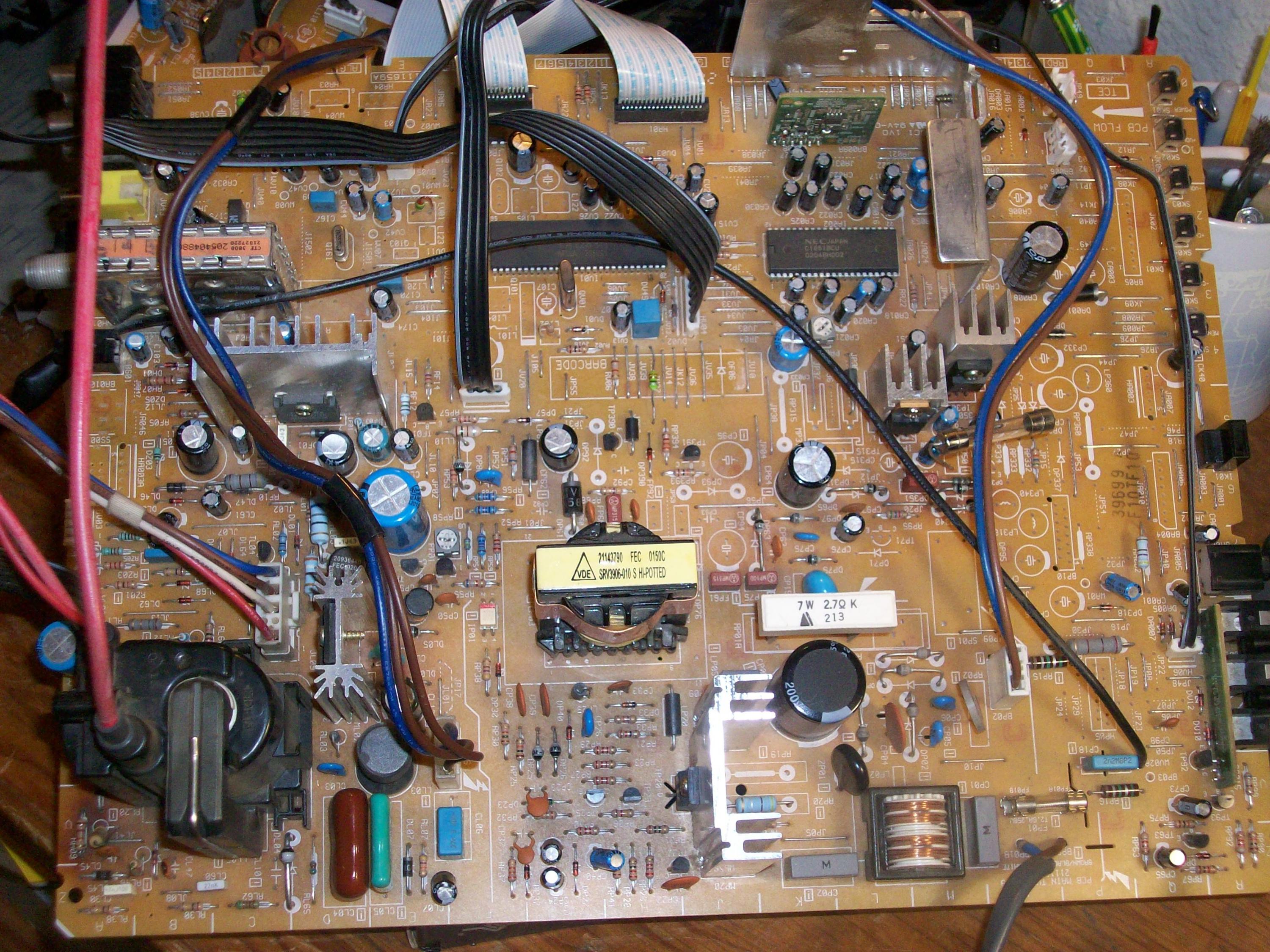

                          #112
                          Very good headway! Maybe will take a photo of the screen, but I not clear get all.

                                #115
                                It's connected ok. The white screen started after I nudged the blue elecrolytic next to the flyback transformer when the set was on. I've pulled the cap and it checks ok. I'm looking for bad solder joints, etc. in that area but see nothing out of the ordinary yet.
                                • Agent24
                                  I see dead caps
                                  • Oct 2007
                                  • 4950
                                  • New Zealand
                                  #116
                                  Might pay to just resolder everything in that area just in case, sometimes they're not easy to see.
                                  I also noticed in a previous photo that capacitor is right up against a ribbon cable, perhaps it was not the capacitor being bumped but rather the capacitor bumping the wire?
                                  -David VanHorn
