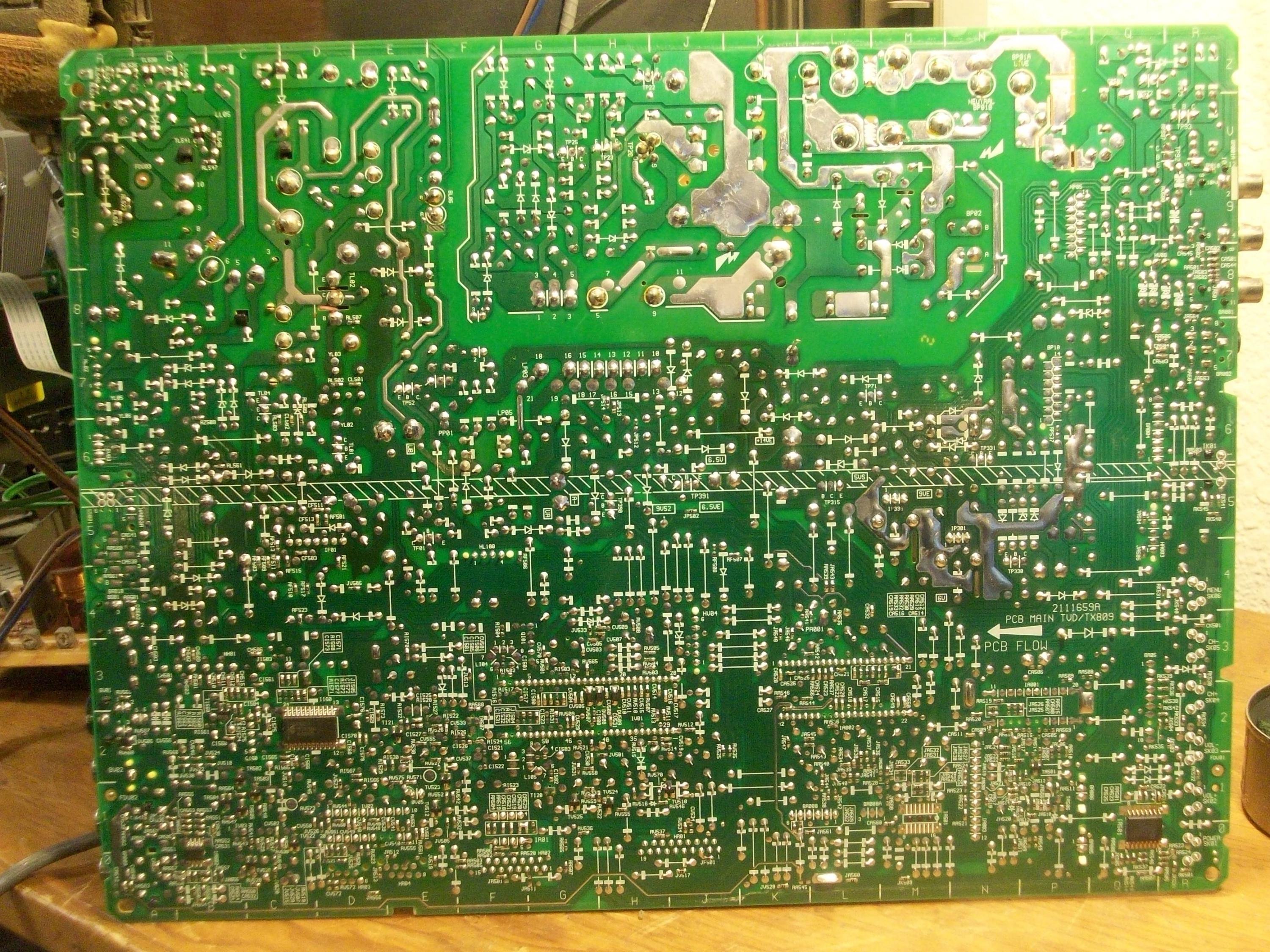

                                      The markings on this board doesn't jive with the votage chart on pg16 in the PDF I'm attaching. It is for a TX809 TVD809 and what I have is marked TVD/TX809. Number above 2111659A
                                      Summary, I've got no low below 8.8 volts. 5v, 6v and 6.5v points are dead. Again the power botton has no effect.
                                      UB = 117.9v
                                      UA = 12.2v
                                      12VE (doesn't exist on board)
                                      14VE = 13.2v (doesn't esist on chart)
                                      9VE = 8.8v
                                      9VS (doesn't exist on board)
                                      9VS2 = 9.4v
                                      8VS (doesn't exist on board)
                                      +5VE (doesn't exist on board)
                                      -5VE (doesn't exist on board)
                                      5VS = 0v
                                      4VE (doesn't exist on board)
                                      6.5V = 0 (doesn't esist on chart)
                                      6.5VE = 0 (doesn't esist on chart)
                                      6V = 0 (doesn't esist on chart)
                                      Attaching a pic of the solderside of the board.
                                      Kasfamily, before I do as you said can you please explain to me how shorting those high voltage CRT pins turn on (or up?) each of the color guns. Also it safe to use just an insulated test lead straight to ground or should I have some resistance in series? Just want to be care with the HV stuff Thanks.
                                      Thanks again everyone for the great help here!

                                        Measure the voltage on the IP301 and IP330, and testing their name. About the test CRT ... TV should be turned on, to connect the pin CRT to ground, you can use a wire from the dmm. Enough for a brief moment to touch one end wire to the ground and the other end to pin CPT and look in the mirror to the screen tv. I check the wire from the device without the use of resistance. Security is recommended to all measuring of the TV with one hand, and on the other hand, must be behind the back
                                        • SteveNielsen
                                          Retired Tech
                                          • Jun 2012
                                          • 2327
                                          #40
                                          Re: RCA (Thomson) F20TF10 in a coma
                                          Things have gone from bad to worse now; no HV from flyback to CRT anode so no can do the CRT pin grounding tests.
                                          IP301 is a 7806A regulator
                                          IP330 I can't tell, it is covered with a metal clip to the heatsink that I can't budge
                                          IP301 has .01, 0, .07
                                          IP330 has 11.67, 0, .74
                                          I'm starting to think this is destined to be canablized for parts and recycled.
