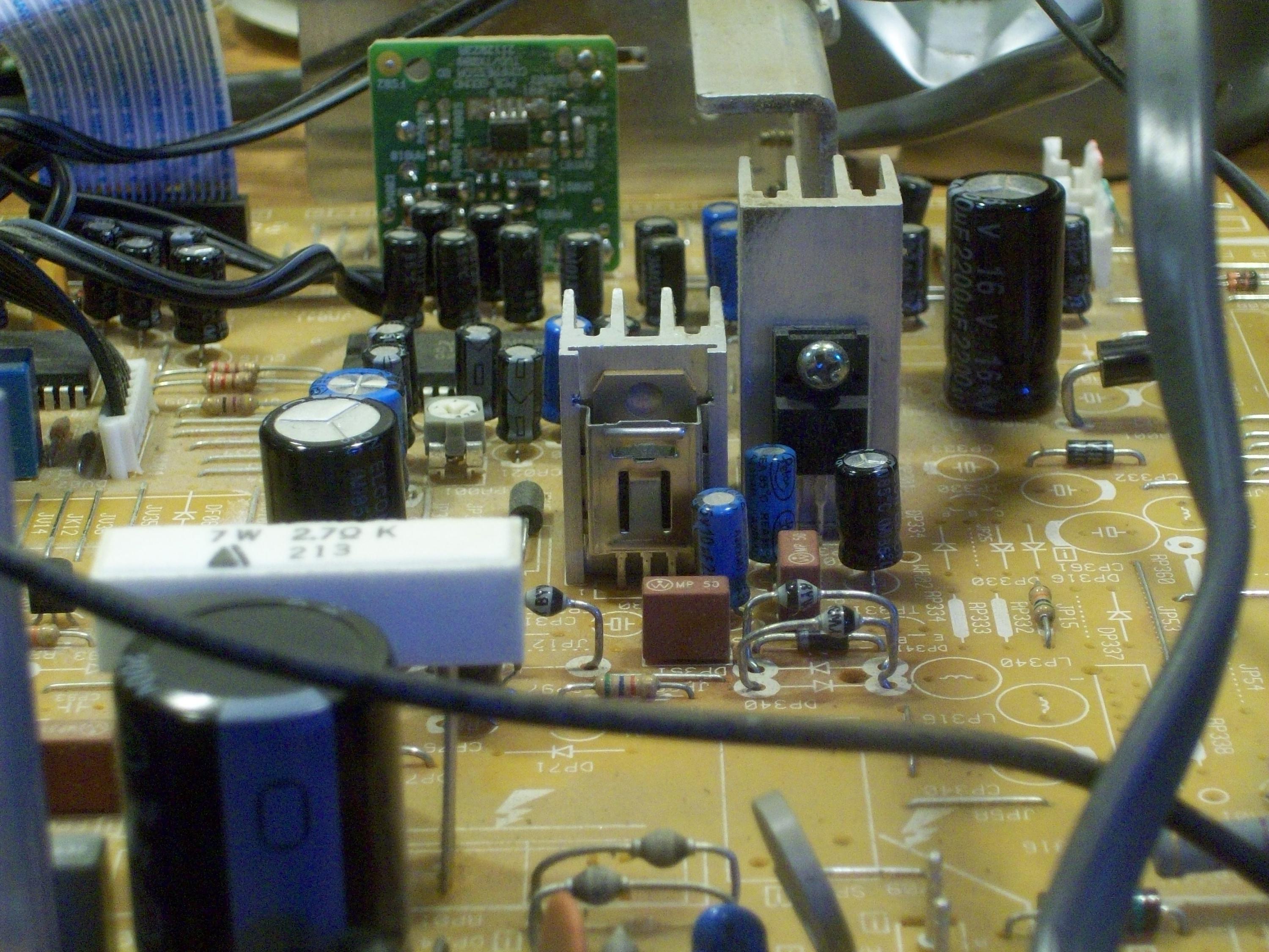

    It all depends on your desire to fix or not. Check all connections and installation. Now we need to understand why there is no remaining supply voltages. IP330 probably 7809 and it is necessary to determine why there is not 3 pins of 9 volts. Check what kind of resistance has pin 3 IP330 to ground. IV01 video processor is labeled TA1268?

      Yes, I understand it depends on my deisre to fix it. The disappearance of the flyback output is disappointing though. Double checked my connections. Nothing has changed since yesterday when there was still 27KV on the anode.
      IP330 pin3 has 1.1K to ground.
      Yes vid proc is TA1268N.

        Means it is necessary to remove the metal clip and change the IP330

          I think there are two problems, and correct me if I am wrong but please make clear explanations for me. I am obviously not as knowledgable a component level electronics tech as you guys are.
          Problem #1
          No 6 volt supply.
          Problem #2
          No flyback output. (Which WAS working before when there was still no 6v)
          I'll see about freeing IP330 and see whare I can go from there. Thanks so much for the help and please have patience with me.

            Ok now the main problem is the absence of 9 volts. Until tomorrow.

              Yes, IP330 is a 7809 regulator.
              I damaged pads and traces (again) trying to get that clip off the heatsink. Why didn't they just screw it to the heatsink like the others? I had to remove the chip and heatsink as a unit.

                I guess they did not have screws. Everything must be carefully restored.

                        This clip I have not seen, probably had desoldering 7809 together with the radiator. Check the fuse marked MP 50.

                          Interesting you should mention that MP 50 because I was just looking at that and wondering what it was. It measures open in the board, good call buddy

                              It is a Wickmann MP50, 500ma 66v

                                  It will please you to know I destroyed no pads or traces removing it.
