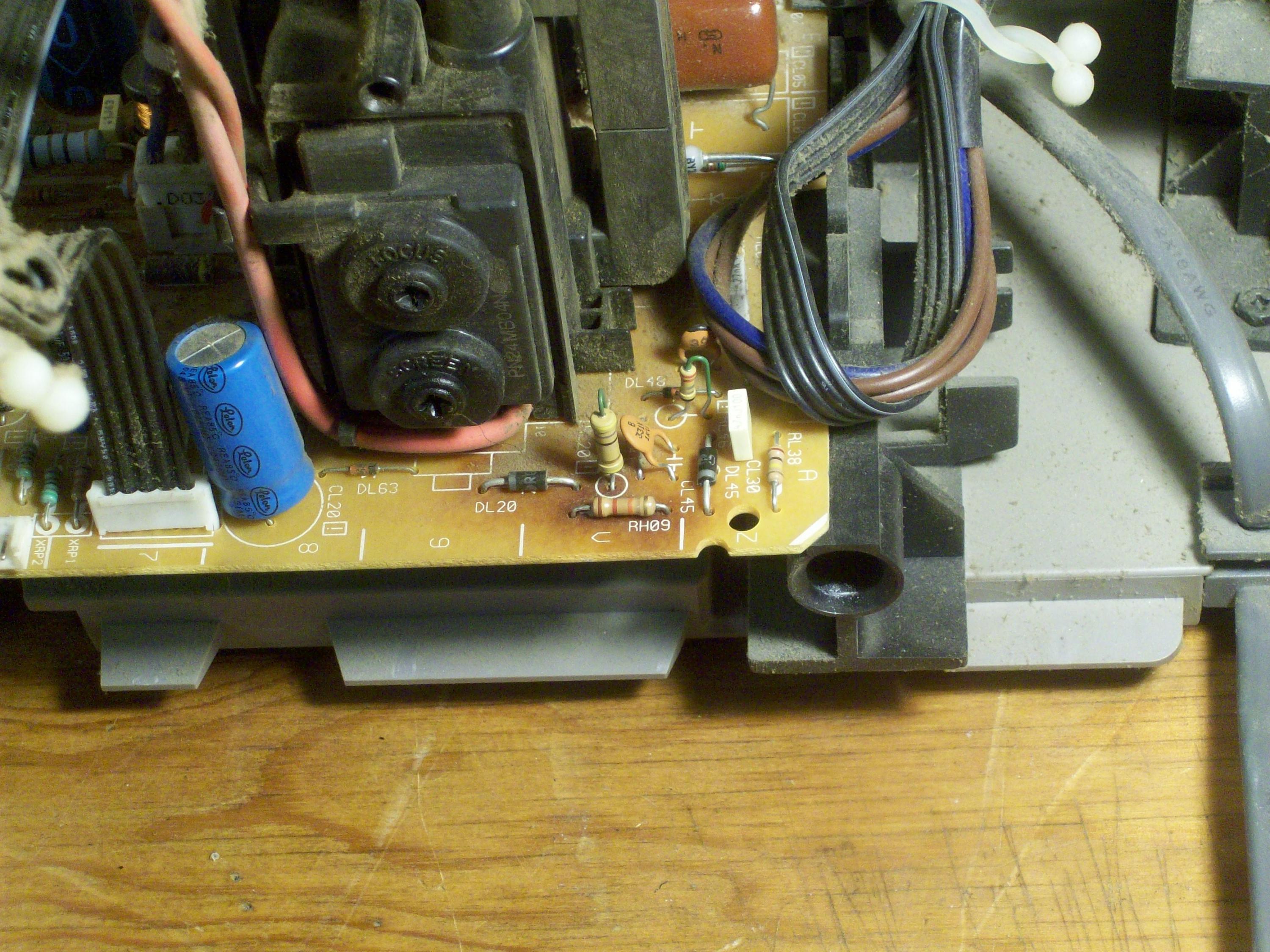

                This spot by the flyback shows signs of heat. I checked the resitors and diodes in this area and they are all fine.

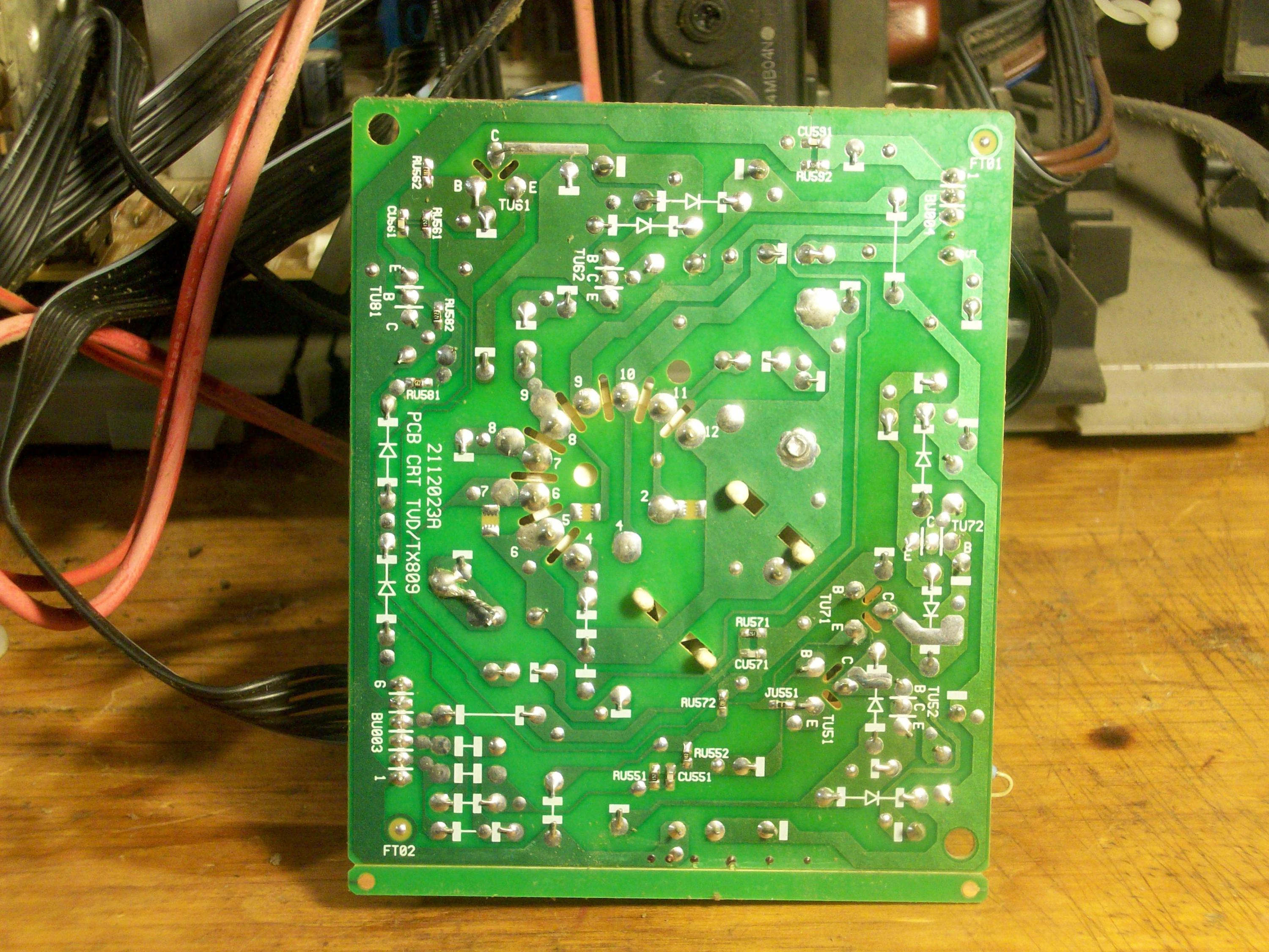

                • kasfamily
                  • Aug 2014
                  • 772
                  • Russia
                  Re: RCA (Thomson) F20TF10 in a coma
                  show photo crt board
                    Originally posted by kasfamily
                    crt board
                    BTW, on this CRT board connectors BU003 & BU004 are switched, i.e. BU003 s the 6 pin and BU004 is the 5 pin. Tracing visually the heater pins on the tube are 9 & 10. Just for clarity, is the heater votage AC or DC?

                      ac right off the fly with maybe a low value resistor.

                        I measured 5.4 ohms across pin 9 & 8 on the crt so I think the heater is ok. I've got 14.5 vac with power applied. I can hear the audio amp, degaussing coil and crt hv when plugging in ac cord.
                        Here are the crt board pics kasfamily requested.

                                pin 9 & 10 on the crt board the heater
