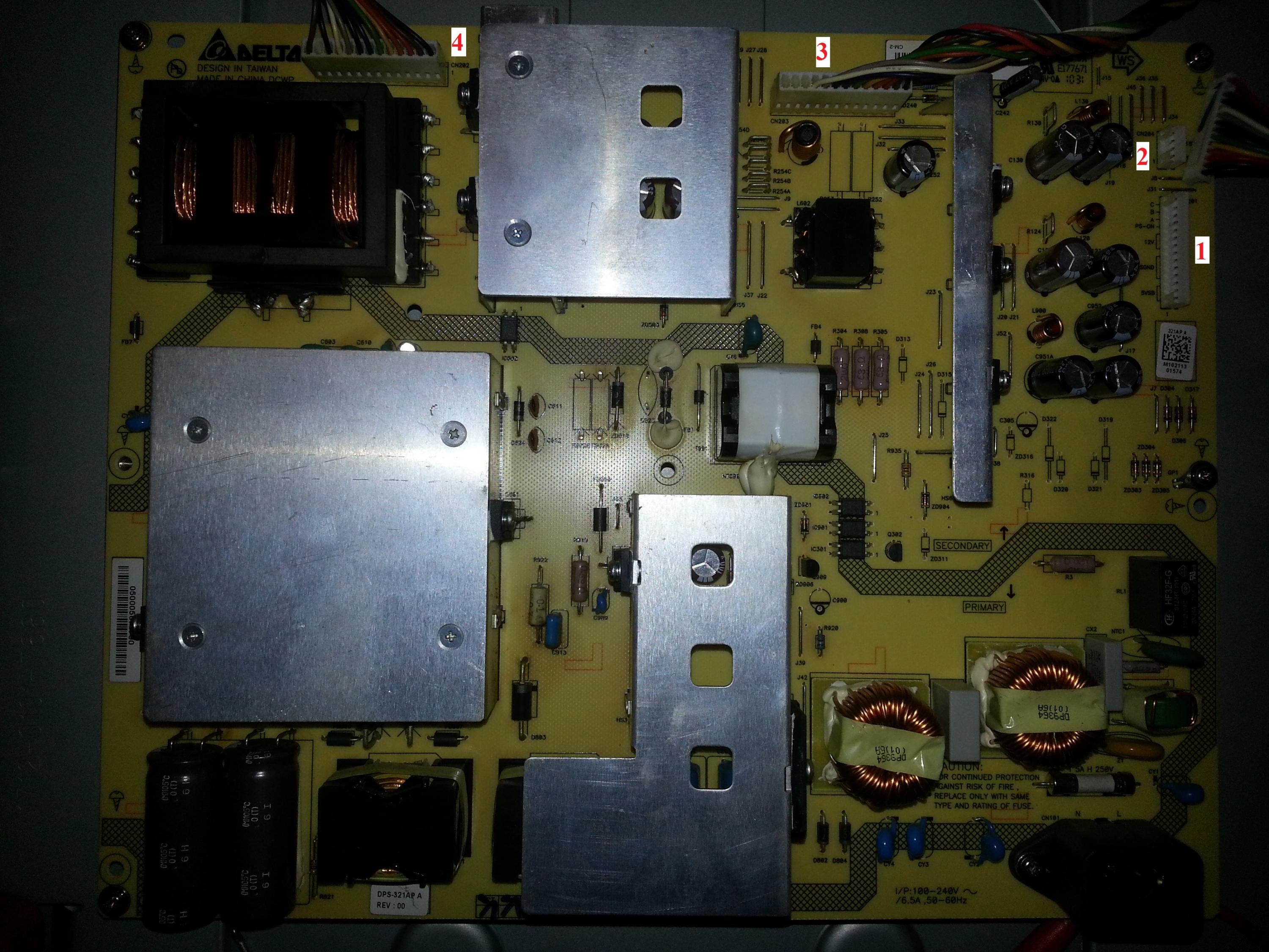

    OK. I'll organize this as simply as possible.

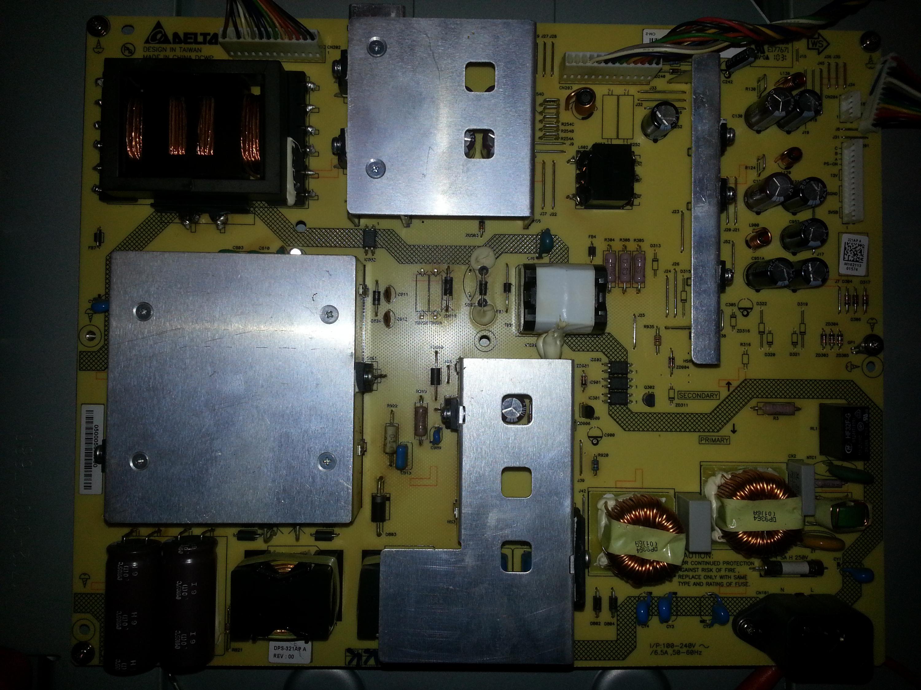

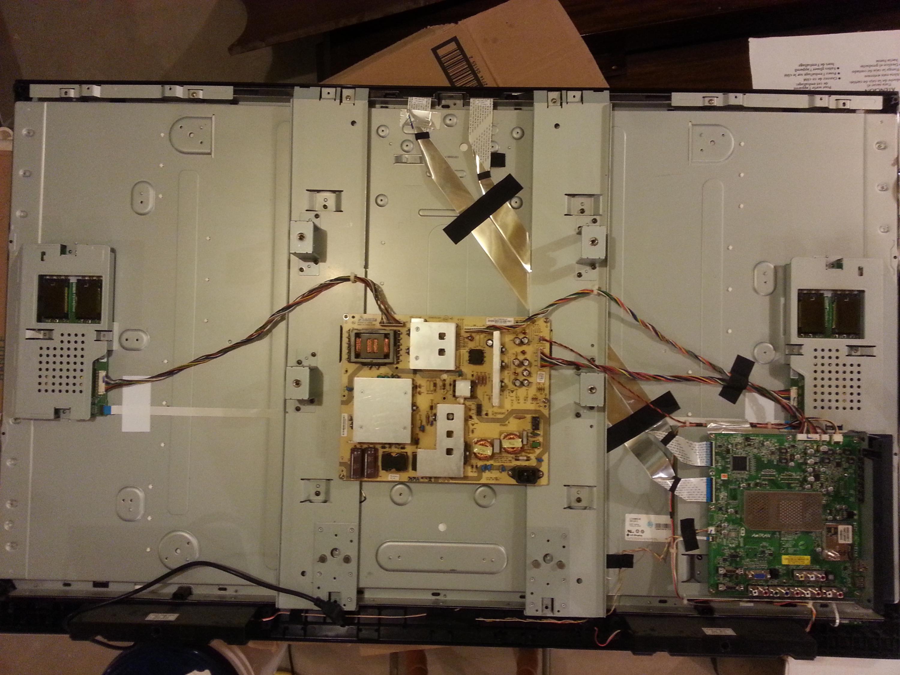

    DEVICE: Vizio E550VL, contains an LG LC550WUB-SCA1 display.
    PROBLEM: Immediately upon plugging in power cord, the power cycles on/off every 2 seconds. Power on is associated with a distinct click and 'vizio' insignia on front lights up orange. It then immediately cycles off with another click and vizio insignia goes black. The vizio insignia never goes white. The screen never comes on. Time from on to off is perhaps 1/4 second, very quick.
    TESTING THUS FAR: No visible component defects noted. No bulging or leaking caps, nor burn marks etc..
    Tested Fuses: All test good (will retest for peace of mind ASAP)
    Disconnected all cables from Main Board except power cable from PS (labeled connection 1). Issue still recurs.
    Disconnecting both power cables from PS to inverter boards (connections 3&4) yields the same on/off behavior, but at a fast rate.

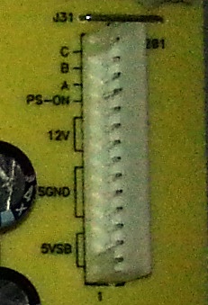

    Disconnecting connection 1 on diagram from power supply to main board eliminates cycling, but off course does not allow TV to operate. Upon jumpering 5v pin to PS-ON, the display does NOT turn on, but I am able to measure the rest of the pins at connection 1 as follows:
    12v= 11.66v
    5v= 5.04v
    A,B,C= 0v
    Connection 2 (pins are labeled 18v and gnd, cannot see in pic)
    18v= 17.98v
    NOTE: Upon accidental short between PS-ON and pin A at connection 1, the back light comes on without any noted defects. (I suspect pin A is BL_ON signal from main board?)
    Thats as far as I can get because the power cycles too quick to be able to get any readings from the main board. I have a standard digital voltmeter, a little amateur experience diagnosing, tracing, and soldering consumer electronics in the constant chase to save a buck and request any assistance you fine folks may be able to provide. I attached pics to help clarify the above. THANKS!

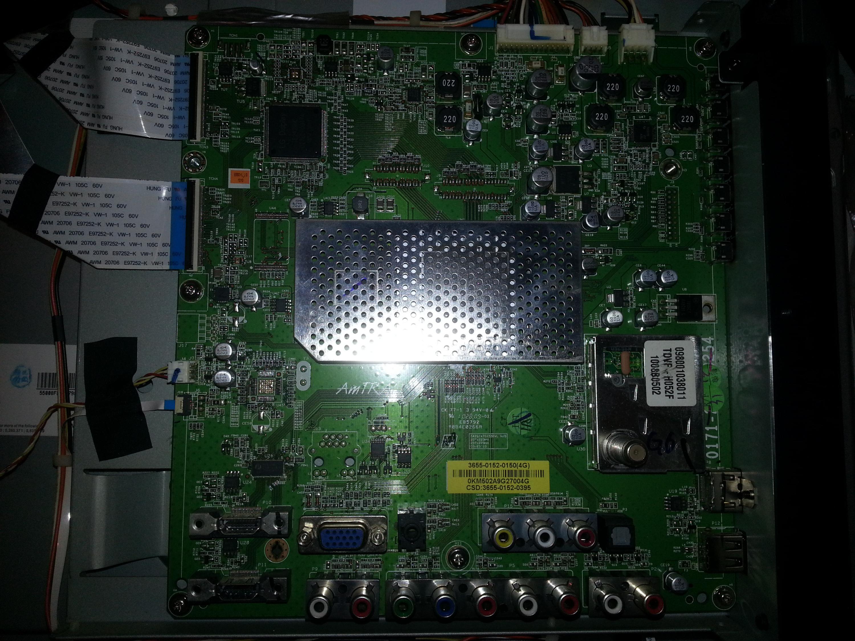

    "A,B,C= 0v" OK, the main board is not sending any of the command signals, I do not remember which is which but, they should be PS_ON, BL_ON, DIMMING.
    So I would check the fuses if any on the main board, check the voltages of the regulator ICs.

      I was only able to test A, B, and C with PS_on jumpered to 5v, and the cable (labeled '1') disconnected from the main board, so 0v is normal, right?
      That is what is so frustrating, I can't test anything with the main board connected since that is when it flashes on/off and too quick to take any voltages, not to mention the stress on all the components while its doing it.
      I'll retest the fuses tonight, but initial testing showed all good.
      Is it safe to jumper 5v to A, B, or C to turn on components for testing while the main board is disconnected?
      Also, would placing a load on 12v help test the PS? Whats the min/max load I should use for a test load? I have a 72W 12v led strip I can use...
      Lastly, I have not been able to find any technical documentation on this tv, although I guess thats pretty normal for vizio. If you have any leads on documentation, that would be helpful as well.

        OK, the board does have PS_ON pin, so A, B, or C are not used for PS_ON. A, B, C are used for the BL_ON and Dimming.
        You can force on the power supply using 100~1K resistor between PS_ON and 5VSB, when you do that you should then see the 24V and the 12V at the connector, you can do with out the load just to see if the voltages come up to the value first. You do have 5VSB right ?

          Yep, that is what I did for the voltage testing as noted. I tested the 5v from 5VSB pin, and used that to jumper to PS_ON to test the above.
          When I accidentally shorted 5v to pin A, the backlight came on, so it would appear the 24v supply is fine as well. Does this conclude the PS is good, or do I need to test the 12v under load?
          If it sounds like the PS is good, do you have any suggestions on how to begin troubleshooting the main board?

            Your power supply is good.
            You can start checking the fuses and regulator ICs on the main board next, not sure if this is one of those VIZIO with EEPROM problem or not.

                          Yes, the 5vsb is cycling as it clicks on and off.
                          Does this mean a probable short in the 5v system on the main board?
                          I have also found a possibly abnormal reading on U4.
                          U4: pin 1 & 3 = 1.2 ohm
                          Pin 1 & 2 = 79.1 ohm
                          Pin 2 & 3 = 80.4 ohm
                          And yes,thats ohms, not M-ohms or k-ohms.
                          Also U4 diode test:
                          1 to 3 (and vise versa) = 0.00v
                          1 to 2 (and vise versa) = .036v
                          2 to 3 (and vise versa) = .036v
                          Does this sound normal? Looks like its a variable ic, type 1117. These readings are very different than others so far.

                                Re: Vizio E550VL: Plug In = continuous on/off clicking
                                OK, it can be due to too much load due to bad components on the main board, or the 5VSBY is weak due to bad caps and cannot handle the load.
                                Let try using simulated load on the 5VSBY using 5 Ohms 5Watts minimum to simulate 1A load and see if it is stable at 5V. You just need to run the power supply by itself with 5 Ohms load.
                                • ulsh72
                                  • Apr 2014
                                  • 28
                                  Ok. Use a car dome bulb. I got steady 1.28A draw at 5.01v. No cycling, nice and steady.
                                    Good, so the problem is the main board is drawing more than the power supply can handle.
                                    I really do not know the easy way to find which components on the board is drawing too much current since the power supply goes into shutdown/restart mode not long enough to see which component gets hot.
