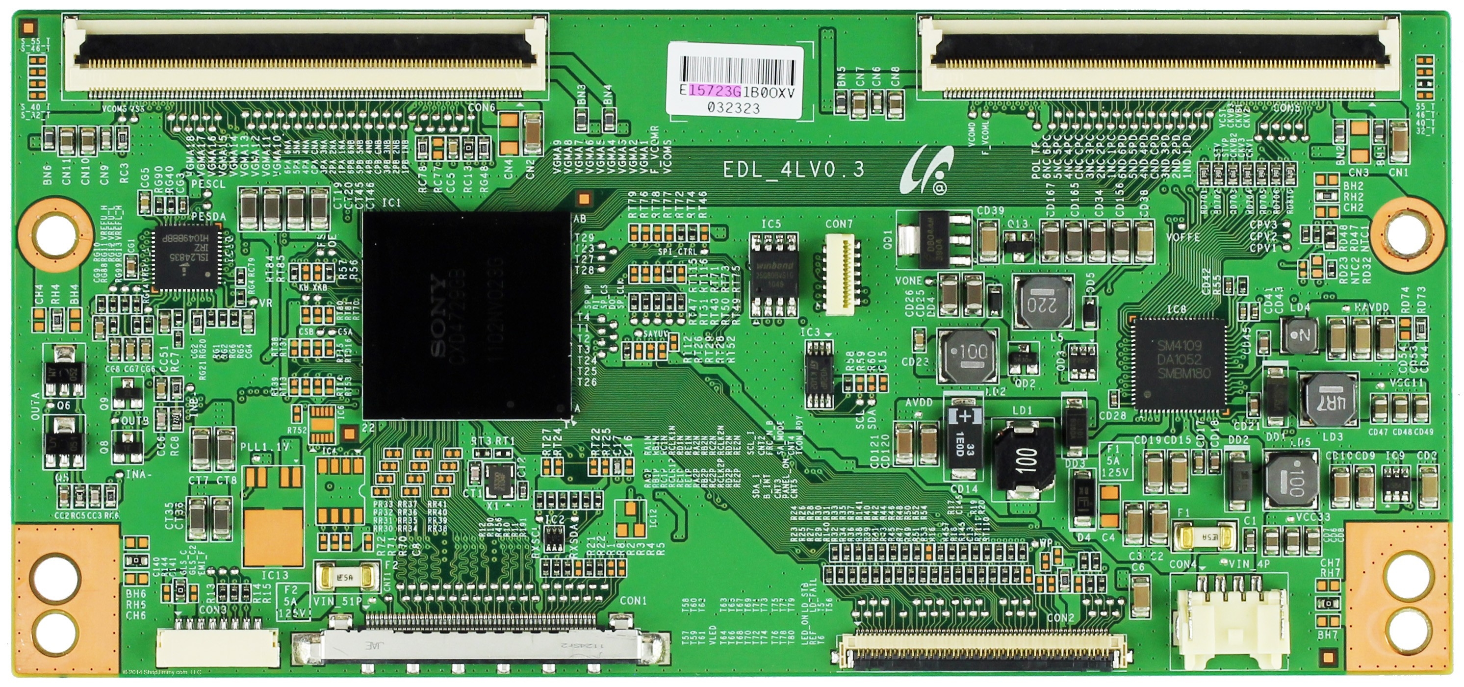

kdl-40nx723 e double image help please
  • wreksta
    • Aug 2013
    • 508
    • england
    DOES ANYONE KNOW WHAT CAUSES THE
    double image problem on my 3d tv
    I will get a picture
    but basicly its like this
    all wording and images are doubled
    3d display
    3d display
    3d depth adjustment
    3d depth adjustment
    that's an example
    ive tried updating firmware etc any ideas could this be hardware related
    please help

    Re: kdl-40nx723 e double image help please
    after removing left side screen ribbon my picture fades away
    when I remove my right side ribbon the left side of screen is perfect
    if I put both ribbons back im left with double image
      That sounds like a bad LCD panel to me. If the image is OK with one ribbon out, it's usually the panel (I can't recall a case where it is not.)
        tom anything else it could be ideas please it just went like this
          +1 bad panel.
            I think it's scrap, sorry :/. You're welcome to try fiddling with the tab bonds of course, but since it just "went" I doubt it'll be fixable.
            edit: Now I'm home and I see the picture, I would definitely say panel is bad.
                  Originally posted by wreksta
                  tom ,bud why do you say this straight away could the connections from tcon to driver board noit be bad I aint checked this yet could be a bad ribbon etc
                  Because we've seen it hundreds of times and it is always a bad panel (so far I believe without a single exception.) You could rule out your ribbon problem by swapping the two ribbons over. (Do NOT connect left to right, but just swap the cables on both sides.) However, I doubt they are the fault.
                  When you unplugged one half, you removed whatever was faulty on one half of the panel that was loading a signal line down. (read: shorting an important signal.) I am not sure what exactly is failing, but it is probably one of the driver ICs on that part of the panel.
                  Modern LED-LCD TVs have shockingly high rates of panel failure. Next to open-circuit LED (a bloody difficult one to fix!), it seems to be the most common fault (...one of the reasons I prefer fixing plasmas.)
                  I bet this TV has Samsung (S-LCD) or AU Optronics panel.
                    Originally posted by kasfamily
                    a panel name in the tv ?
                    Here is panel id list.
                    wreksta wrote,
                    may be VGH-VGL voltage problem there.
                    pls. post T-con pic.
                    Regards
                          tom what is this vgl fault any ideas what to test please
                            It's a voltage on the T-con board, marked by a test point VGL or VOFFE.
                            Should measure around -5V to -10V (black on chassis, red on test point)
                                Tom vofee test point is 11.7 volts any ideas is there tab bonds down the sides mate
                                    Is VOFFE negative? Does it change with the ribbons one at a time, or both in? If that is OK, then it rules out a VGL problem on the T-con board (so it probably is not a T-con problem but panel related.)
                                    On these newer panels there usually aren't bonds down the side of the screen, they are now built into the glass (which should be more reliable, time will tell.)
                                      here is tcon pic. and voltage.
                                      pls. check if your tcon board is same as pic.
                                      SM4109
                                      VIN - 12V
                                      HAVDD - 8.25V
                                      VCC33 - 3.3V
                                      VOFFE - minus 7.4V
                                      AVDD - 16.5V
                                      VONE - 28.6V
                                      VCC12 - 1.2V
                                      VCOMG3 - 7V
                                      7V VCOMG2B
                                      INA- - OUTA 6.6V - 6.4V
                                      INB- - OUTB 7V - 6.6V
                                      RST - 3.3V
                                      OUTC - 8.6V
                                      Regards
                                        hi I cant find half of those voltages
                                        tom can you explain how to do this negatively
                                        running tv as it all cables connected
                                        I get these
                                        havdd - 8.53v
                                        vcc33 - 3.3v
                                        voffe - 11.7v
                                        avdd 17.1v
                                        vone - 30v
                                        vcc11 1.2v
                                        ina 7.3v
                                        outa 7.3v
                                        inb 0.96v
                                        outb 1.0v
                                        from what I can work out here these don't look right to me
                                        help me out I cant seem to find
                                        rst
                                        outc
                                        7 vcomg2b
                                        vin
                                        vcomg3
