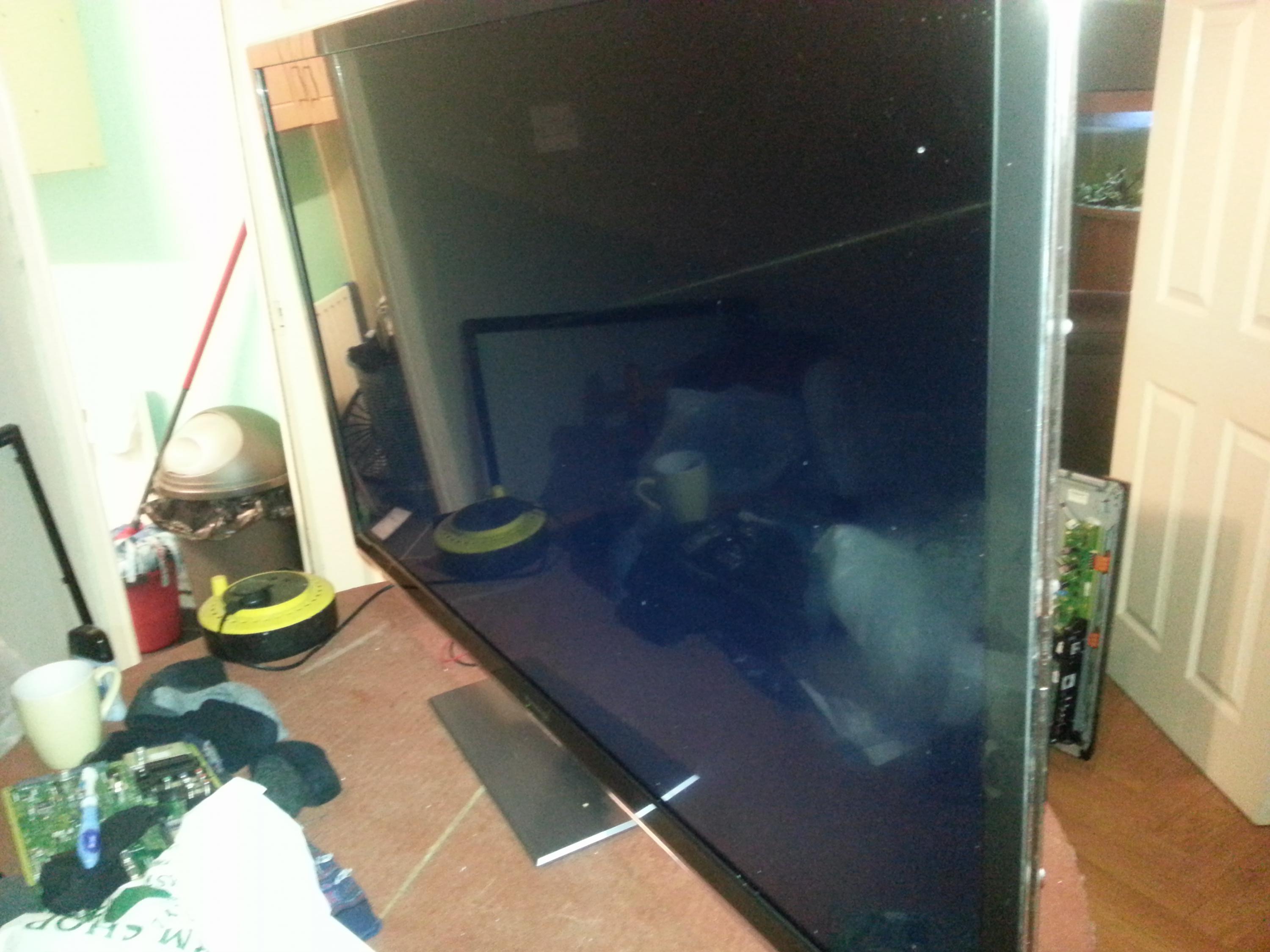

As above just back light tried a t con and still nothing
Panasonic txle55t5b back light no picture

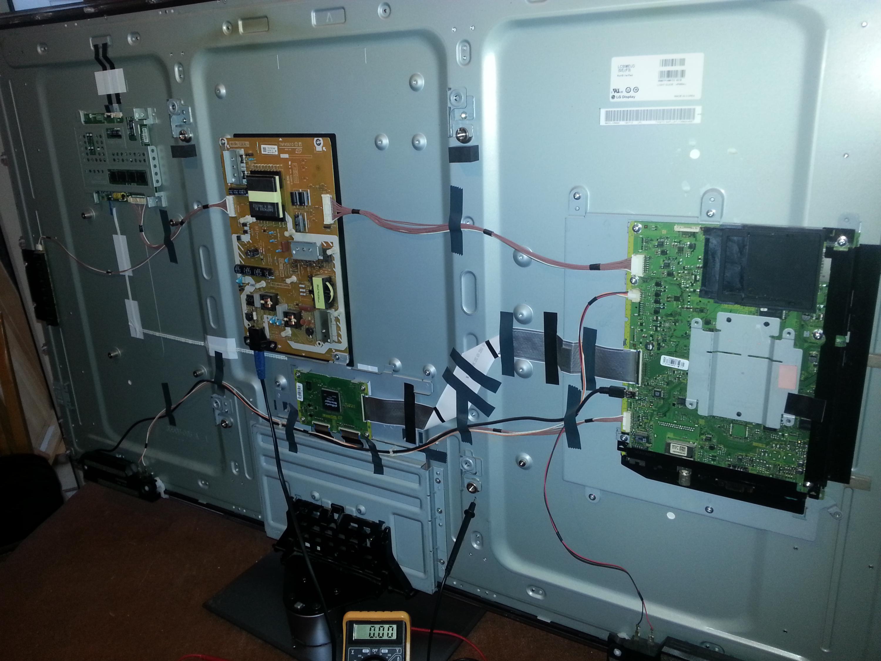

Re: Panasonic txle55t5b back light no picture
You need to see if the T-CON SMD fuse is getting the DC voltage from the main board or not.Never stop learning
http://www.badcaps.net/forum/showthread.php?t=24809Comment
I believe bad panels due to water ingress are pretty common on these, if that is the case it wouldn't be fixable. As bud suggests check T-con fuse voltage. Also try running T-con with one ribbon at a time, see if you get part of a picture (will confirm bad panel for sure) and check T-con points AVDD, VGH, VGL, etc. (AVDD=14~18V, VGH=20~30V, VGL=-5~-10V)
Also, did you replace the Panasonic marked part (TNPA...) which appears to be the Motion FRC (100Hz etc) or the LG marked part (the actual LCD T-con board.)Last edited by tom66; 09-11-2014, 01:00 PM.Please do not PM me with questions! Questions via PM will not be answered. Post on the forums instead!
