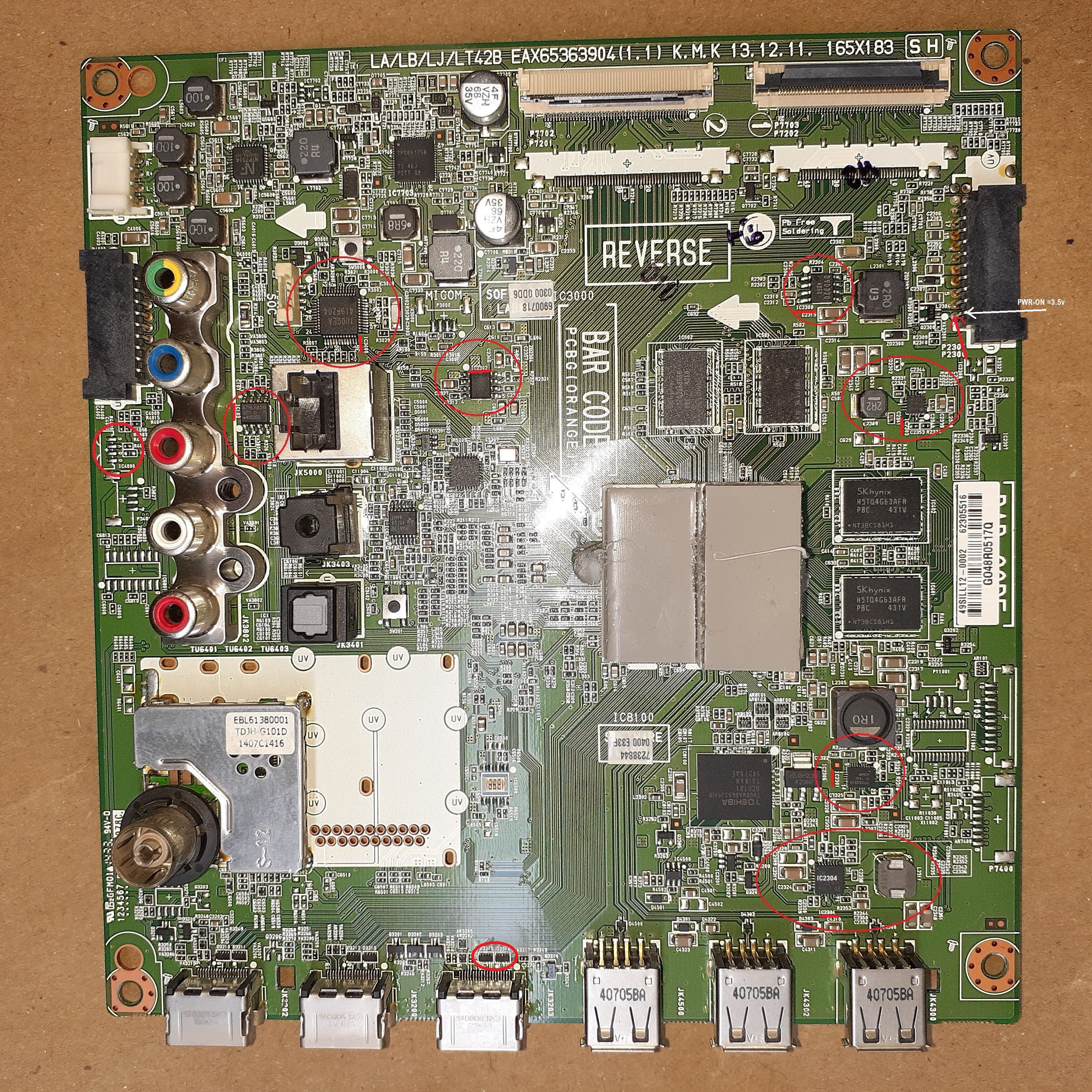

    My living room TV kaput after lighting storm along with Cable Set-top Box connected via HDMI-3.
    So, with my little knowledge of electronics I thought of fix it by myself.
    First, I searched forum for any case registered existing if anyone have same issue/symptom.
    Found some few case near matching But not really the same !!!
    Now decided to open a new thread.
    Brand: LG
    Model: 47LB6500.ATR
    Panel: LC470DUH (FG)(P2)
    Main Board: EAX65363904
    Problem:
    No Back light
    No Picture
    No Standby light (Red LED)
    Sign of dead !!!
    Observation:
    HDMI-3: D3214/D3215 - Burnt - close look with Magnification glass

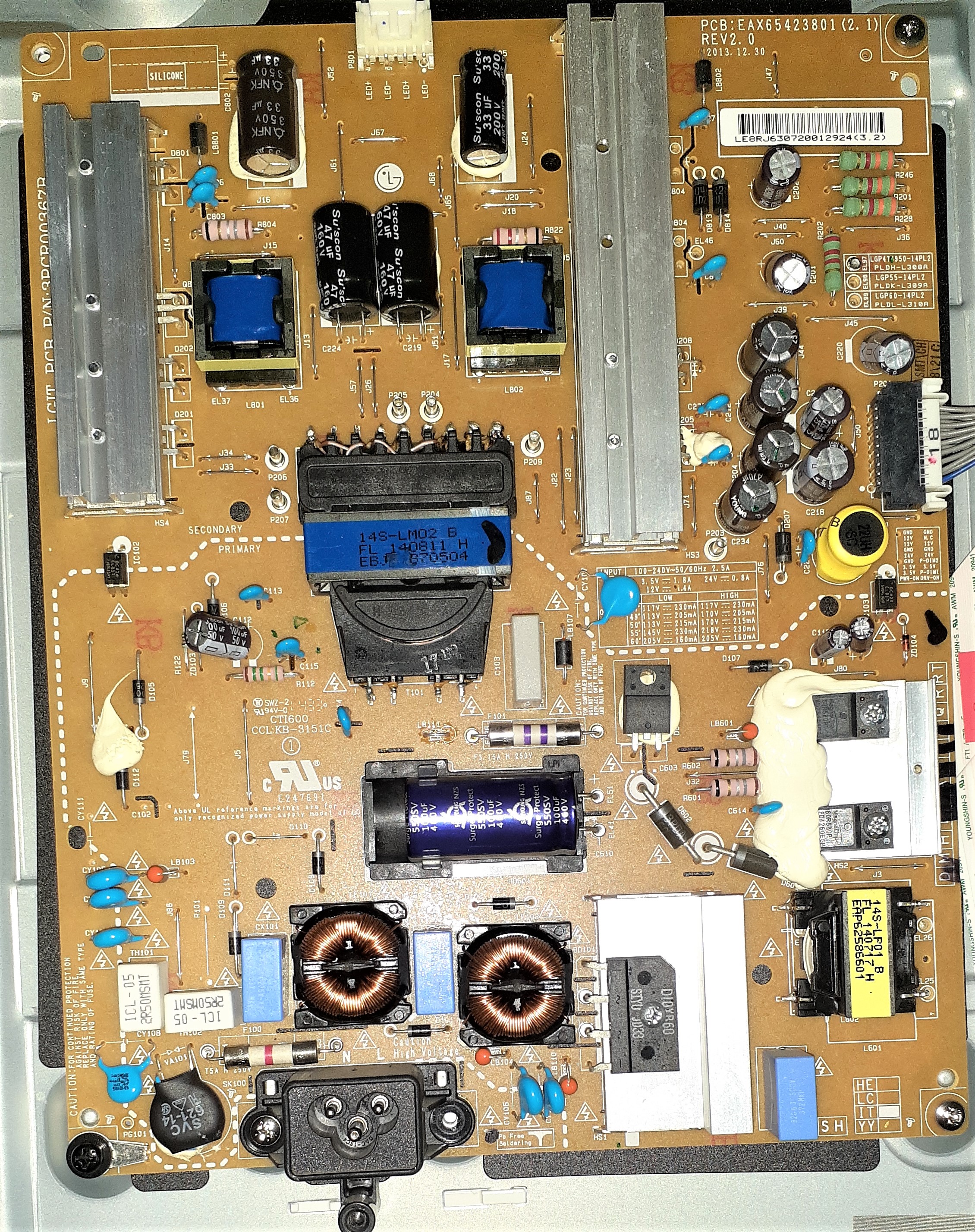

    Power Supply Reading as below
    Input Power Supply - 240v
    Connector P201
    PWR-ON - 3.5v Ok
    3.5v - Ok
    12v - Ok
    24v - Ok
    P-DIM1&2 - 0v
    DRV-ON- 0v
    P801
    LED strip: LED OFF - (Supplied 3.5V with 10K Resister to DRV-ON || All LED Turned ON)
    C610
    Power Capacitor : 358v
    Main Board Voltages
    Enable voltage is 0.8v
    All below IC input voltages are Ok but output 0v which is responsible to generate 3.3v,5v,1.5v,1.1v
    IC2300
    IC2334 (Typo in Schematic IC2304)
    IC2303
    IC2301
    Since there was no output of 3.3v,5v,1.5v,1.1v from above ICs, IC2303 has no output of 2.5v
    IC3000 input Vdd 3.5v is good
    But from IC3000 - enable pin feeding to above ICs were absent (0.8v) and also this IC is heating above normal.
    Any help would be much appreciated...
    IC2300
    IC2303
    IC2301
    Looks like IC3000 is not providing the Power_On/Off_1,2,3,4 to enable those voltage regulators.

        Re: LG 47LB6500.ATR - No Picture/No Back light but has standby voltage
        If the protection diodes are burnt, I would think the processor is dead.
          May be!!! but since IC3000 dead, can come to a conclusion after the replacement. Also there are chances that the HDMI diode burnt to protect Processor.
          Fingers cross until replace MICOM IC...
