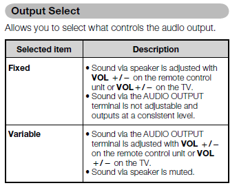

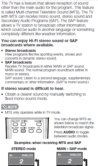

    Last night when i switched to the 46 i took this to my nephews room so he can use it for a few days till it sells on CL but ran into a problem. i know all components work fine as does HDMI but when he connected his cable box to it via coaxial the picture came up fine but no audio. just a slight almost ear ringing sound and extremely muffled speech at high volume. every tv i fix he runs it thru a rigorous 3 day ps3 marathon and never had this problem before.. is it a setting or does this have a bad Q thingy? the sound display says mono and flashes from green to red and sometimes alternates from mono to sap on its own but no sound just the squeal

      sound is already set to fixed and stil didnt work.. thanks for the reply though

          ------>the sound display says mono and flashes from green to red and sometimes alternates from mono to sap on its own but no sound just the squeal<------
          pressing the audio button switches it from mono to sap but it dont stay just makes a quick noise and continues to do above
