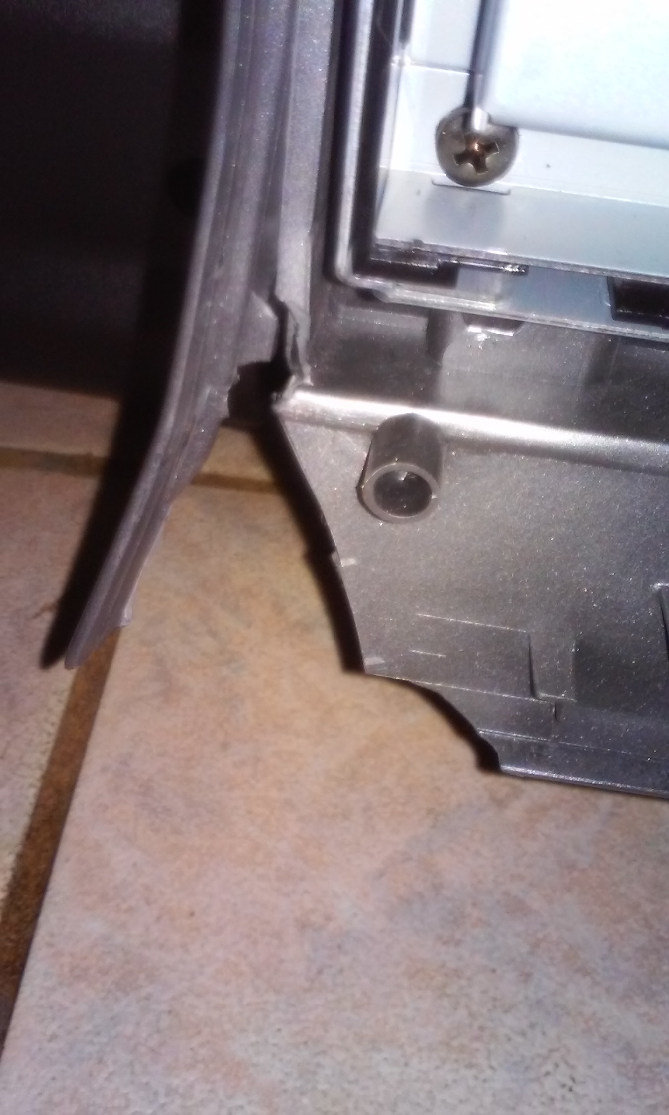

    Hi guys i picked up this tv that i know i paid way too much for but now its slim pickings since everyone seems to have gotten into tv repair. Any Who this tv has physical damage to the right side bottom of bezel in the form of a hole and split indicating its been dropped on that side and also did not come with a stand. the screen appears to be ok but when i power it up i get a flashing green power light 1 flash every second. if i go to service mode i get a quick flash od the screen where i can see hdmi on the top right then it goes black again with steady light.. i read all the threads on here referring to sharp tv's and am thinking since it dropped it has a few bad ccfl's i do see a couple dim lines on the screen when the quick flash happens. but there was another member who saw the same thing and his issue was inverter boards. so im at a 50/50 cross road and would appreciate some help in diagnosing this.. Thanks in Advanced

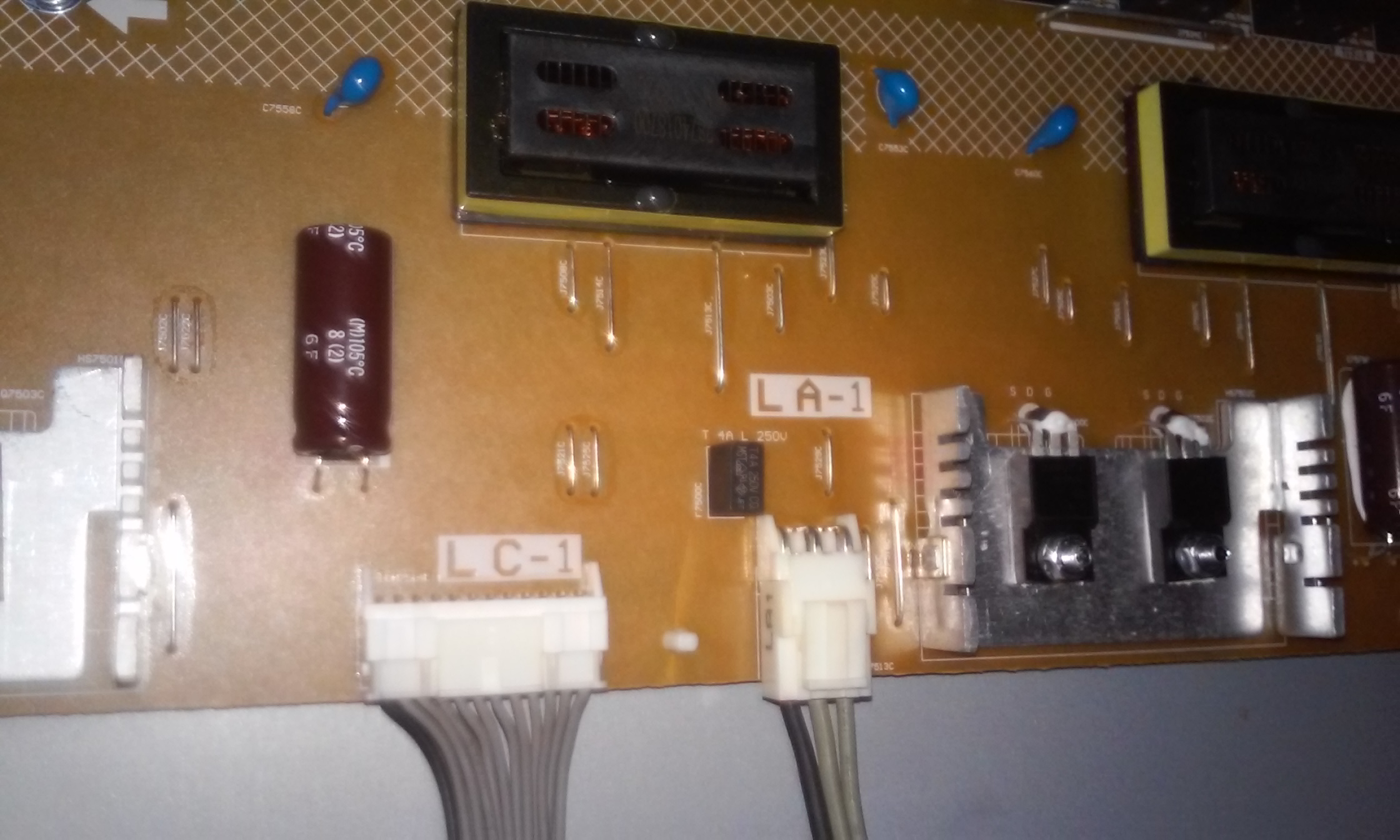

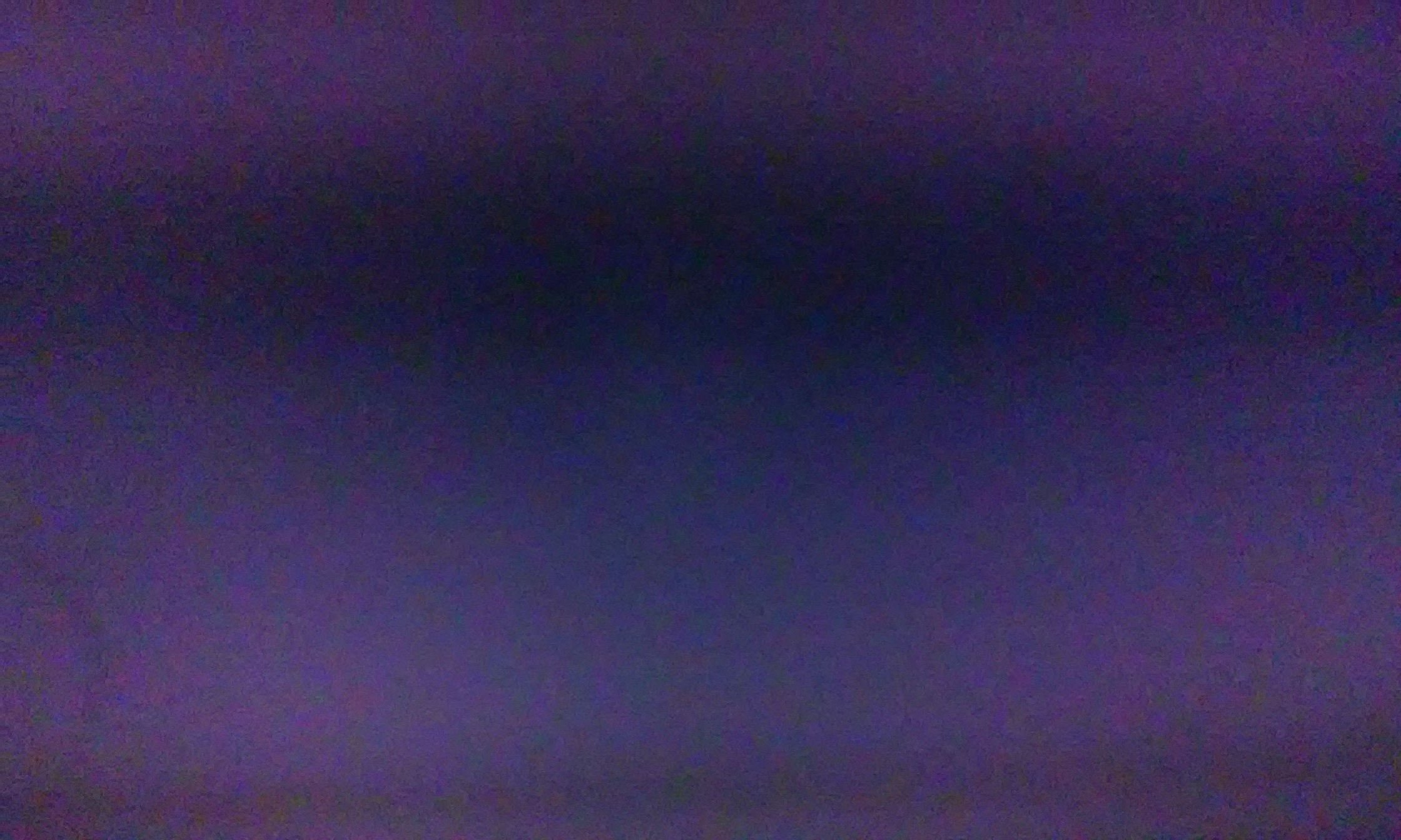

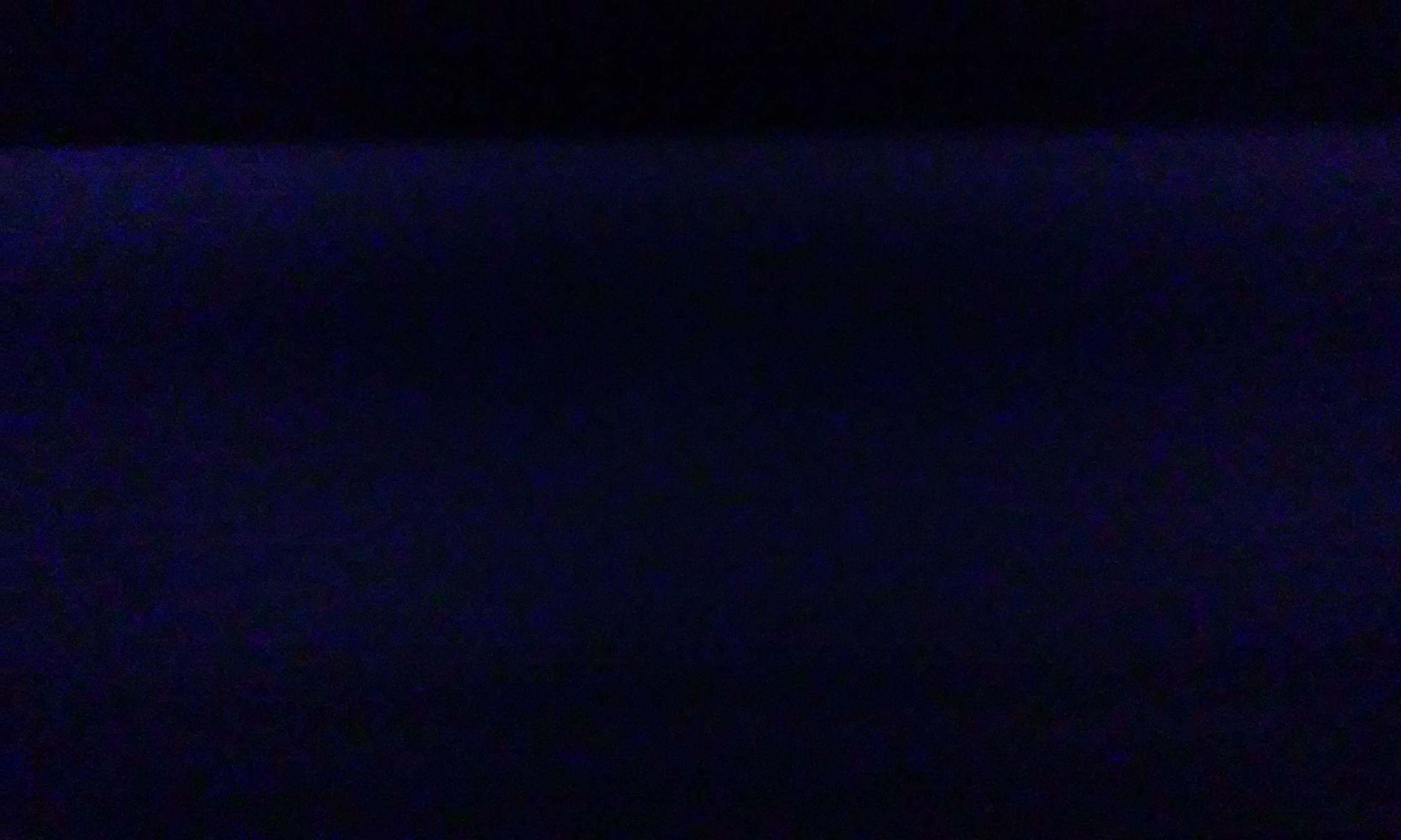

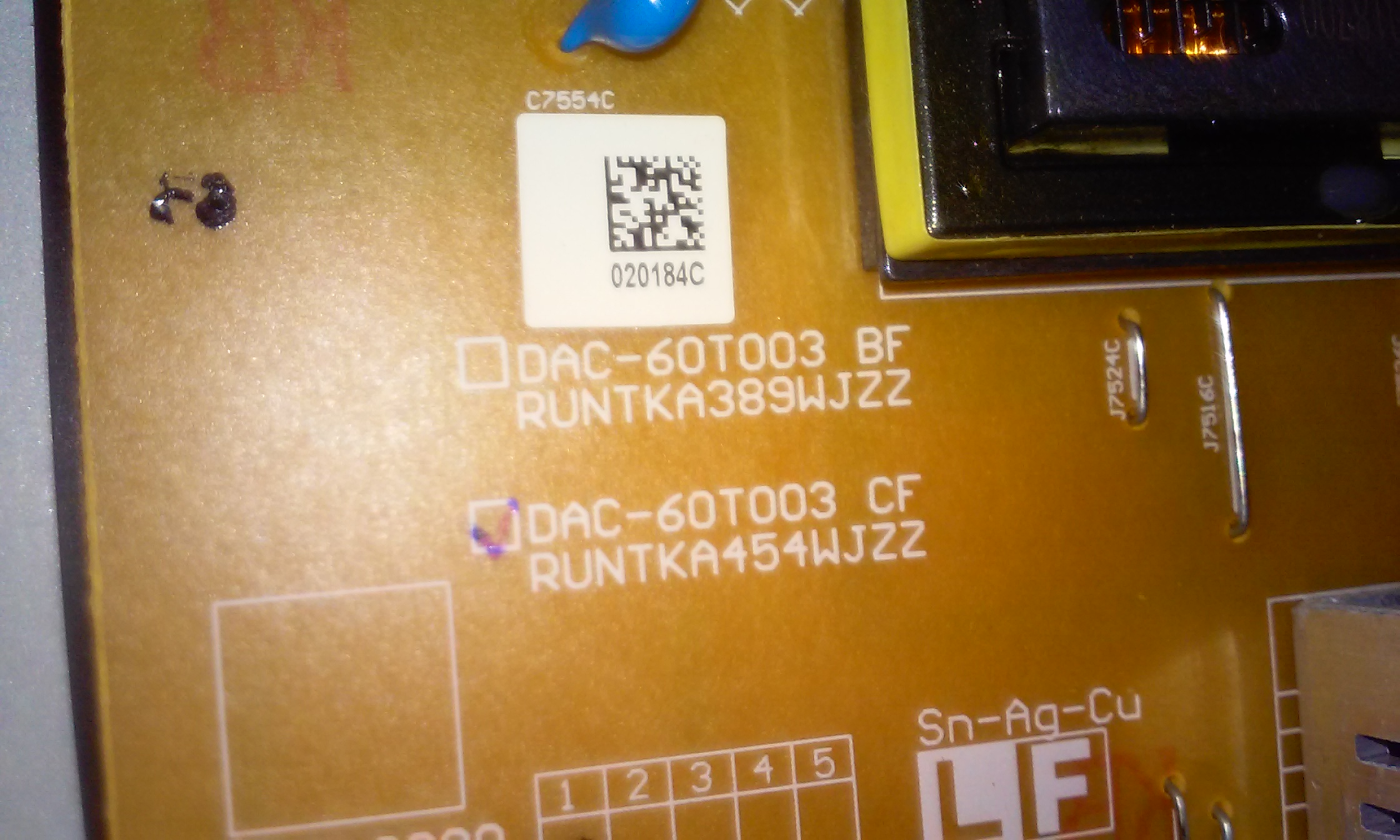

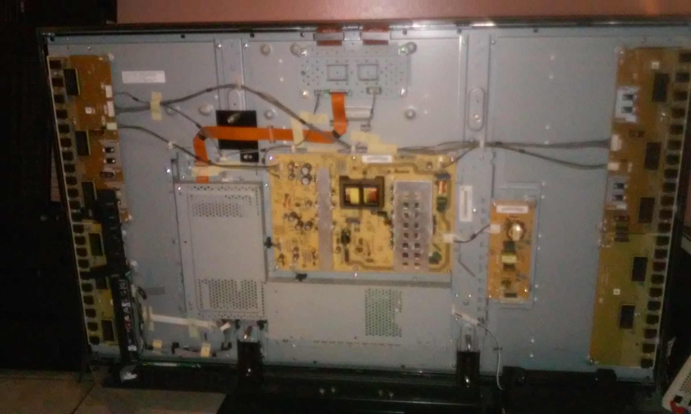

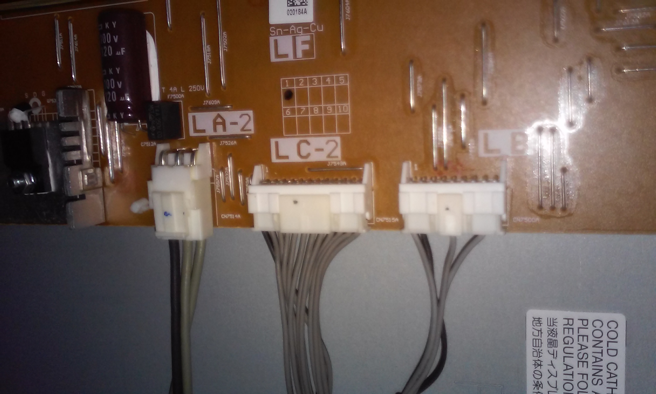

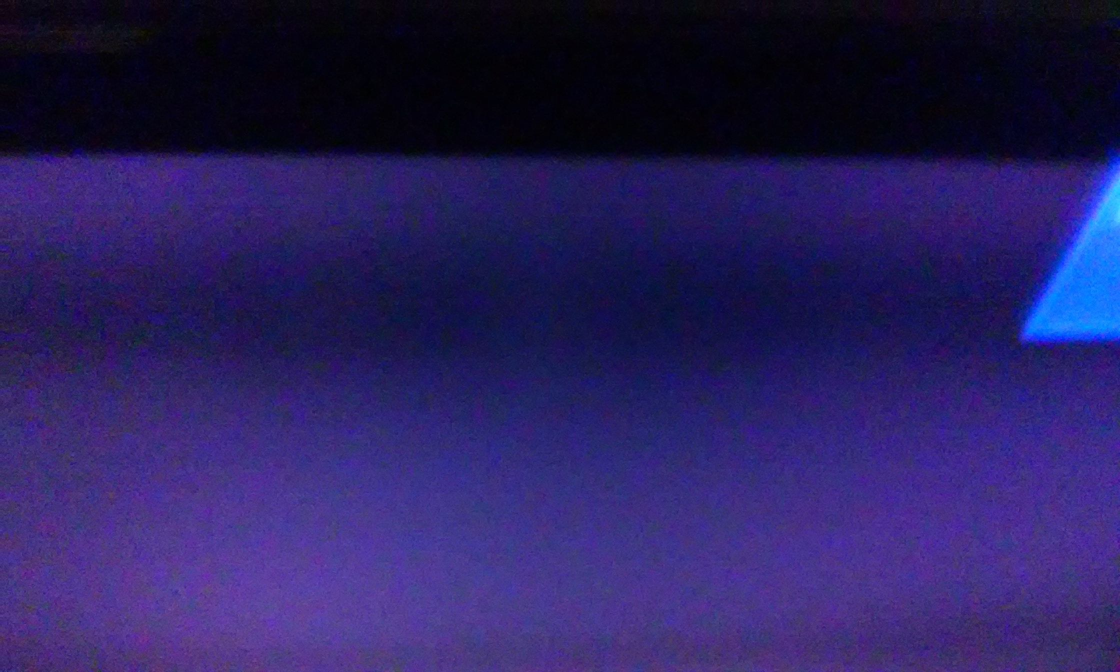

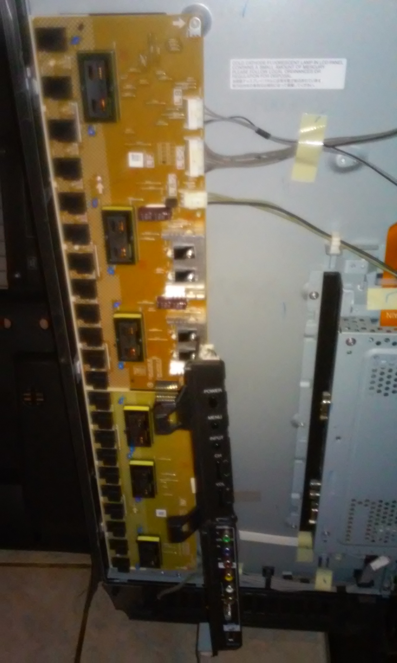

          Here are a few pics it is very hard to catch the screen on when trying to take the pic
          • kasfamily
            • Aug 2014
            • 770
            • Russia
            Re: Sharp 46D64u Blinking power light
            please photo near the connectors LA/LB/LC2
              You may have broken lamps. If you roll or move the TV from side to side, do you hear anything rolling inside the panel?

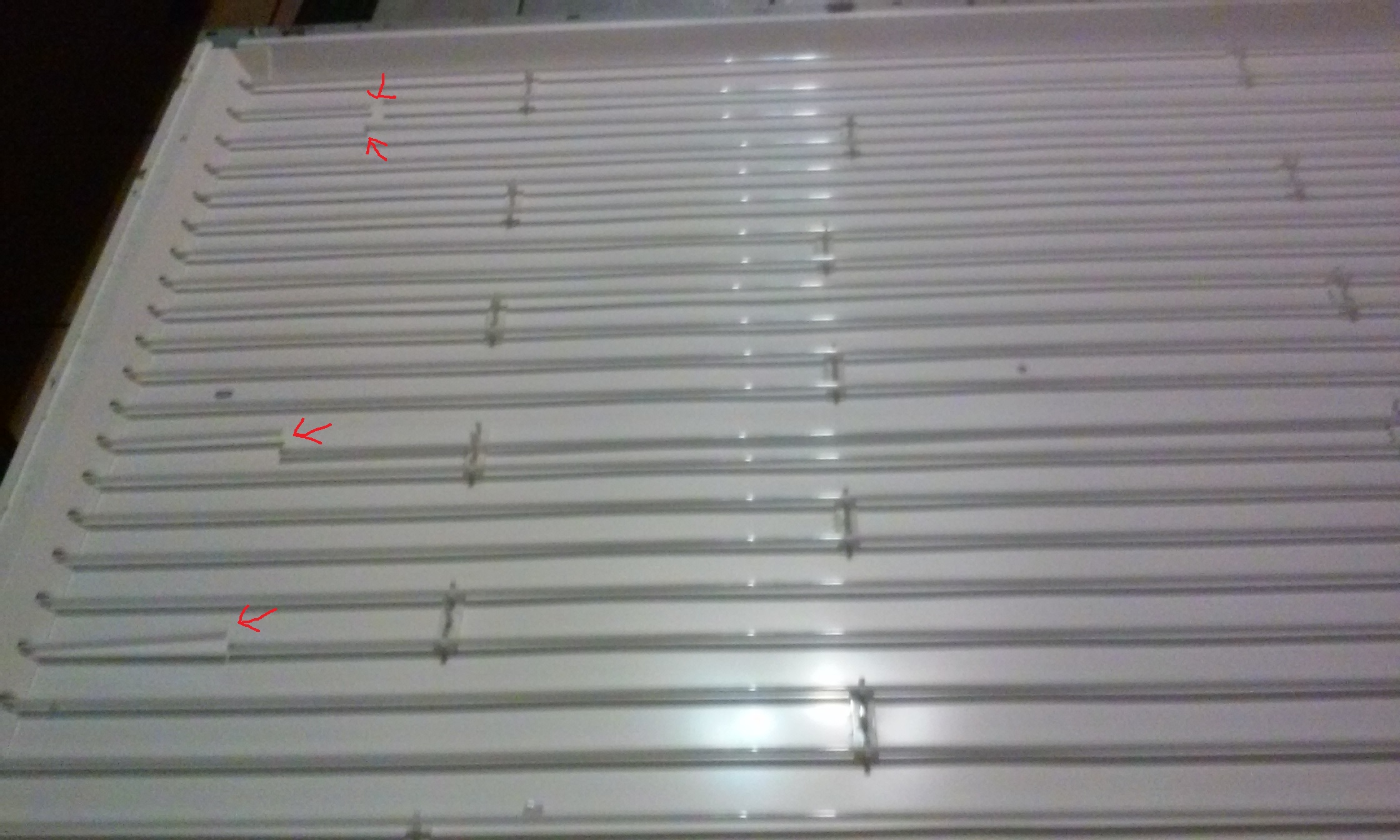

                  well opened it up and found 4 broken ccfl bulbs.. where the hell am i going to find these things at????? i have no clue

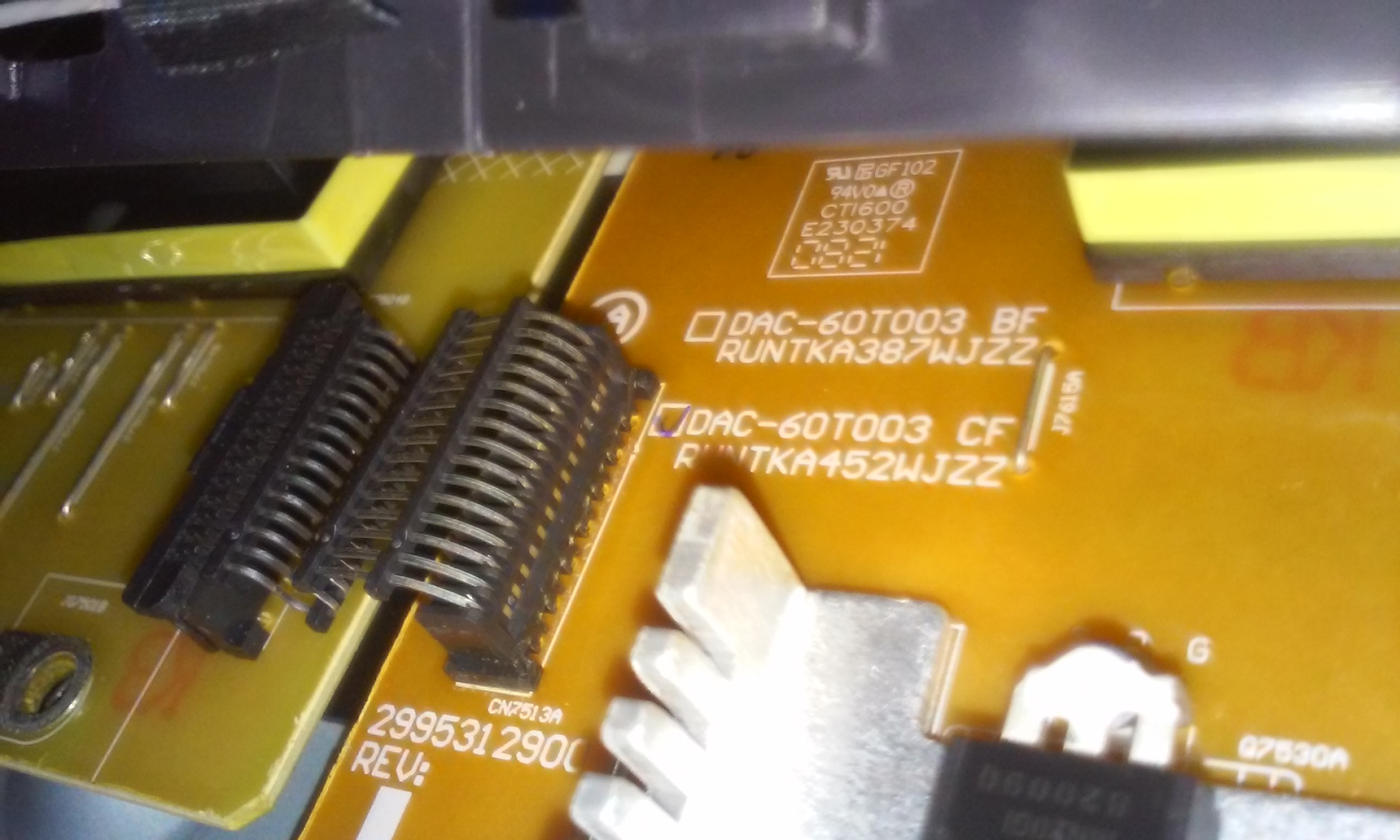

                              yea i bought one about 8 months ago same model cracked screen took boards and trashed the rest kicking myself now lol also found out the boards are different in both sets.. and reading the threads here theres also another set of boards so i count 3 different board combos now for the same tv smh

                                        Update: so i picked up the other 46 with smashed screen and found 3 broken bulbs the rest lit up for the half second... i then install 4 of those bulbs into the 46 im repairing and BOOM the tv powered right up. this made me happy.. and Budm u were correct both tv's have the exact same boards in them so now i have all boards as spares and 15 bulbs..
