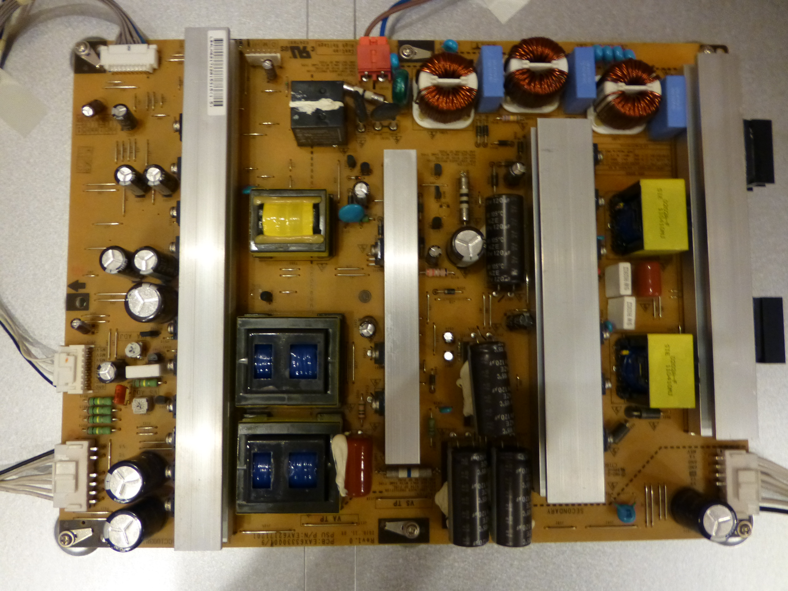

    Greetings, all, first post. I found my way here trying to find a replacement board for my LG 60PZ550. This TV is only three years old and hopefully can be salvaged.
    About a week ago, upon turning it on, the familiar click of a relay could be heard, and the, umm, "TV is off" LED went out (in this particular TV the LED is on when the TV is off ). The screen "glows", like it does when it hasn't "hooked up" with whatever source it's using, but that is all. No sound, no picture, and the TV only responds to commands from the remote (or on the front of the TV) by blinking the LED a few times.
    So here's my question: A replacement main board (an assembly of several boards, from what I can tell) is available on ebay for $90. For those of you who possess functioning crystal balls, do you think this is likely to resurrect the TV? My crystal ball is all cloudy, like my TV

    It would be possible to tell if the main board is bad in your set by doing a simple jumper test. You will need to remove the cover from the TV and get pictures of the boards inside of it.

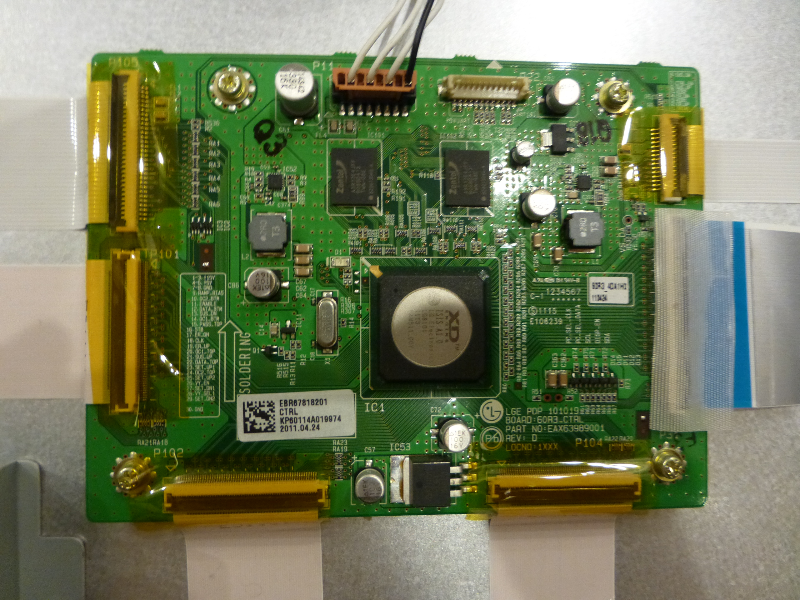

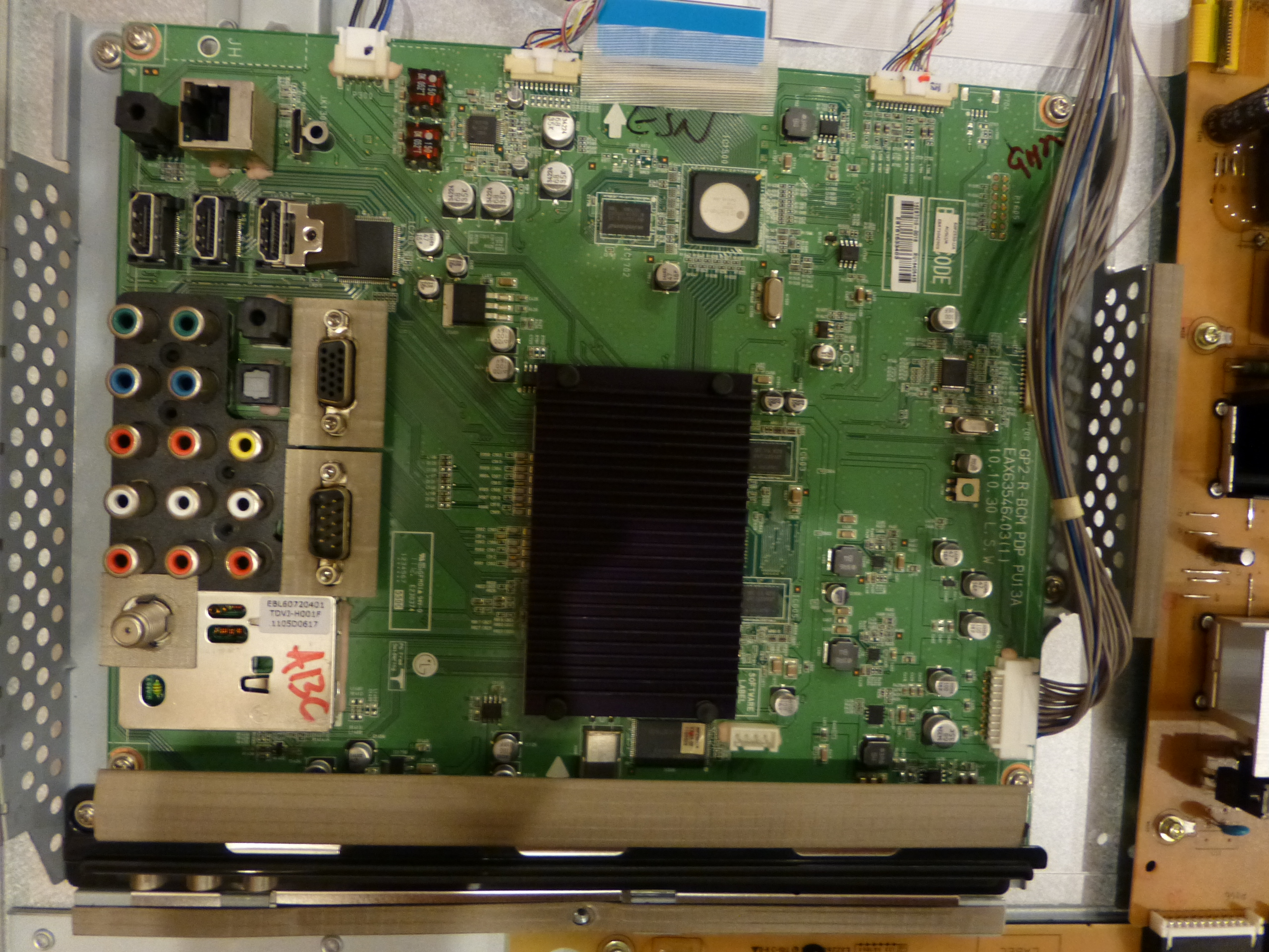

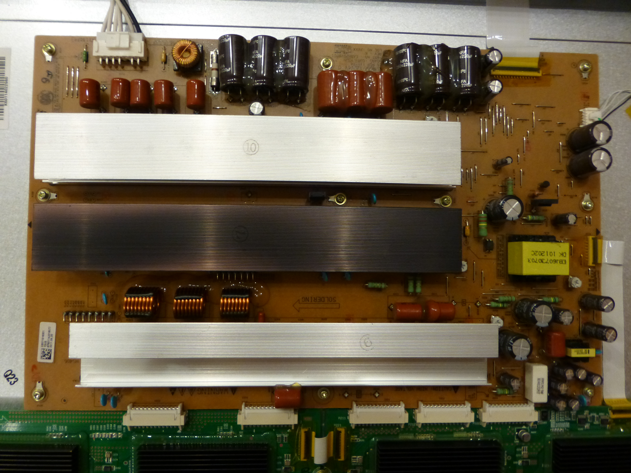

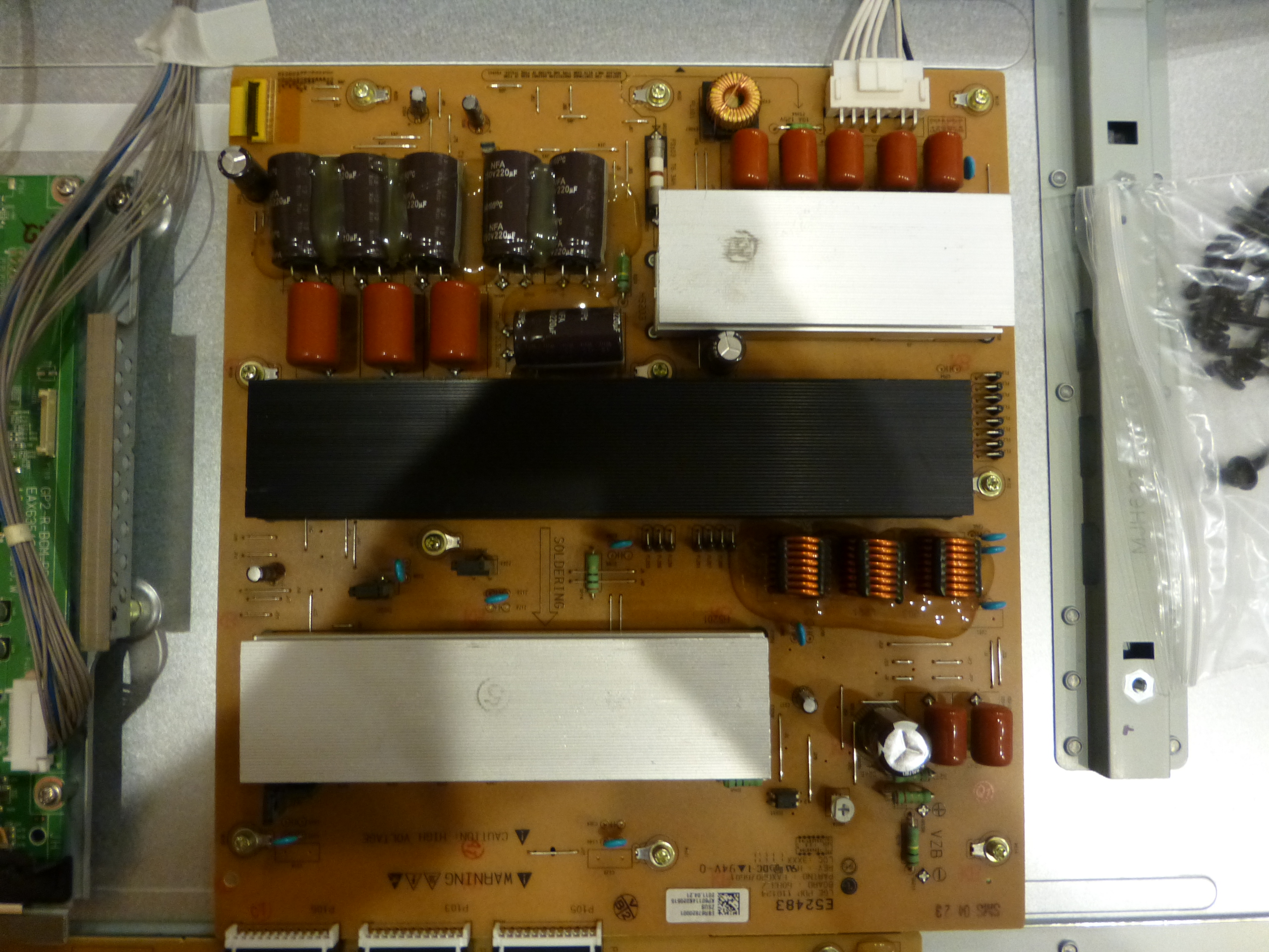

      Thanks for your quick reply. Finally got the pictures you requested. Sorry about having to be asked, I now notice the sticky that I should have read before I posted. Also I apologize for the quality of that last one, hope it's not so bad it needs to be re-taken.
      I really appreciate you folks taking the time to try to help me.

          Re: LG 60PZ550 glows but no picture/sound - happy ending
          Having seen no activity on my thread for a long time, I decided to buy a new main board via ebay at risk. It arrived, in bubble wrap, with absolutely no ESD protection whatsoever. And it worked just fine. I have a TV again.
            Sorry for missing your post!
            It's OK to bump a few times on this forum. Lots of people here now, and only a few regulars, including myself.
            The particular test involves putitng a wire across the points marked EXT AUTO GEN, and unplugging the LVDS cable, all from the control/logic board.
            If the rest of the set is working, a sequence of test patterns will show on the screen .This indicates the main board is bad in almost every instance.
                Might want to note: on your set there are no points marked EXT AUTO GEN but you can use the points between resistors R51 and R52 (in white print) on the CONTROL board.
