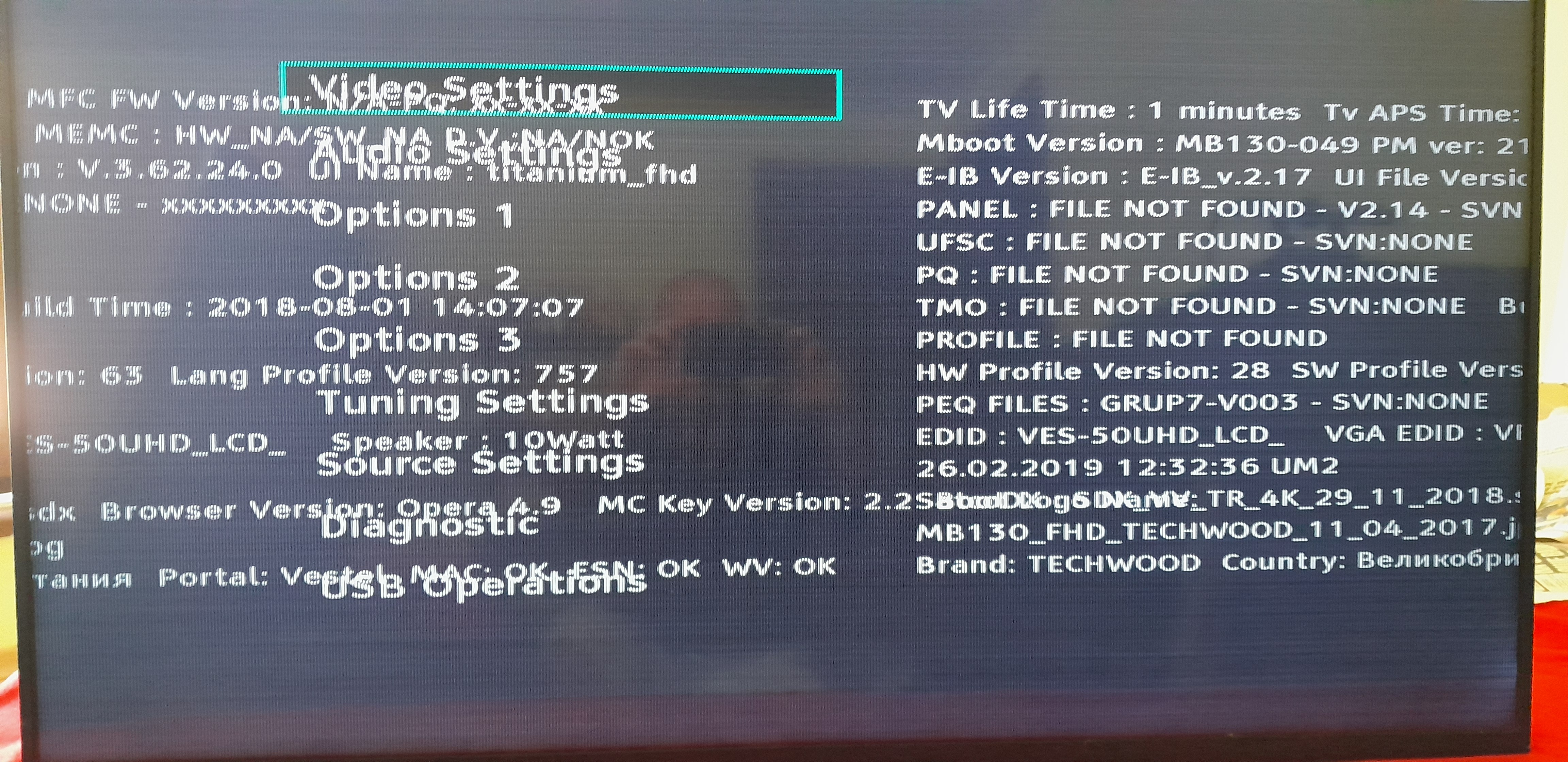

    Type MENU 4725 and put the resulting picture here.
    Save the panel profile from the TV and post it here.
    1. Format a stick with FAT32
    2. Create a folder called downloadpq.mb130 on the stick
    3. Turn on the TV and type MENU 4725
    4. Go to USB Options and type OK on the remote control
    5. After 10 seconds you can remove the USB stick and you will have some files on the stick.
    6. You post them here.

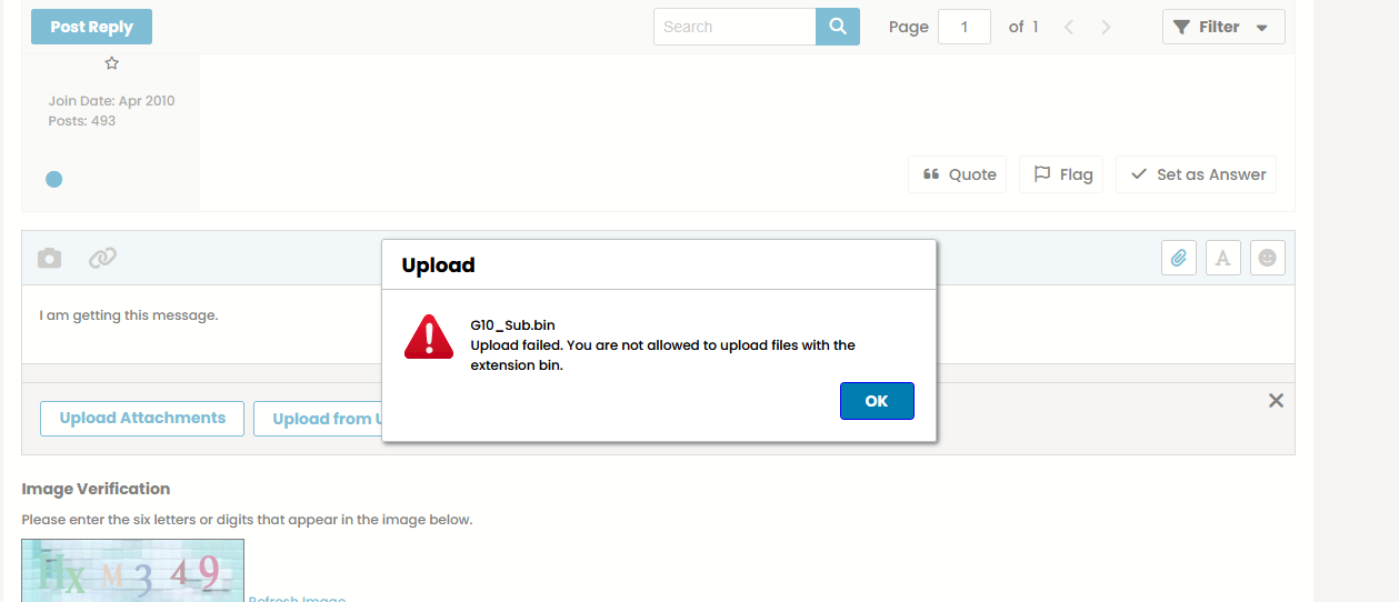

          I am getting this message.

            This is the link.
            • yokoono
              • Apr 2010
              • 511
              Archive the downloadpq.mb130 folder with an archiver (winrar, winzip) and attach it to the site.

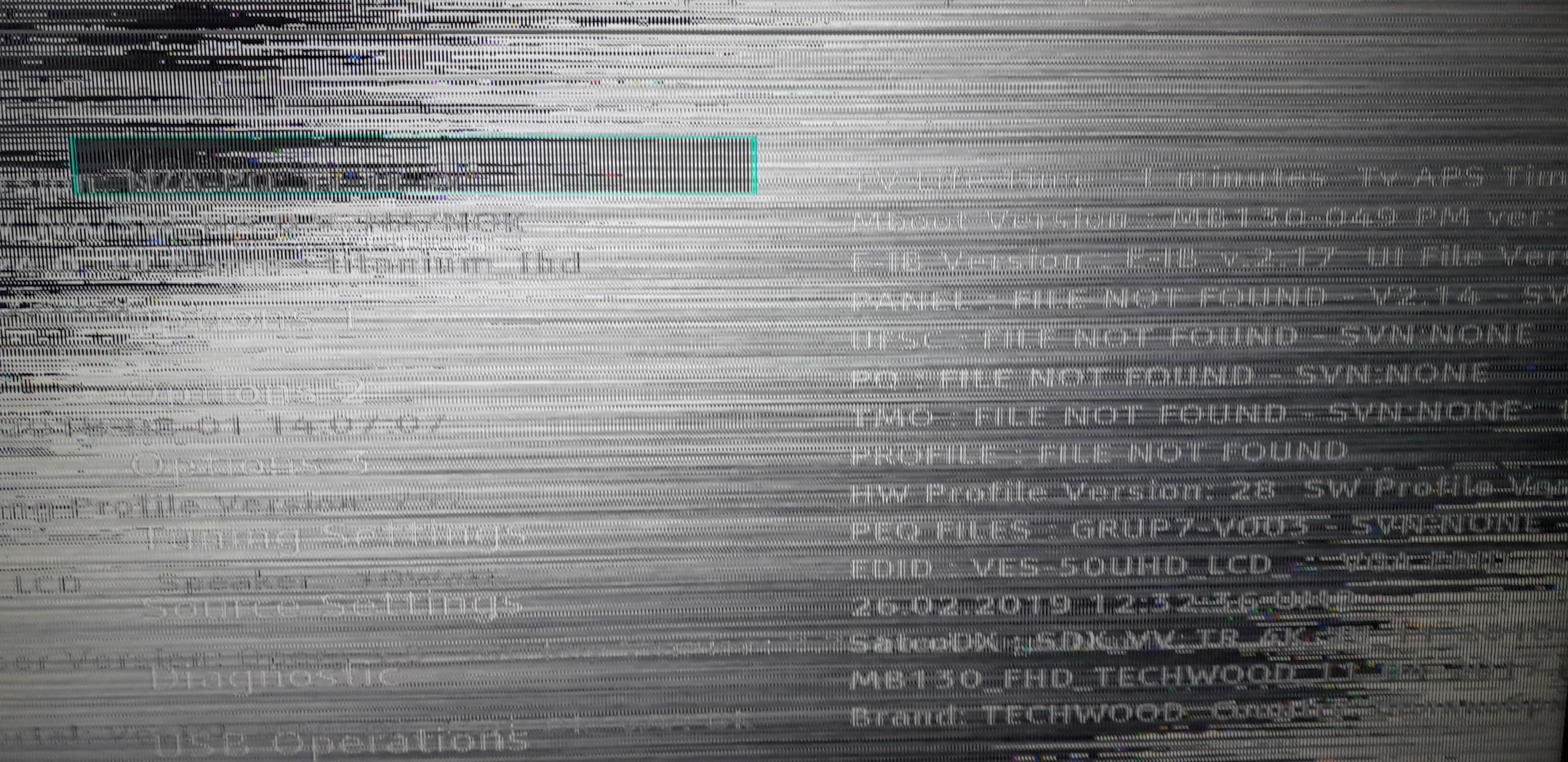

                  Try. 8 bits VESA

                  If the image is not correct, repeat the operation

                    I am a TV technician and I know the procedures. I have done many modifications, all without success. I need the PQ file for this particular panel. I find many files on the world wide web, but they do not match. I need this one. I got the image change, but it is not the correct one.

                      Try 10 bits JEIDA
                      • yokoono
                        • Apr 2010
                        • 511
                        Try 10 bits VESA

                          Thanks, this one is not suitable either. I have to wait for another TV with such a panel and clone it.
