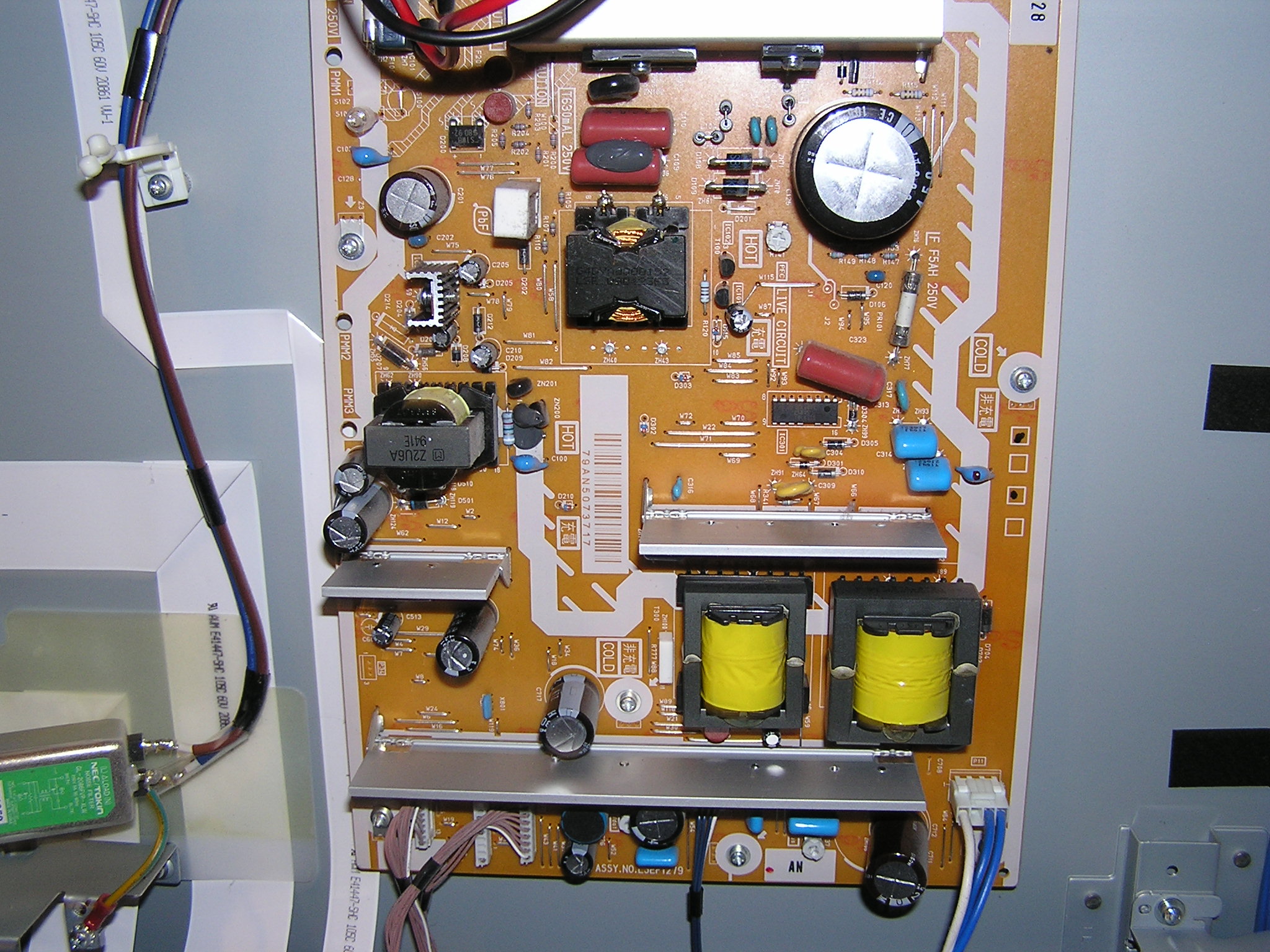

      Do you know how to use a multimeter? Are there any bulged or domed capacitors in the TV power supply?

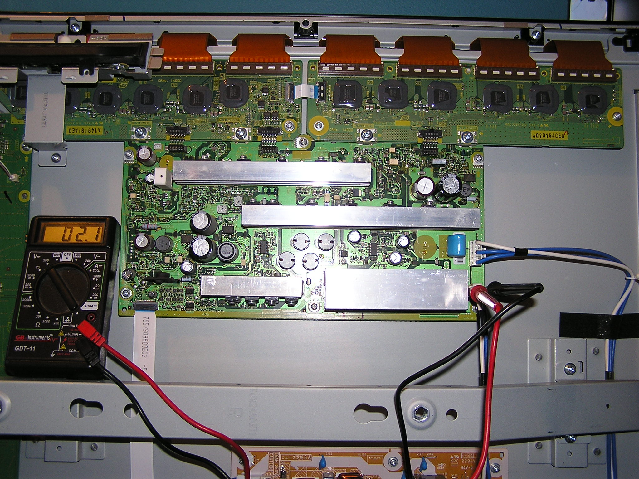

          Ya I have muilt-meter, skills are rather limited. Caps all look fine to me. Voltage from PSU is 193v on the board shown with the muiltmeter and then 173v & 193v on the orther board.
          How long of a pause? It will blink pause blink pause. Need me to shoot a vid of it?
          EDIT: Voltage will hold for a few secs, then drop out quickly after the relay clicks.
