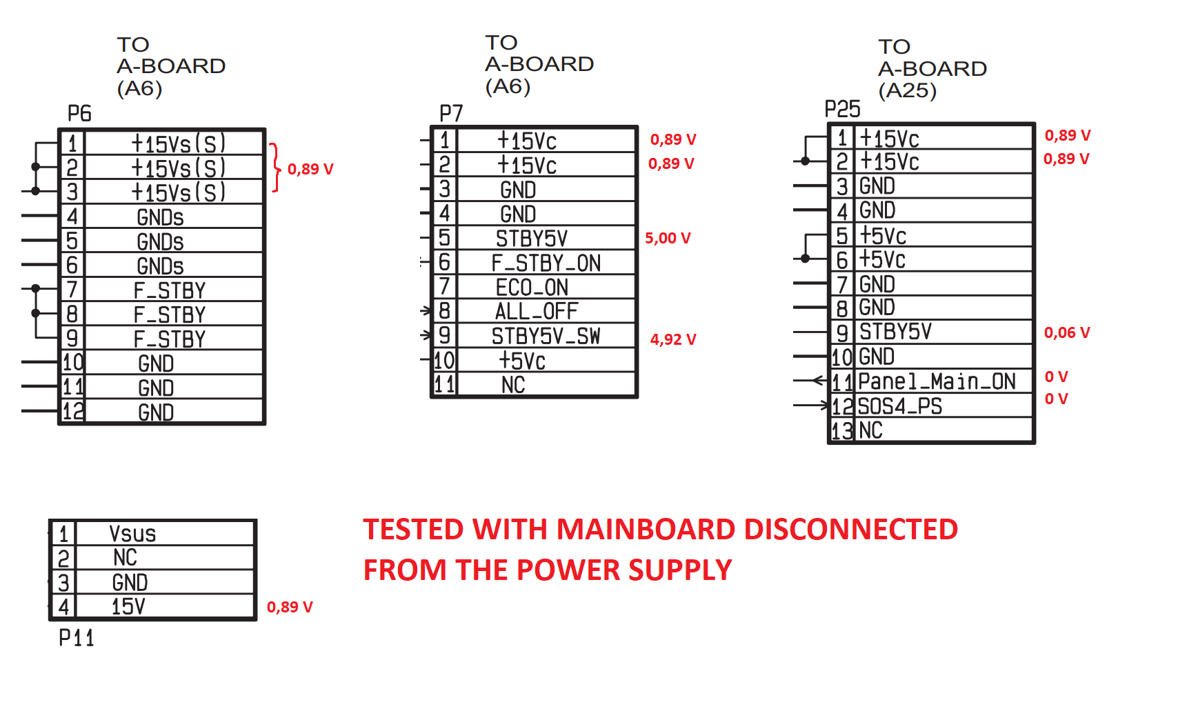

    Hello, I have an PANASONIC TX-P42X10Y Plasma TV, purchased new in 2009.
    Unfortunately plasma is not working at all after a power spike. Standby LED is not even working.
    I did some quick tests, YSUS + ZSUS MOSFETS and IGBT's are free from shorts, diodes on these modules seems to also be fine, buffer board is free from shorts as well.
    Anyway I focused mainly on the PSU, did some voltage tests with the results as below, I attached them on the photo (also please see attached PDF with the SERVICE MANUAL for this model, page number 43).
    I understand that to test the Vsus + Vda voltages, I would need to manually force the PSU with 1k resistors between ST-BY5V - STBY-ON pins plus ST-BY5V - PANEL-MAIN ON pins and with some high power bulb across Vsus and GND, right?
    I didn't try this yet as I am afraid that +15V voltage which I tested before, seems to be the culprit here, I am just not sure about it 100%
    On the PSU, I already tested: all diodes, all transistors, bridge rectifier, all fuses (7 in total!), capacitors (capacitance test + for shorts), varistors, high power resistors, both relays and obviously visually checked everything very closely and everything what I mentioned, seems to be fine, PSU is producing +5V correctly and now I am just not sure about this +15V voltage, could the mainboard control it, same like the Vsus + Vda voltages?
    Thanks everybody for reading.

        does that mean all tests done with mainboard disconnected, mainboard is what tells it to turn on, so like you have there you will only get the standby voltage with it disconnected.

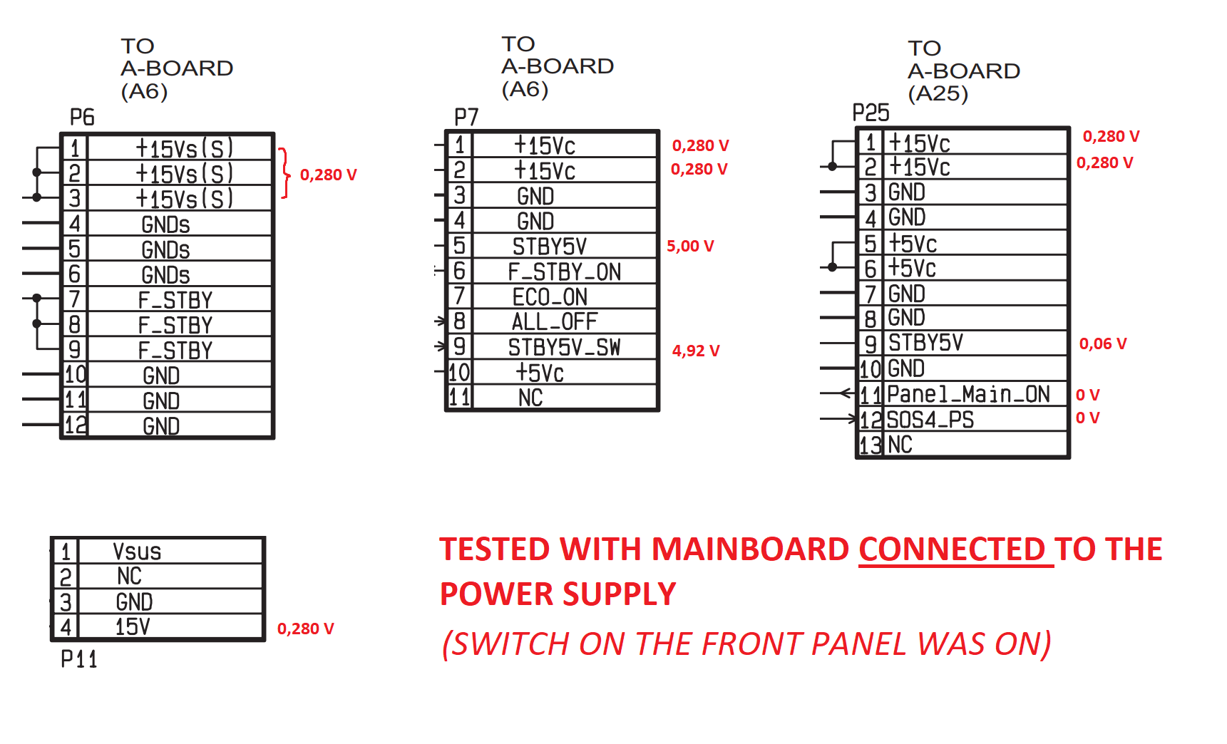

          Re: PANASONIC TX-P42X10Y Plasma TV damaged after a power spike
          I did two tests:
          - one with mainboard connected to power supply, +15V is 0.29V
          - second test with mainboard disconnected from the power supply, +15V is 0.8V
          Isn't this +15V a supply for a mainboard?
              Originally posted by tofik
              I did two tests:
              Why does the motherboard need 15v in standby mode, the motherboard should always receive 5v, and the motherboard puts the power supply into operating mode and then these 15v go to the motherboard and other boards.
                15V, VS and Vda only comes on when panel_main_on is HIGH, if it's not going it's the logic board or main board.
                  did you notice the green sos led on one of the boards blinking?
                  I checked it very precisely and no LED lights up at all, complete darkness on all boards.
                    disconnect the PANEL_MAIN_ON wire from A-board to psu and feed 3.3V into PANEL_MAIN_ON on PSU.
                    If that works your psu will have 15V, Vsus and Vda will work, but disconnect the sus-boards and vda in case of the main board sending a bad signal to them.
                    The main board processor or HDMI chip is probably shorted or very damaged, I say the psu is totally fine since it didn't blow the fuse.
