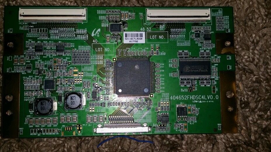

    Currently working on a Samsung 46" Lcd LN-T4661fx with no picture. Tv powers on,chimes, back light primes and stays on. I am getting no picture,menu,nothing. Just glowing screen. All my voltages are correct on ps. I cannot access service menu, info-menu-mute-power. Will t-con failure leave screen completely blank?

    Check the fuse on the T-con.

      Re: Samsun LN-T4661fx Main Board or t-con?
      Im not finding a dedicated fuse
        Bottom left of LVDS input. Small thing, next to the three brown caps. Probably marked "P". Very common failure on these boards.
          I found one labeled "T" directly above lvds input next to 3 caps. It is short/ground.
            What voltage do you measure either end? Red on one end of fuse, black on chassis, repeat for other end of fuse.
              That is the one, you use your meter in OHM mode and check the resistance of that fuse, each probe on each end of the fuse, no power to the TV of course. It should show same reading as when you touch the two probes of the meter together.
                12.97 v, reads 0.00 on ohms, same as probes touching.

                  Re: Samsung LN-T4661fx Main Board or t-con?
                  Shorted fet on the tcon, tv is working now.
