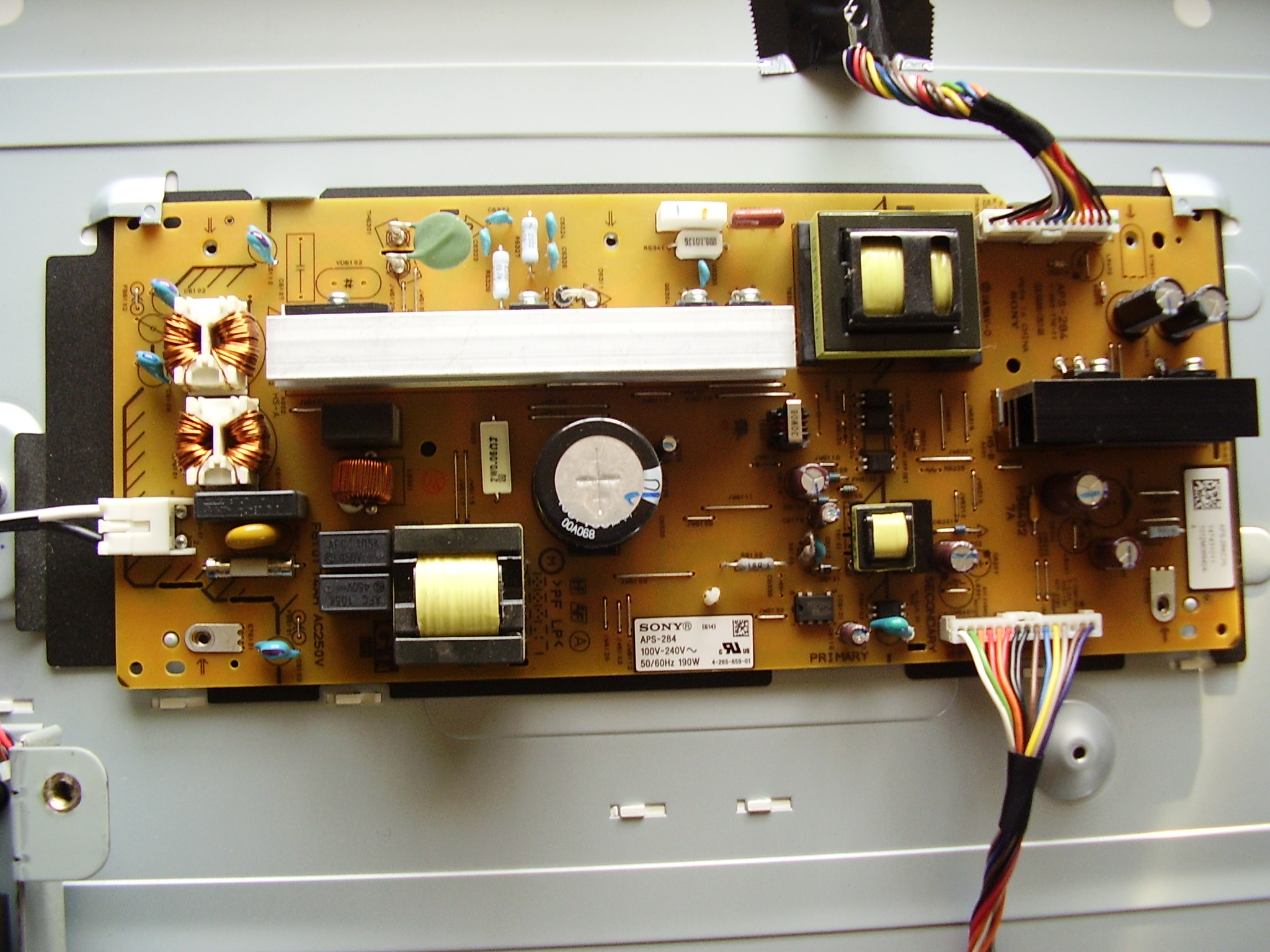

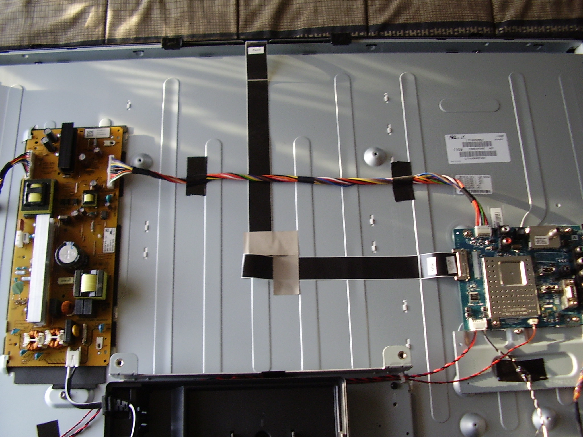

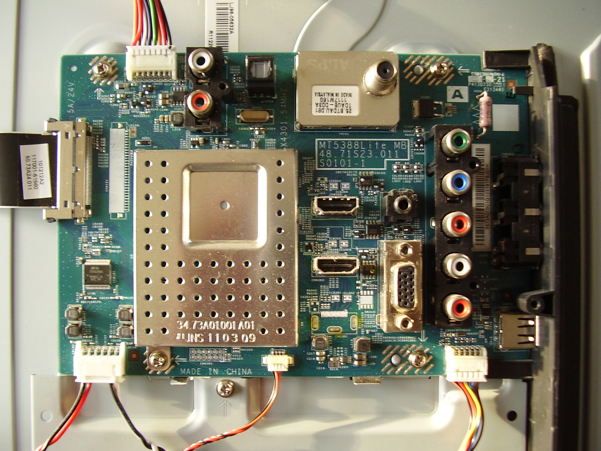

          I have the same problem, dead set, no lights but I have the APS-284 power supply in my 40" KDL-40BX420. The only voltages I have is the 3.27v stby but no indicator light in front. On the Ac Off Det I get .957v and when I push the power button it drops a bit to .854v . When I unplug the connecter the Ac Off Det goes to 1.94V. I also have 166.v going across the 450v cap with no change when I push power button.
          I first thought it was the main board so I replaced it with another used board but no change, Still dead. Any thoughts? I could have gotten another bad main board or it was the power supply all along?
            #45
            Re: APS-254 power supply on a 40" sony

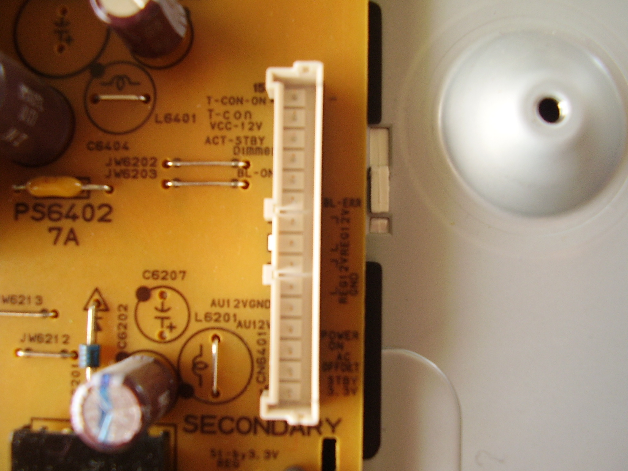

            If you look at the diagram for the AC OFF DET [in to be high (close to 3VDC), the LED (pin 1 & 2) on the transmitter side of OPTO ICPH6101 has to be off, so what you can do is to short pin 1 and pin 2 of the ICPH6101 to see if the AC OFF DET pin will go high, or you can remove the OPTO.

                Yes, the OPTO IC has 4 legs, per diagram:
                https://www.badcaps.net/forum/showpo...52&postcount=4
                Per diagram, it has PH6101 designator, the P/N of the OPTO is PS-2561A.
                Just look up the spec sheet of PS-2561.
                  #48
                  Ok Budm when I short pin 1 and 2 the Ac Off Det pin 2 on the connector goes up to 2.70v, What does this mean?
                    #49
                    It should, so it means the LED inside was on so when you shorted out the LED to turn off the OPTO so the output side of the OPTO swings HIGH toward 3.3V. So if you jumper in place, do you still any error code or does the TV will now startup??

                          standby is 3.3vdc,
                          ac_off_det is .14v without bridge pin 1 and 2 of ph6101
                          ac_off_det is 3.3v with bridge pin 1 and 2 of ph6101
                          pow_on does nothing when power button is pressed with or without pin 1 and 2 bridged on ph6101 and no lights/led show

                              The Ac det should be 3.3V. or more without jumper if the detector circuit, so you do have power supply board problem.
                              In post 49, we were trying to verify the opto isolation function.

                                        I got this TV yesterday, I have the same symptoms, dead & no blinking power indicator. My Standby is 3.3 vdc and my AC Det is 3+ vdc so I guess that means I have a good power supply and a bad Main. My PS ON does not change when I press power. Main board seems to be completely dead.
