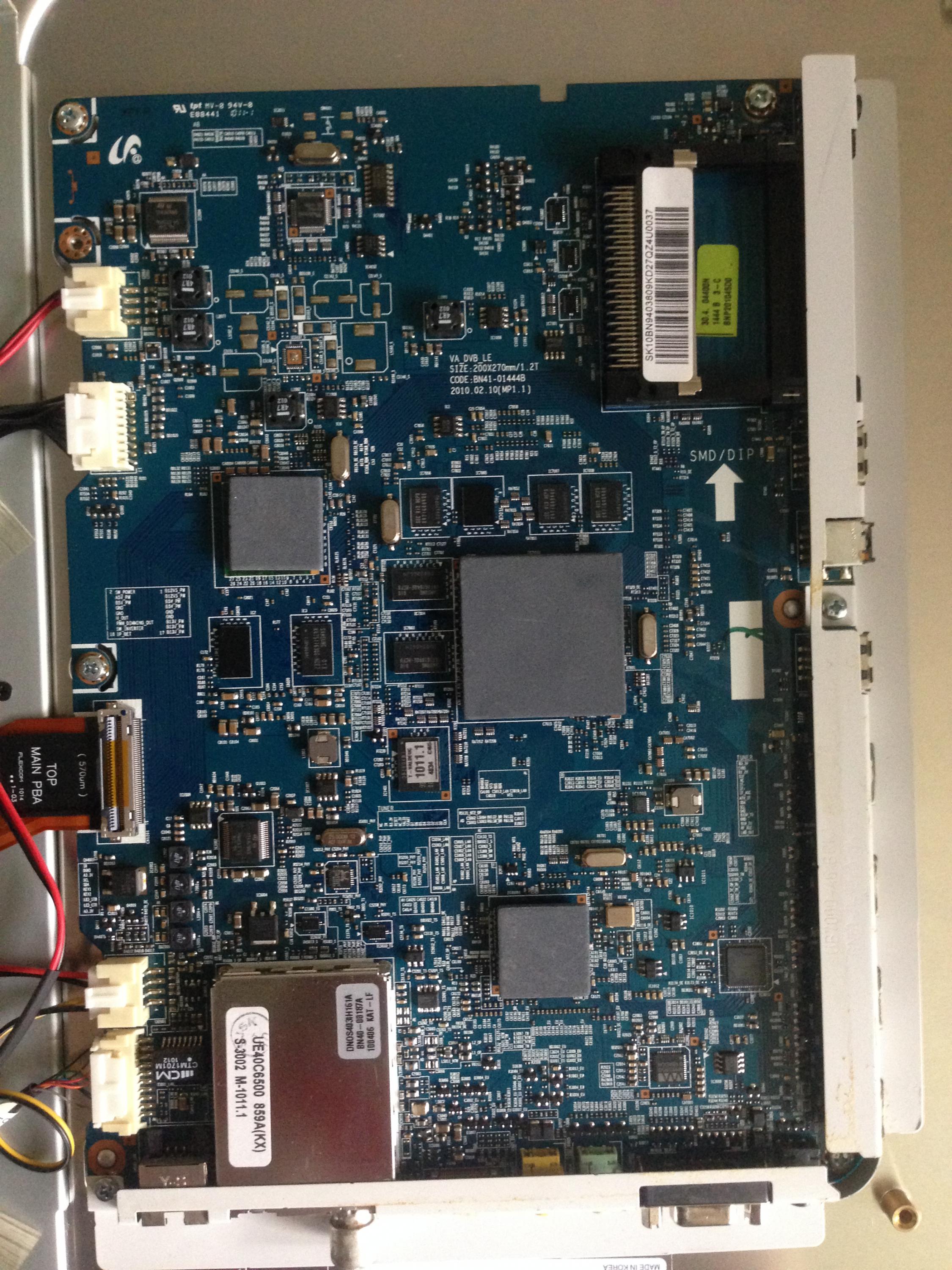

    First time opening LED TV, not going to spend much cash on it, as i think a tab bond has gone. (Hope not though!!)
    Internals:
    Panel - LTF400HJ03
    MainBoard - BN41-01444C
    PSU - BN44-00357A
    Inverter - (Unsure at the moment)
    T-CON - S120AMP4C4LV0.4
    Just opened this up and had a good look around, nothing obvious! Unit will stay powered up and can see picture, and sound is present.

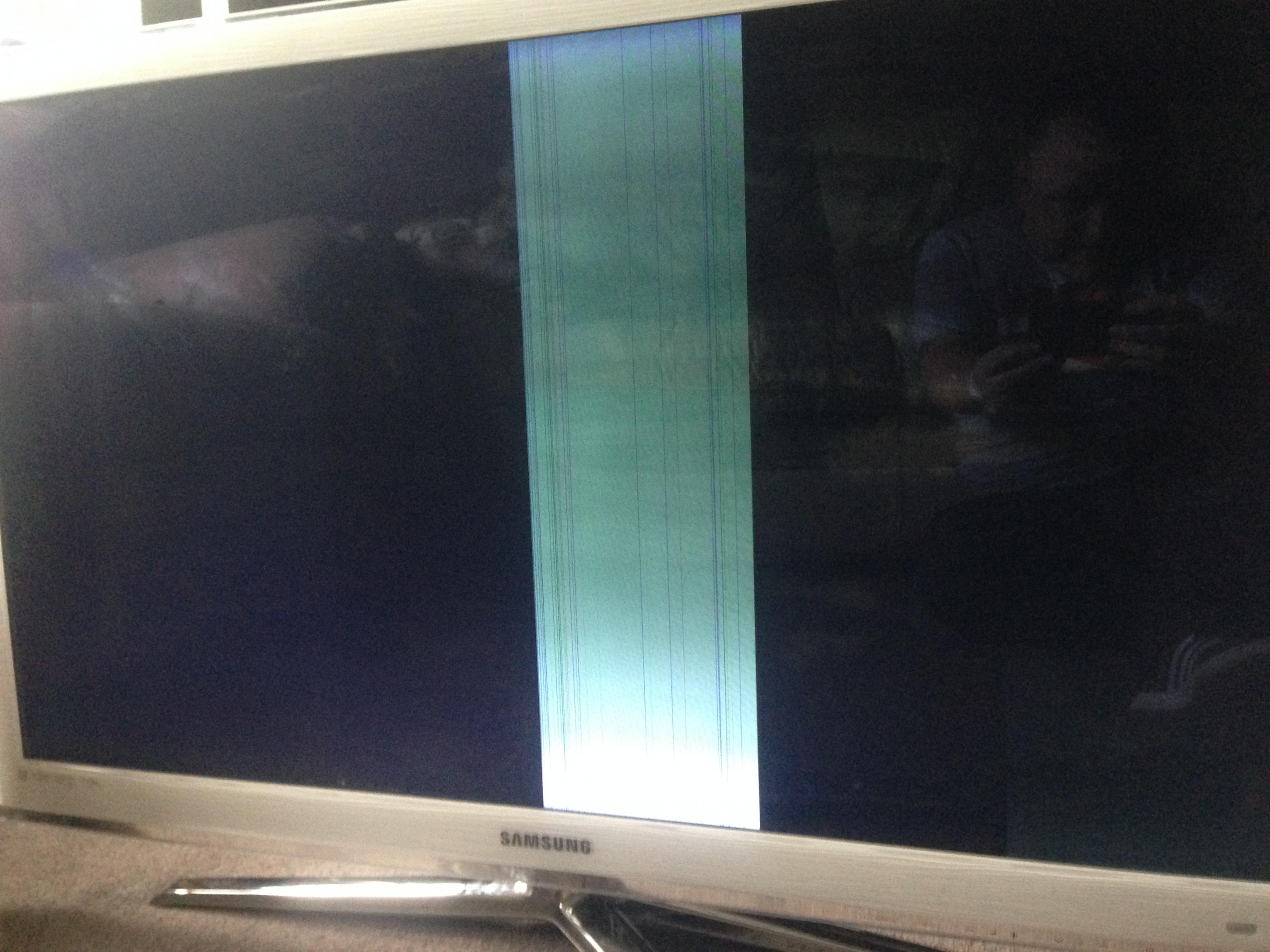

    Picture can be seen on the left had side of the panel only, need a torch to see it though.
    Anyone any ideas on where to start?

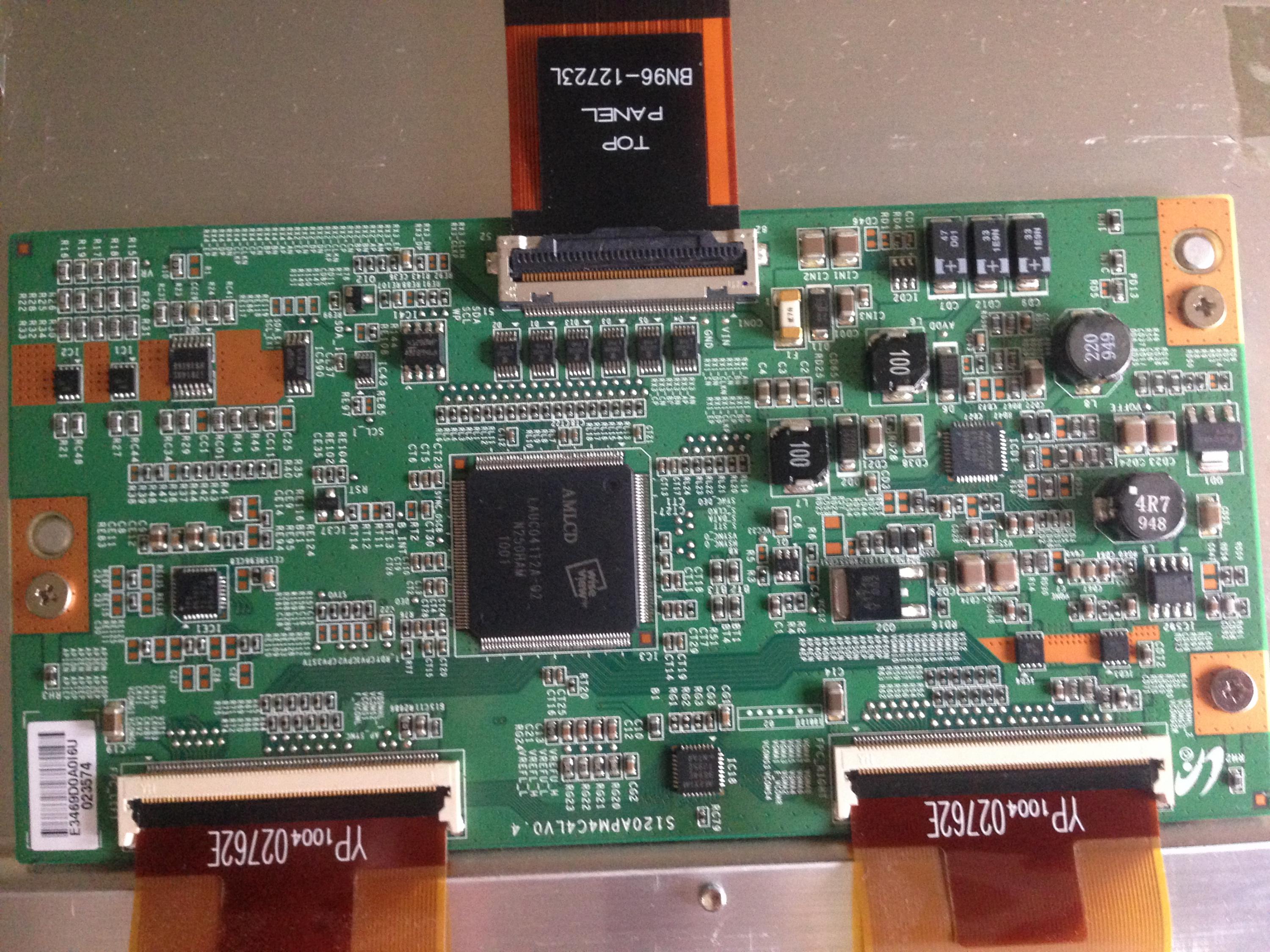

    Remove clean and reseat any cables. going to the tcon/panel pictures of the inside might help. Could be tcon or tab bonds - tried pressing gently on them?

      Will there be multiple tab bonds along the inner most part of the LCD? Not stripped one down that far yet, usually swap outs and component changes. Hopefully get down to some proper component level debug soon as possible.
      See pics >>

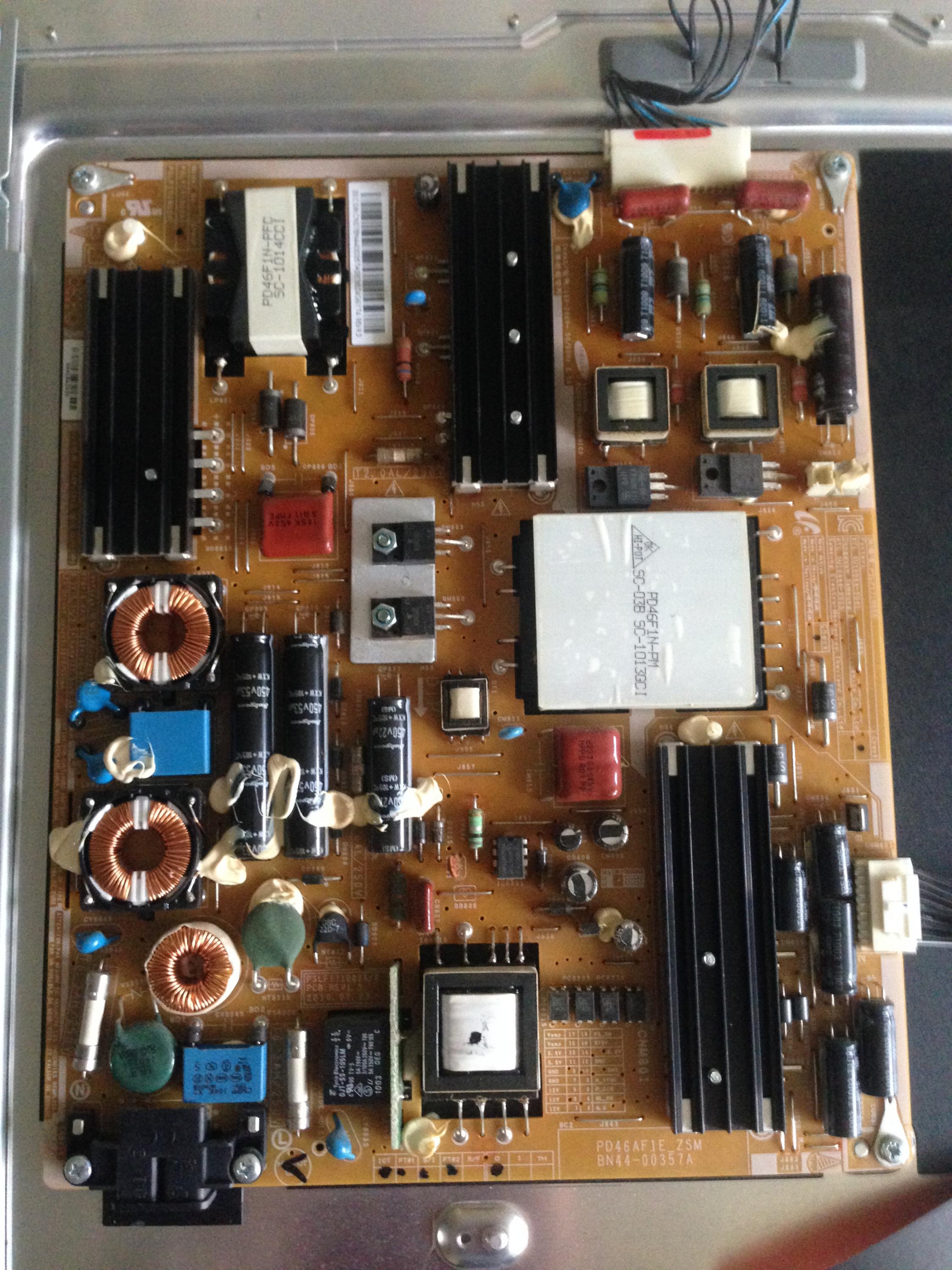

        2 voltage regulators in pic 3 may be QD1 QD2 to test. post result with part nos

          The C Series range of TV's is plagued with bad main boards (And T-con boards in my experience...) Of the 4 i have had; 3 of them had bad main boards, 2 of them had bad T-Cons... (one of them had both!)
          Once you have cleaned all the cables, unplug the right hand side of the T-con to the screen and see if it makes a difference...
          If you want me to test any of the boards for you, let me know - I have one of these on my bench right now with semi-faulty boards...

              May be easier to diagnose with a signal but if after unplugging Tyner remaining side turns good, you know you have either a screen or Tcon fault...

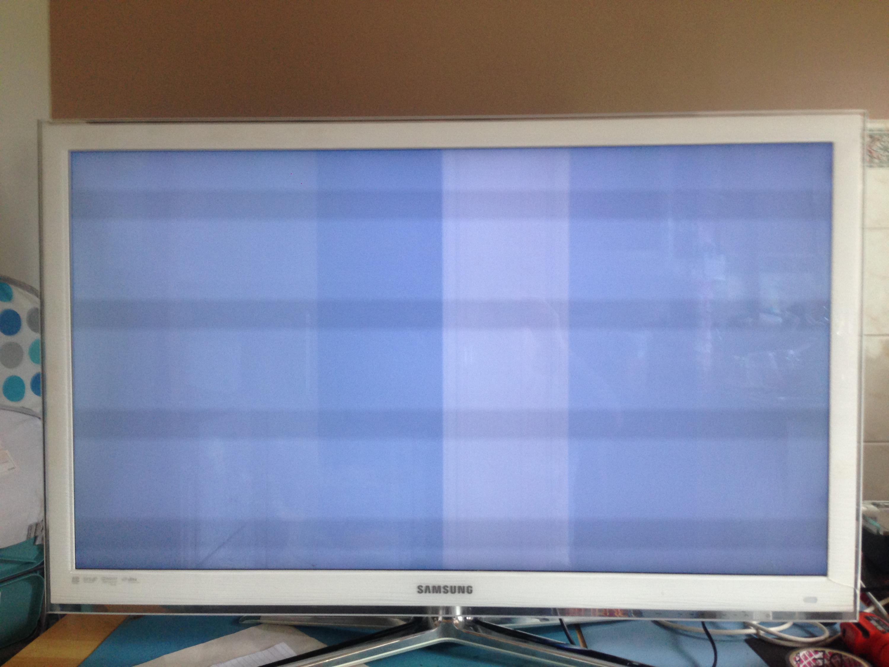

                        I have taken the metal frame that holds the matrix and screen came back to normal but with horisontal this time disturbances. I have put back the metal frame and half black screen returned.
                        Is it a problem with T con? If so, what would be the next procedure?

                            Partially solved.
                            Flat cables between T-Con and matrix were oxidated and there was poor contact.
                            After that picture came back to almost normal. You actually can see the difference between left and right side of the screen, espetially on darker tones. How can I fix this?
