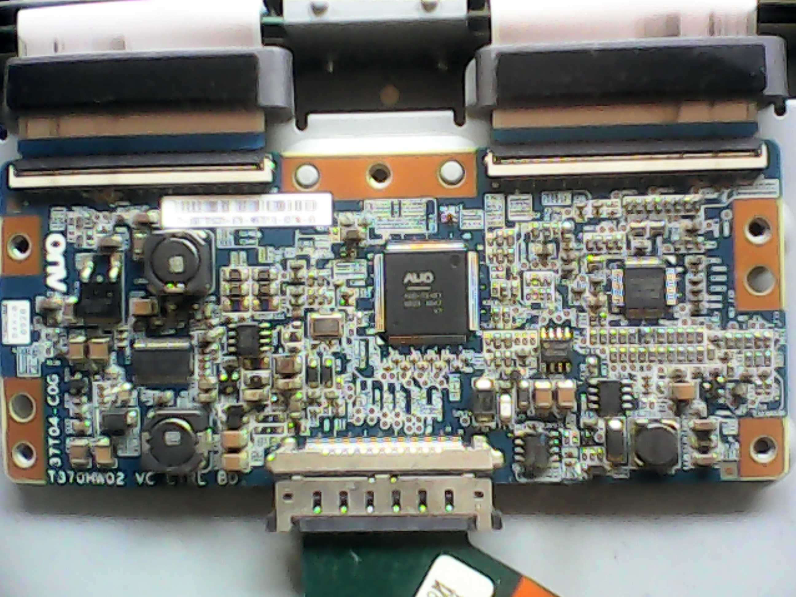

    I have a Samsung LA37B530P7R, since a while ago the screen became very bright and i couldn't find any solution.
    I replaced the T-CON board, but the problem still persist.
    Hope you'll give me some ideas how i can solve it.

    OK, on the right hand side of your T-CON board (this board: https://www.badcaps.net/forum/attach...9&d=1408350851), you have a few points marked VG1 through VG22. They are scattered in different places. These voltages represent the gamma curve. Can you test these voltages and report your readings? Use a digital multimeter set to the 20V DC range (or auto-ranging DC volts if available.)
    This is a common fault with these sets, it is quite likely you have been sold an untested, faulty T-con. (Despite sellers claims that they are tested, they rarely are!) The repair involves replacing IC U500, 48 pins QFP.

        Re: Samsung 37' LCD LA37B530P7R White picture
        Looks like the gamma voltages a off....
        Funny thing is--I did exactly one of those boards yesterday, although the picture was dark, overcontrasted and very horrible colour.....
        AS-15F chip, known as the gamma reference chip.
        'BTW Tom, I tried a 'F' suffix in place of its 'G' and worked fine....

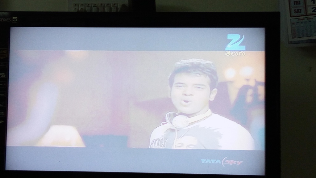

                    I have the same problem with my 37 inch LCD TV. (1st attachment)

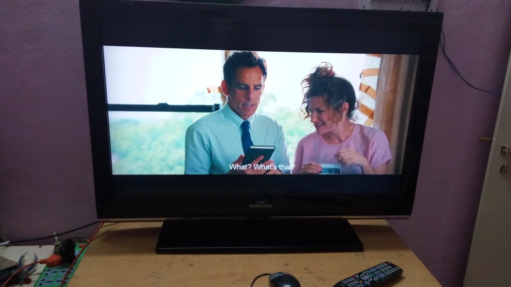

                    After reading this thread, I ordered AS15F chip on ebay.in.
                    Its price is around Rs. 350/- (approx... 5$). I dont know SMD soldering. I took it to a nearest cellphone repairing center and he took Rs. 150/- (approx 2.1$) for soldering.
                    I connected the board as it is and it is working great. (attachment 2)
                    In the second picture, I removed the panel sticker.
