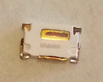

        I still have some of these leds if anyone is interested in trying to replace them individually. If so shoot me a PM.

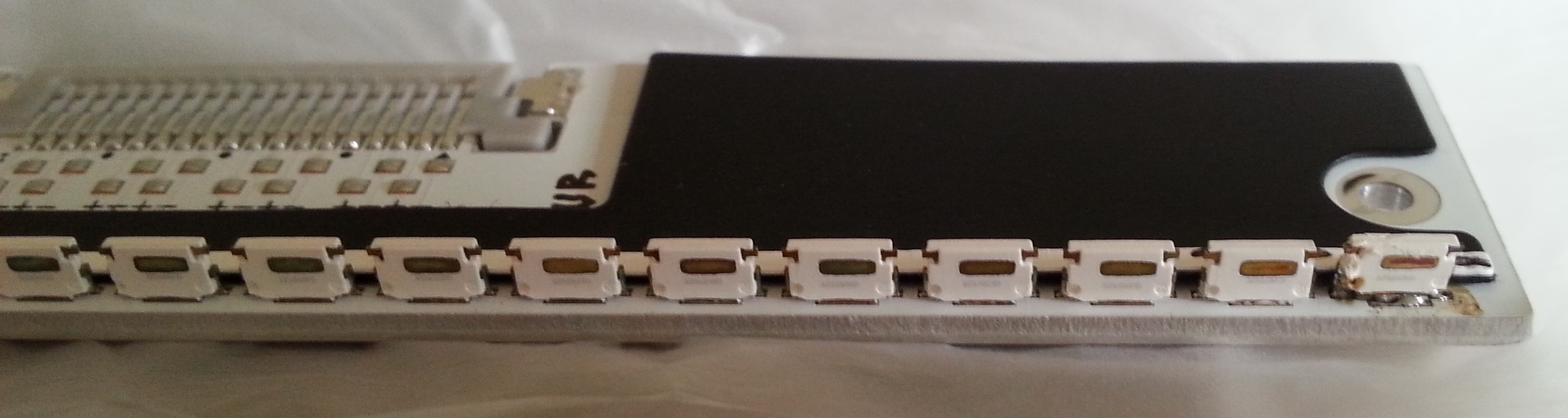

          I have a set with no obvious LED failures but I'm leaning towards bad solder joints / fractures.

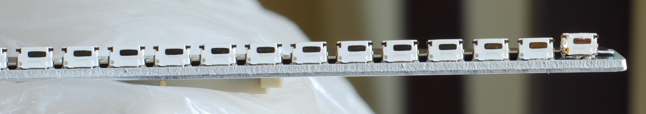

            I'm not going back in there, what I've done is jumpered the first 6 LEDs on the right banks and one on the left.
            Had no idea these fitted in a very narrow opening and got damaged which explains why we had a sudden fault state change.
            I don't know how you reassemble this but we're probably going about it wrong
            Anyway after 6 gos and some damage it's back and running. Not sure how it's going to go in the long run. I did expect either it to fault or burn out with 6 missing in series.
            I looked at the backlights SJ had for a US D7000, neither look like mine .
            I should have taken a photo but they are mounted a 90 deg to the borad assembly.
            Are the LEDs you had are they SMD flat or have the solder pads on their sides?

                            have you come across any 5030 LEDs which are vertically mounted(pads on their side)?
                              I think these are them. No surprise Samsung brand. Picture is not great
                              http://translate.googleusercontent.c...scG9tFMgSlI3dg

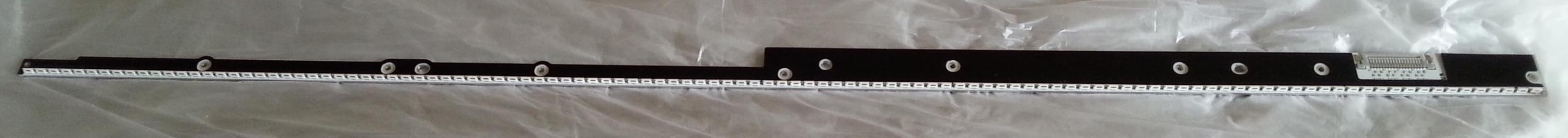

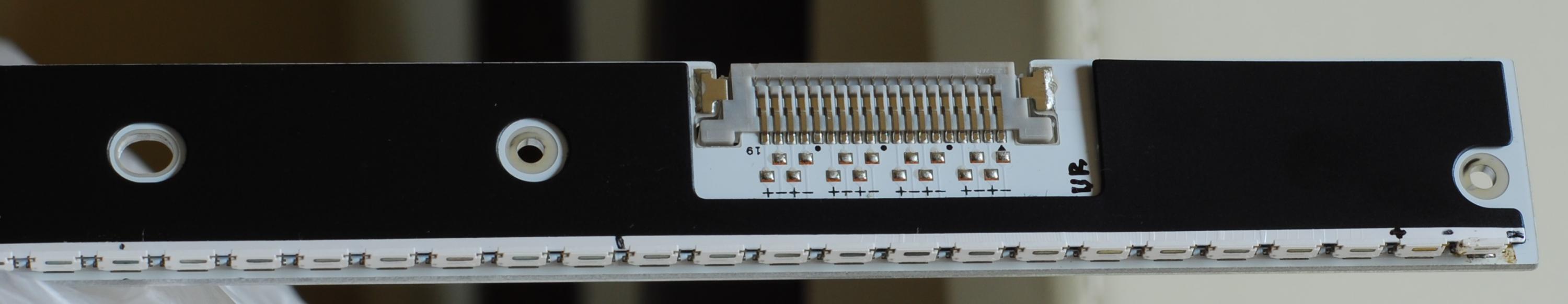

                                    I striped the UE55D7000 panel apart and I found two LED strips, one on the left and another on the right.
                                    The strips are like tw2005 described, a metal plate wit a LED strip glue on it. The LEDs are mounted vertical on the strip. See picture attached.
                                    Anyway I found one LED with bad solder (joint fracture) on the right strip, and it fall off when I touch it. All other LEDs seam in place and working fine when tested individually with the multimeter.
                                    I tried to solder the one that fall off, but like tw2005 said it is no easy as solder must be applied between the LED and the strip...
                                    Well, not my best job, but it should be enough to keep LED in place.
