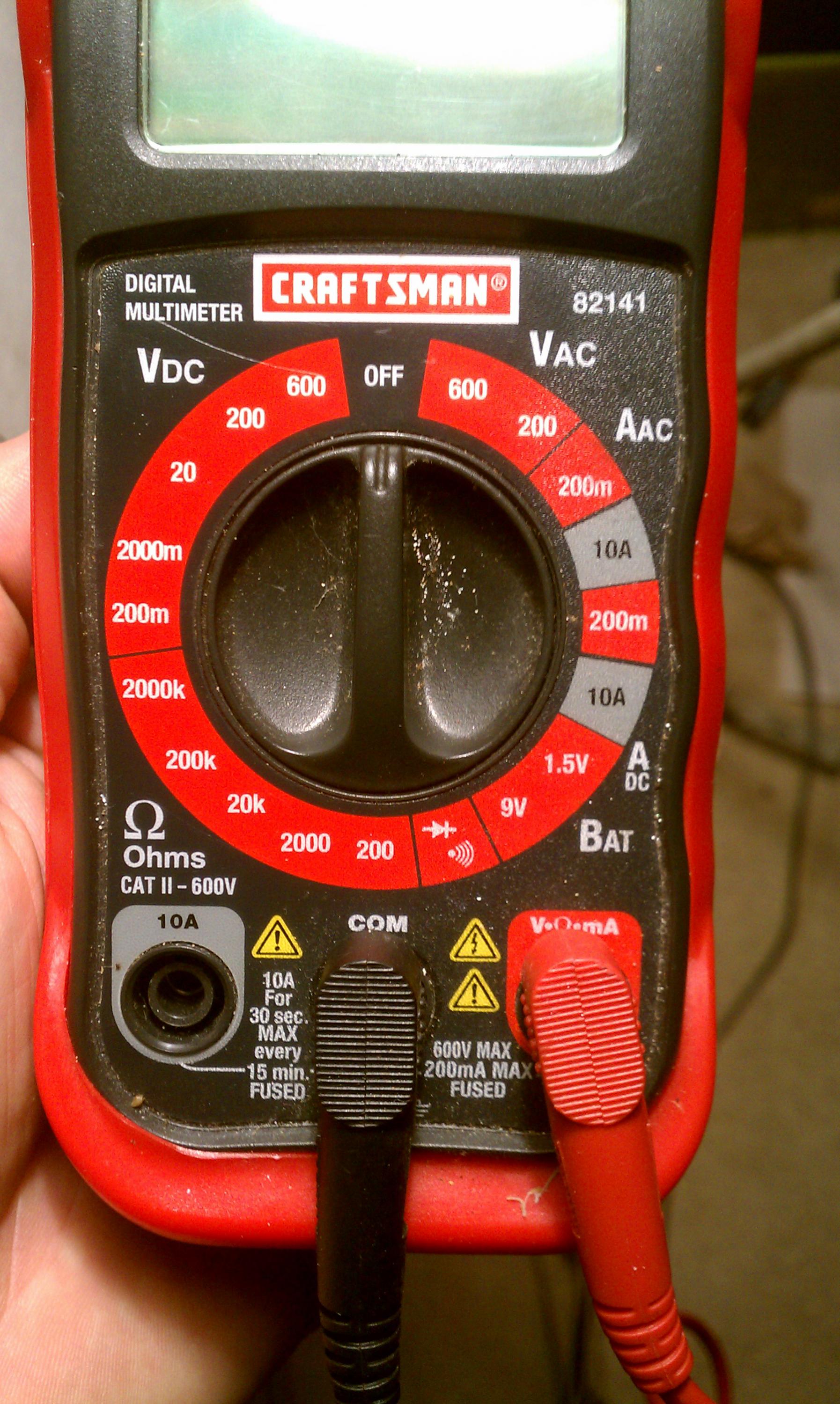

      BTW, what are the DC A scales do you have on your meter? Can I see the picture?

        heres my voltmeter

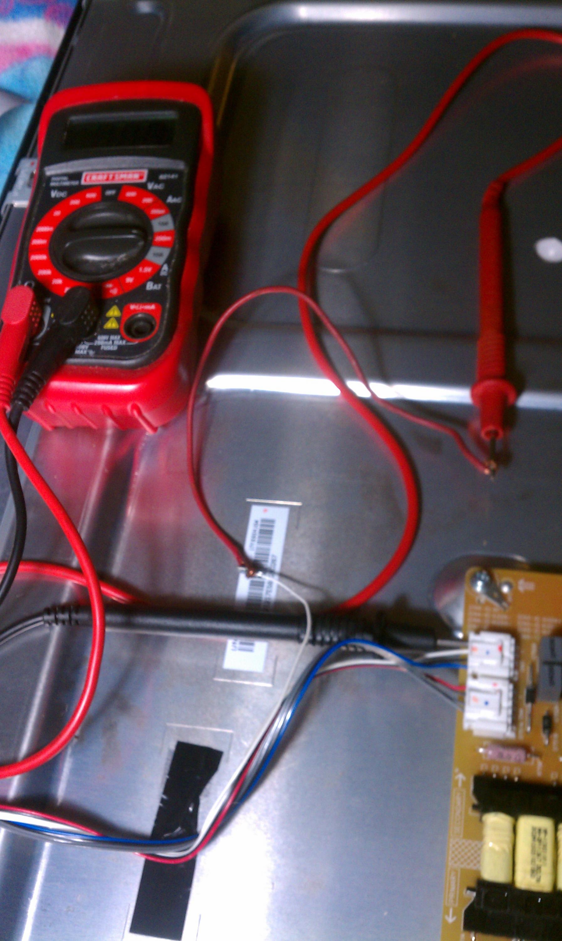

          OK, put the meter on A DC 10A scale, you will have to move the red probe to the 10A socket, too bad your meter does not have 2A scale, hopefully it is sensitive enough to see some action on the meter.
          You will have to cut the wire one at time on the connector CN3, the wire should be cut so you can splice the wire back together.
          You can start by cutting the wire on CN3 PIN 1, then strip the wires so you have expose conductors, then you will put the meter probe on each expose conductor, you should wrap the conductor on the probe tip and tape it up.
          Then turn one the TV, if the LED string does not have open circuit you should see the reading jumps up before it goes into shutdown. You will have to do the same on the other 3 wires as well to see which one show no action on the meter.
          As you can see in my picture, I use clips for making connection, the reading on my meter shows around 300mA, your meter may show something like 00.2 or 00.3. BTW, do not worry about the probes polarity.

                i didnt want to cut any wires so i figured out this way of doing it instead. i just removed the wire from the harness and wedged the probe in there
                and then used a bit of wire to splice the other probe to LED wire. i used my other meter to test continuity between the black probe and the pin to verify they are indeed touching.
                but on pin1 and pin2 of CN3 i still see no activity on my meter in 10a or 200ma
                the only thing i noticed is sometimes the negative sign flashes for a moment on my meter

                  The negative sign is just telling the direction of the current flow, what we are looking for is the inactivity of current flow when the circuit has open connection due to bad LED that has gone open circuit in the LED string, the protection circuit monitor the current flow through each string and maintain the constant current flow to give steady backlights, if the LED goes open circuit, the voltage will rise, then the protection circuit will shutdown the LED power supply.
