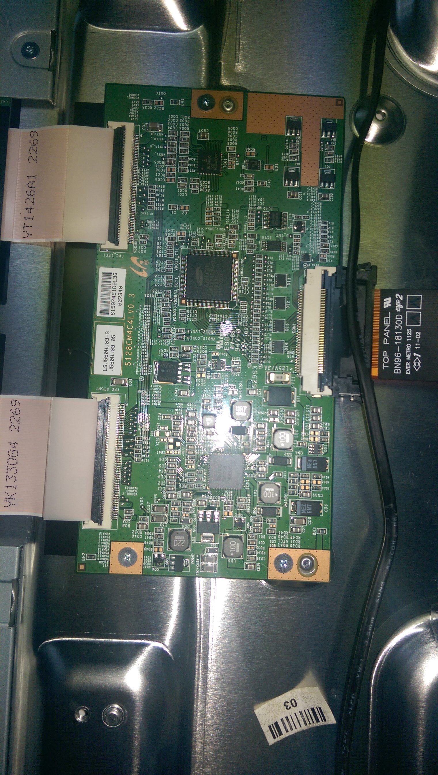

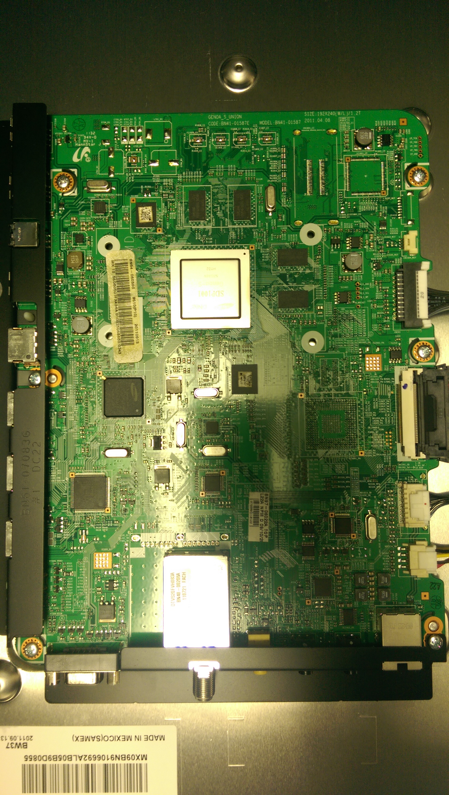

        Do you have a camera to take photos of the boards in the set?
        • hooger
          • Aug 2014
          • 4
          Re: Samsung UN55D6050 Audio but Black Screen
          I have just arrived home, and I will upload the pictures now.

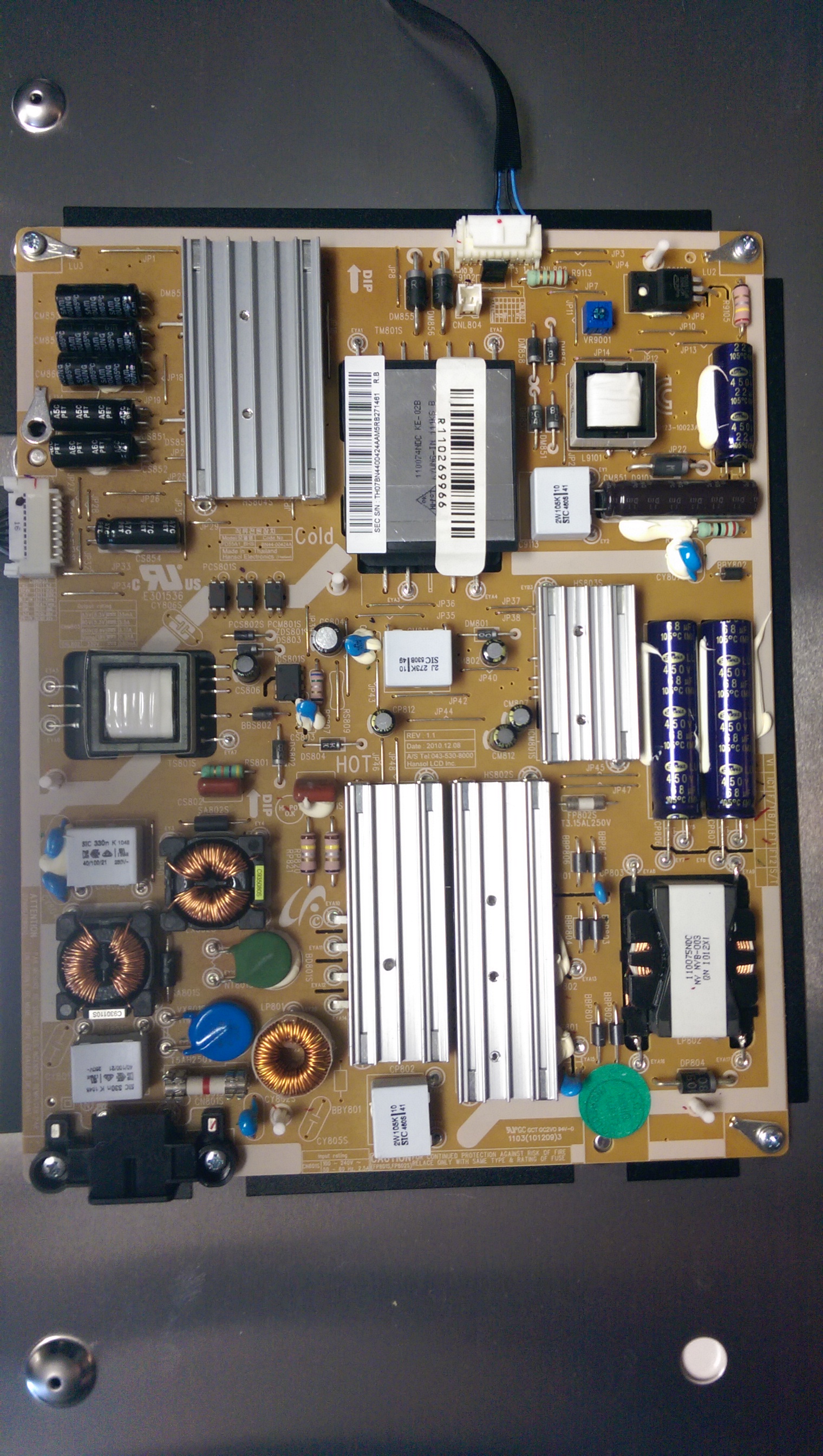

          Also I talked to the guy I got the TV from, and he said he had this TV repaired for the same issue back when it was under warranty.
          The work order for it says:
          "Screen would go black, sound ok, then screen will come back intermittently"
          It then says the part that was replaced was a BN44-00424A SMPS, is it safe to assume that since it's an identical problem I should be able to buy the same board and swap it out?
          • tibimakai
            • Jan 2012
            • 3680
            Every time I hear about D series, I'm thinking about bad panel.
            I wouldn't spend a dollar on it yet.
            I would make sure, that all the voltages are there first and everything works as it should.
