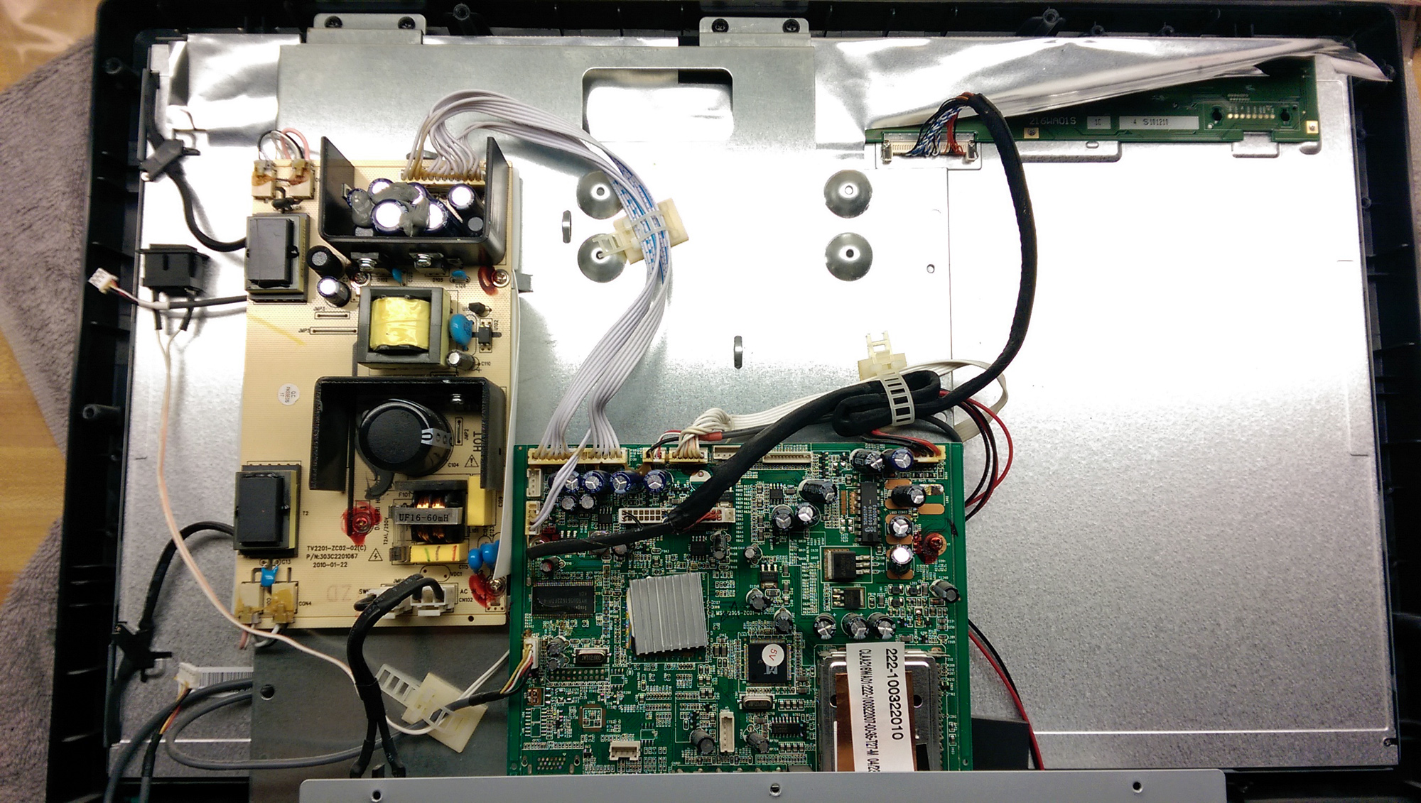

    My nephew's TV is sitting on my bench-dead.
    It seems similar to 2 seconds to black except no image or sound. There is snow on the screen once it turns black, if viewed with a flashlight. It has no sound, and the power light stays green. The menu button seems to work, but not the source button as far as I can tell. I don't think it can be assumed that the main board is good, so do I need to suck it up and buy a main board for him?

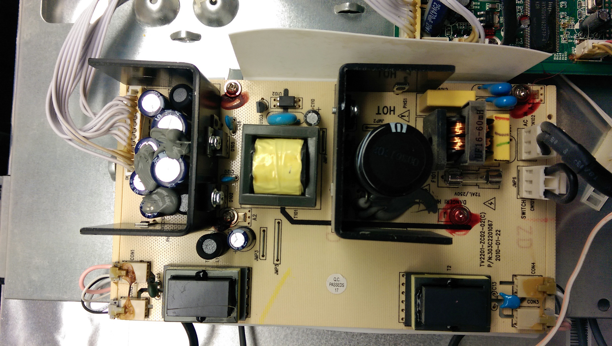

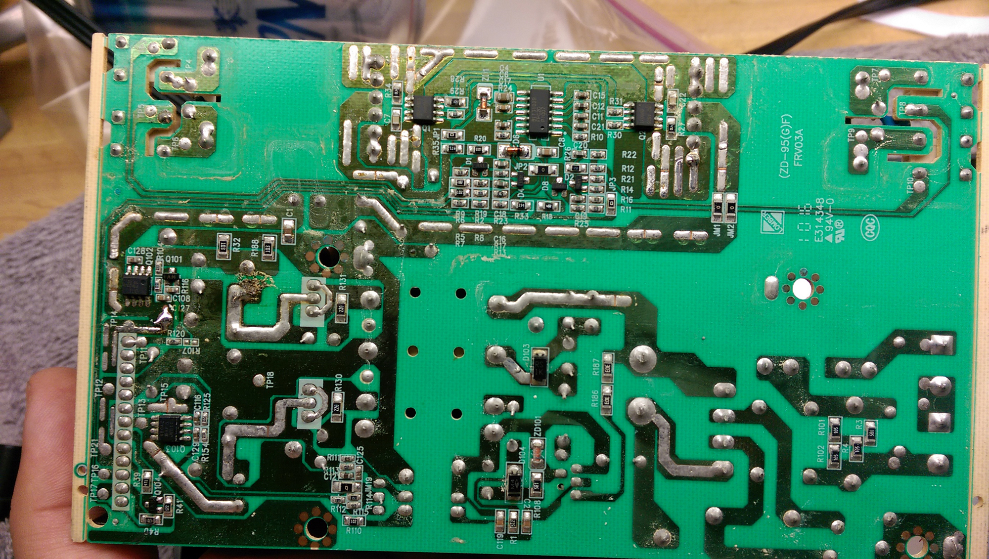

      Need a picture of the back of the power supply board.

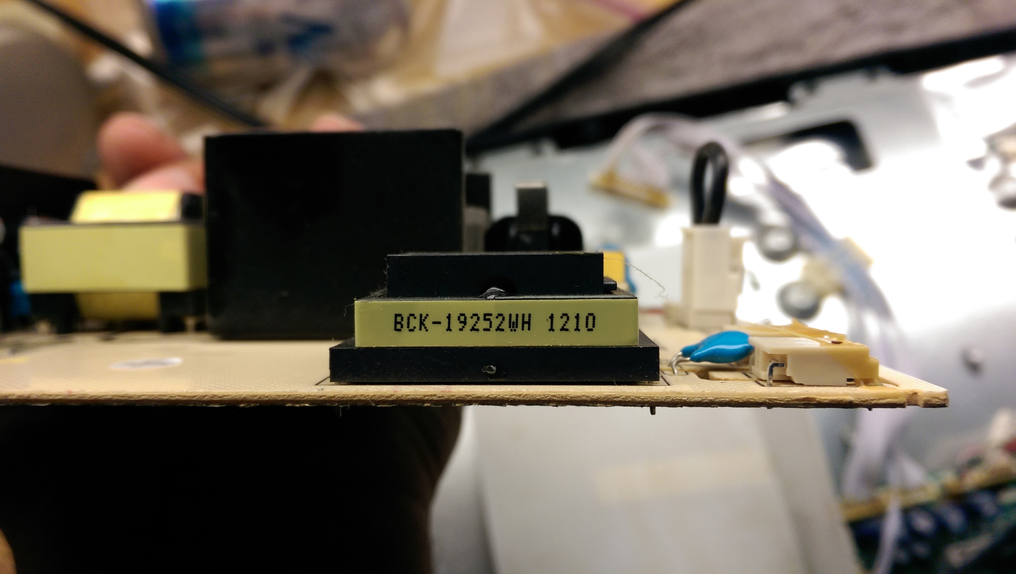

      and the number off theside of the inverter transformers - T1 and T2

        yes the power light stays green. I have just started on that link. "bck-19252wh 1210" is the number on t1 and t2

          Ok First can you get a brush and brush off whatever is on the board - hasnt had a liquid spill??
          No power to the board Meter on ohms 2000 test TP6 to TP4 and TP7 and TP9
          Top corners of the board (in your back picture)

            it doesn't look like a spill looks like sloppy manufacturing...it doesn't wipe off.

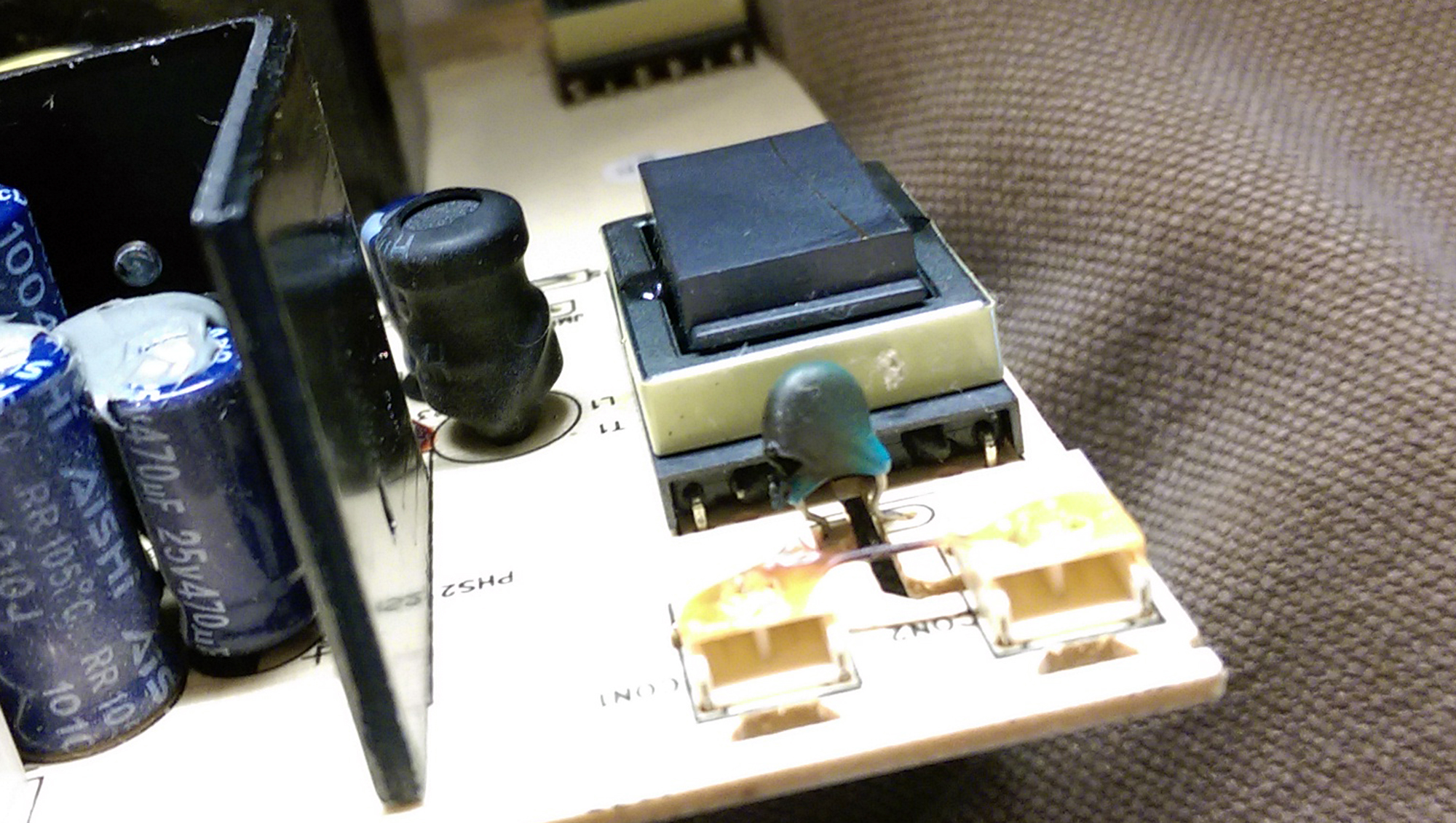

              c5 is burnt next to t1 --- c13 next to t2 is bright blue.
              • selldoor
                Slow Learner
                • Dec 2010
                • 7870
                Re: Viore lc22vh56pb
                Yes - I had just spotted that - it looks to me as though the glue they used to stick the
                lamp plugs in gas gone conductive. Carbonised then shorted possibly taking out the
                capacitor and if unlucky the transformer
                Suggest replace the capacitor and price up the transformer?
                EDIT Oh Good - just backtracked on the transformer results and it looks like its ok
                EDIT2 I am assuming you mean 620 ohms not K Ohms

                    While you are there there is a new thread here that we are hoping to promote to beginners
                    and I was wondering if you would give permission for that picture to be used as it covers two things to look for in one picture - off colouring and burnt glue
                    https://www.badcaps.net/forum/showthread.php?t=38391
                    You will also need to clean off the burnt glue and off the other side before it goes bad
