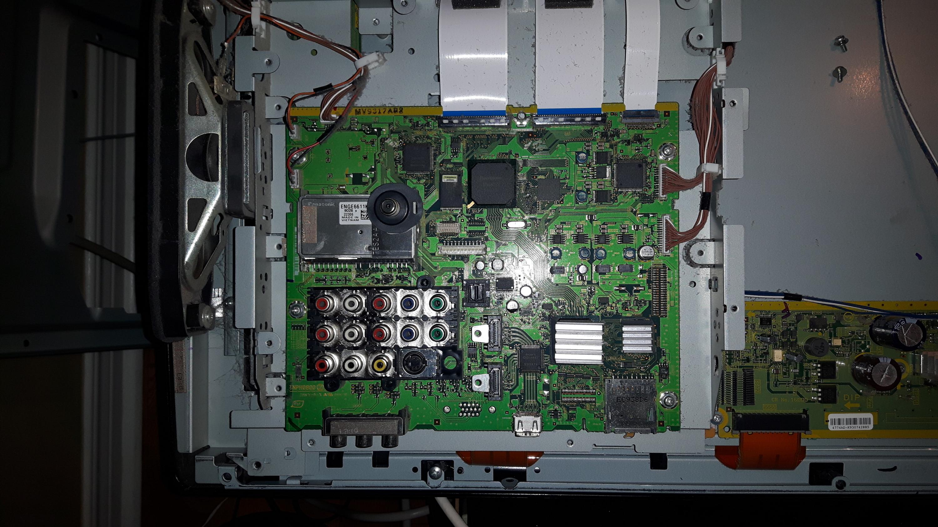

        I may be a bit confused, or this may have been answered already, but I have a Panasonic TC-P50x1 as well. When I turn it on, the red indicator light stays on, then the unit power cycles around 15-20 seconds later. You can see just a plain blank backlit screen with no input signal even though I have my hdmi cable plugged in. The same thing happens with no input plugged in as well. Any thoughts?
          #44
          Re: Panasonic Plasma TC P50 XI Blinks once
          sounding like a bad mainboard, I guess no input controls from the remote work or any OSD menus displayed?

            yea exactly, there's no menus or anything. I've done a bunch of research, and I've been led toward a bad main board or a bad su board / upper and lower buffer.

              If the screen is energising and it's not shutting down off with an error blink code but just cycling it's the main board.
              i don't know if it's worth the trouble but I think 1 blink is fairly common and someone has brought one back to life re capping all the can type caps on the mainboard I think? Otherwise you may have fun trying to locate a board, Modus is gone.
              Is there any spotting on the bracket if the A board is removed from it's cradle? I should see if I can find this post.

                Yea, the screen is energizing and then it shuts off without an error blink. What do you mean about "spotting" on the bracket?

                  I took the A Board off the cradle and didn't see any kinds of markings, "spotting" etc.
                  I'm looking up how to replace all the caps on this thing to see if I can bring it back to life. As well as looking for another board.

                    I wish I'd tagged this thread now, from memory it had spots like corrosion maybe the caps venting onto that metal cradle but I also think it had a 1 blink code. I'm looking but I've got noo keyword to nail it with, pretty sure it was 2009 era.the spots which may have been browny / red lined up with the tops of the caps.
                    Don't get your hopes up, could be a failed BGA device, bad solders, bad eeproms data who knows. Not a board many get to fix at component level.
                    Tried any freeze spray or heat the board up just in case you can fluke it to work?
