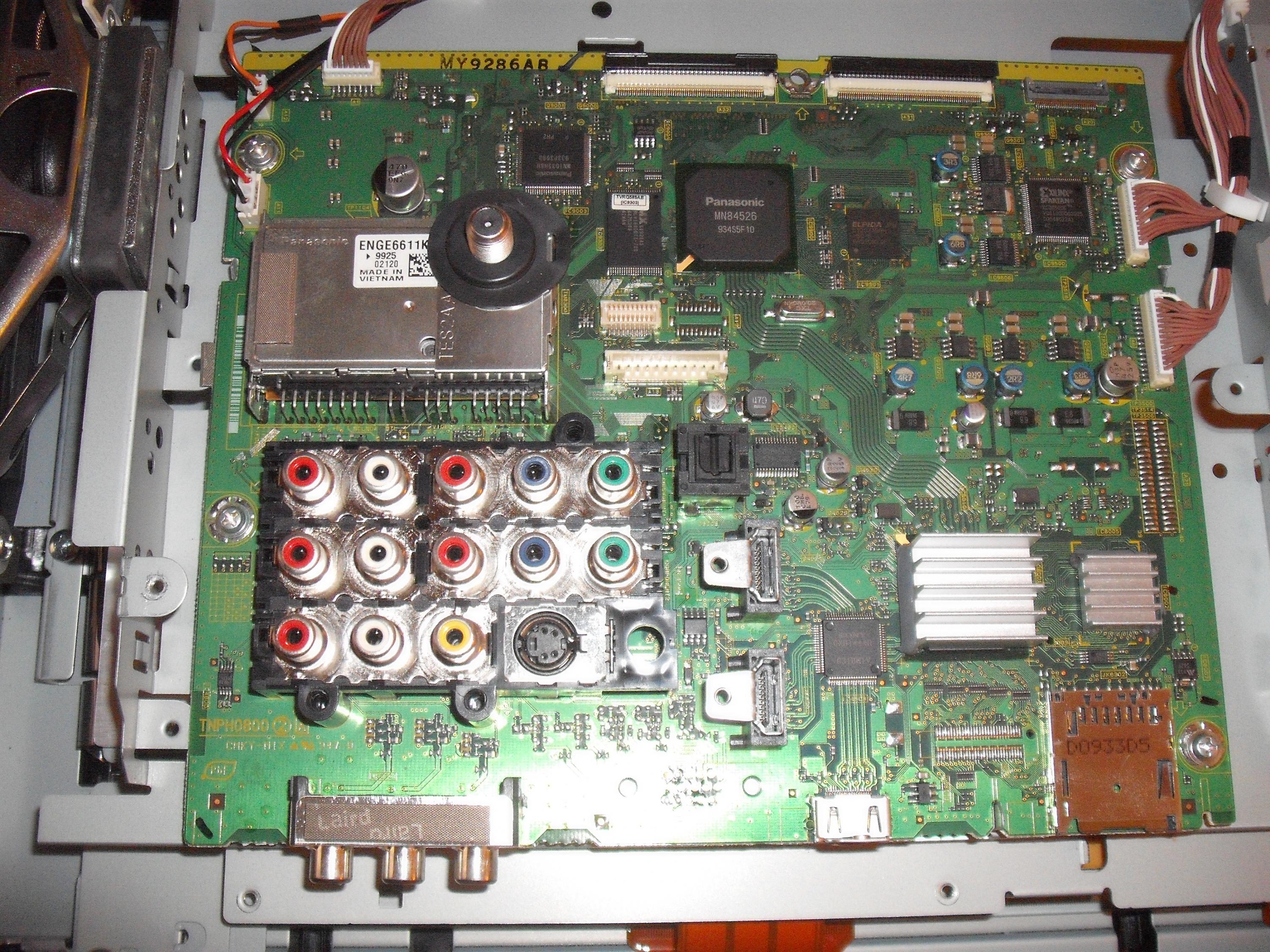

      Actually i probably got that wrong, it's an input for use as a monitor. A pic or the revision as we can use the SJ photos, that way you get better advice but not the first time I've suggested this to get someone out of trouble.
      Like you say, if they're not used and you just want a working TV with the normal basics it will work.
        Re: Panasonic Plasma TC P50 XI Blinks once

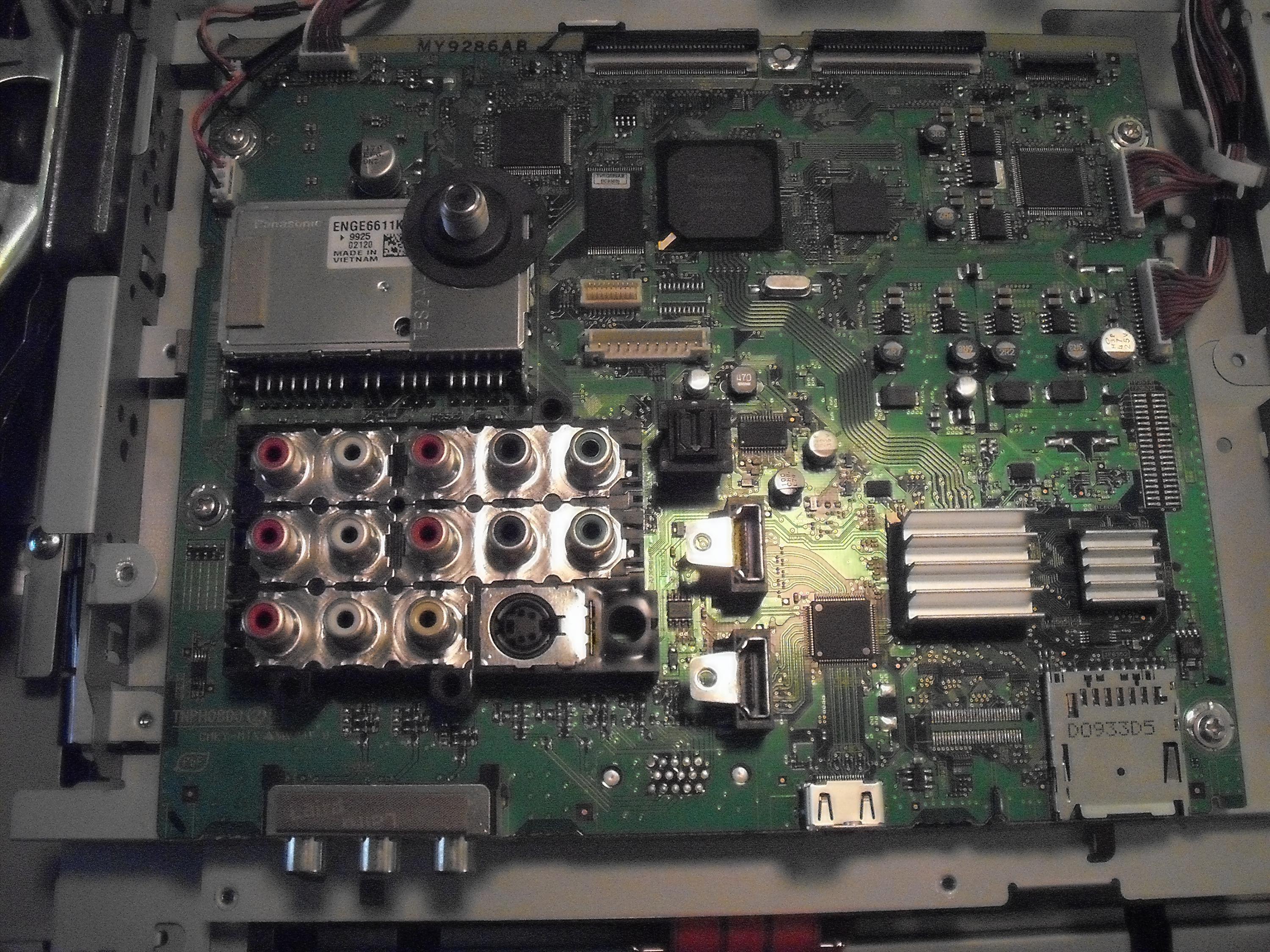

        Pics of current board.
          looks like yours is rev AB, so you just lose the side HDMI port by the looks of things.

                Ok so if you click on the pic on SJ it does get pretty hi res. I cannot see a difference except the missing HDMI on the side. There is a spot for one but it is not there. Perhaps I could just install one someday?

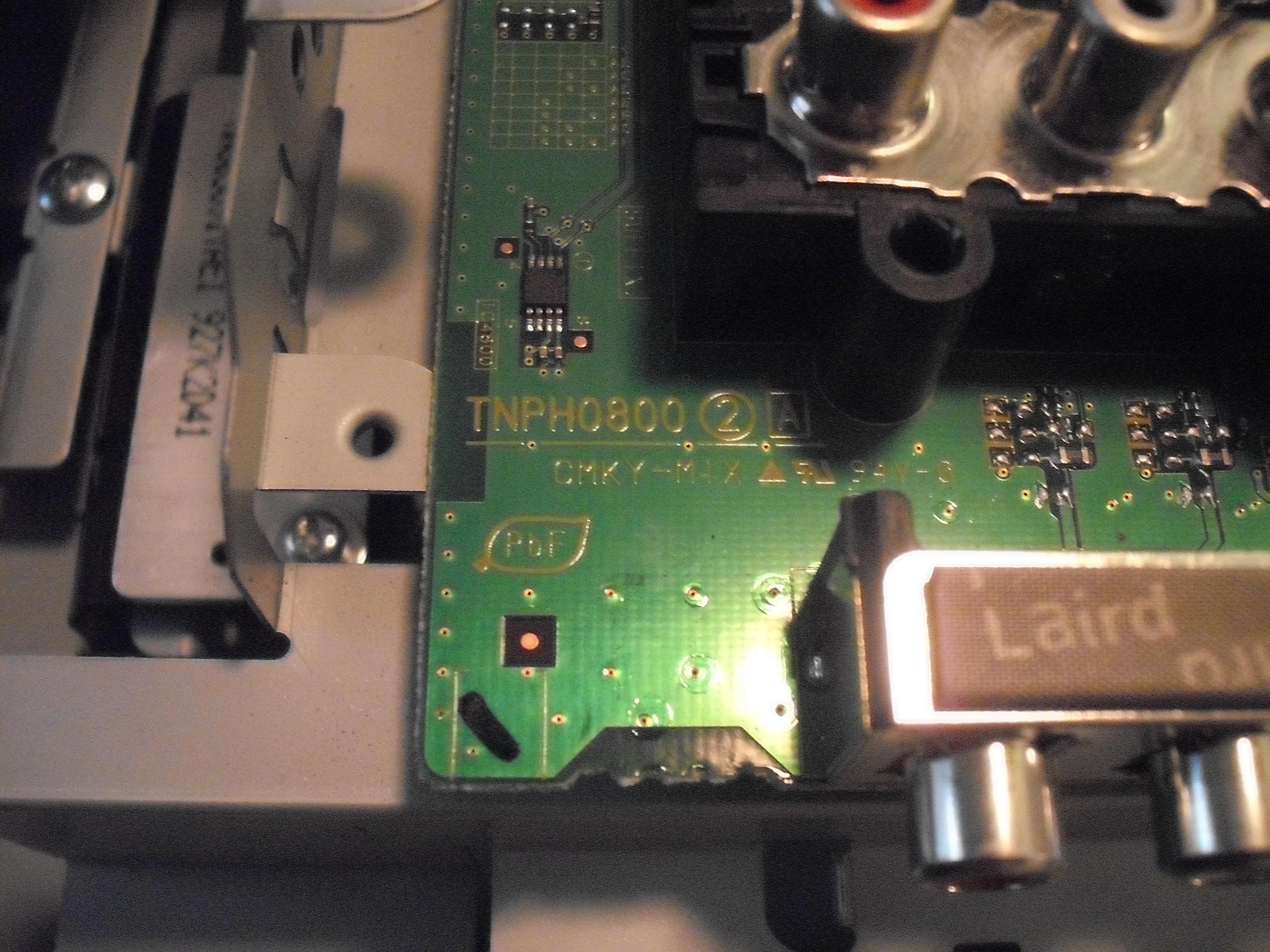

                  This is the one I am thinking of getting TNPH0800 AD.
                  http://www.shopjimmy.com/catalogsear...lt/?q=TNPH0800
                    #29
                    yeah, that's the one I've been talking about.

                          So I'v checked around and no one seems to want my old board for a core. Can I just cannibalize the side HDMI plug and solder it to the CI board? Just a thought.
                            #33
                            That will unfortunately not work as it will not recognise that port, it is not configured to do so.
                              #34
                              As tom said, I think it would require the correct firmware chip which i'm not sure which it would be and also would have to go through and compare the schematic of the 2 versions.
                              Like I was hinting earlier if you want all the same then repair by modus for the extra $30 or so sounds cheap by the time you spend working that all out and getting an eeprom from panasonic and the risk of damaging the board working on it.
                              Could work out from the manuals what eeproms are different and swap from yours but a bad one of those can cause 1 blink too.
                              I think for you, if it gets the TV running again, live with it.
                              Pity about the old board, I'd love to have another 1 blink A board to experimant with but even if I worked it out no good for here, too expensive to ship to the US.
                              plonk it on ebay for $20, someone out there may be keen.
                                  well, for starters here's some info. each HDMI has it's own EEPROM. SO, IC4508 will be missing, plus q4503 and other associated parts.
                                  firmware wise I see this
                                  50C1
                                  IC1101 TVRQ600S
                                  IC4500 TVRQ603S
                                  IC4501 TVRQ604S
                                  IC4508 ------------
                                  IC8502 TVRQ590AGS
                                  IC8503 TVRQ594AAS
                                  IC9001 TVRQ587AAS
                                  IC9303 TVRQ589ABS
                                  50X1
                                  IC1101 TVRQ598S
                                  IC4500 TVRQ603S
                                  IC4501 TVRQ604S
                                  IC4508 TVRQ605S
                                  IC8502 TVRQ590S
                                  IC8503 TVRQ592S
                                  IC9001 TVRQ587S
                                  IC9303 TVRQ589S
