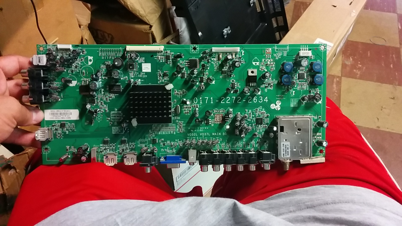

    ok this main board is out a vizio lcd it would turn on but no sound so I replaced main and got it to work but id like to fix this and sell it on ebay, but what component can I change to get sound to work? im pretty sure the connector in top right was for speakers

    Top right is the audio amplifier. There are a few other places where the audio could fail. Usually the audio has a separate power supply, 8V or 9V is pretty typical. That can go missing causing other faults...

      so is there nothing I can replace to fix the sound? I don't have the tv anymore but would like to fix board if I could and sell it

        Your question is akin to asking how to repair a car that doesn't start. You've replaced some expensive part and it now works, but since selling it, you have no way to test/debug the old part, or confirm that you have fixed it. I don't know what else you expect? Unless someone knows of a common fault, I think you are SOL on this one for now.

          What component is audio amplifier

            That IC are the stereo amplifiers (in this case they are Class D amplifiers) that drive the speakers. You have power amplifiers that drive speakers, and the n you will also have pre amplifiers which drive the input of the power amplifiers, so it is not simple.

              so your saying this doesnt have just one ic amp?

                Very few TVs do.

                  and what am I looking for? should I have this on dc volts?

                    Ideally, you'd use a scope to trace the audio signal through the set, which goes to the amplifier IC. It may for example pass through an op-amp or filter stage.
