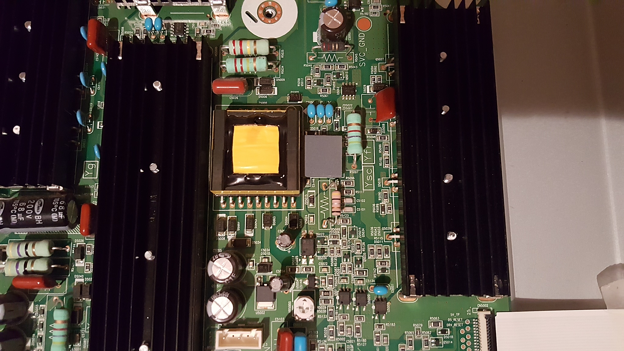

        Originally posted by Louis82
        UPDATE: Nicholas I did what you suggested. Replaced the 3 capacitors and it fixed the problem. I did notice that if I leave the buffers disconnected the VS voltage still drops. I guess this particular model requires having buffers connected to have a steady VS.
        Thank you again Nicholas.
        Louis82, I have the same blue 106 capacitors you replaced on your ysus board on your Samsung plasma. I know they are 10 uF but do you know what voltage? Where did you buy yours. I appreciate your time. Thank you.

          #64
          Re: Samsung PN60E530 no picture
          They are 10uf 50v. Heres a tip from me when testing the Tv-DO NOT HAVE IT SWITCHED ON IF YOU MOVE IT THE PANEL WILL CRACK !
              I'm having difficulty locating this 10uF 50V cap on digikey.com. I'm assuming this is a film capacitor but not sure best choice. Any shopping tips? I'd prefer the same one if available but I assume in that case may be a needle in a haystack. Any tips greatly appreciated

                #67
                Its a 10uf 50v MLCC multilayer ceramic cap. Also when I said it could crack I meant the panel could crack. I had it happen doing video of it soon for youtube.
                          Originally posted by nicholas1110
                          Most likely they just replaced the ic chip then and not the capacitors then if there is no sign of sign of soldering on them. If you still have the x main board you purchased from shopjimmy then you should be able to use some of the capacitors from there. I recommend replacing all 3 small blue caps near the ic chip. After that you should be up and working again. It is not very difficult to replace the caps. As long as you have a soldering iron just add Alittle new solder to the leg, then heat up the leg and just pull on the capacitor as you heat the leg. The side that is being heated should slide right out.
                          Nicholas1110 i have the same issue were i disconnect the ribbon cable from y main to logic board my va and vs voltages are good. When ribbon is plugged va falls to 10.5v. Would the issue be resolved by replacing the ic chip near the yellow transformer also? My tv is pn60e7000

                            #73
                            i have an update on this problem. my y-sus board doesn't have 3 small blue caps near the yellow transformer, BUT it does have one and it caused the problem. it was temperature sensitive. i also replaced the 8 pin dip regulator ic near the transformer. i hope this helps
