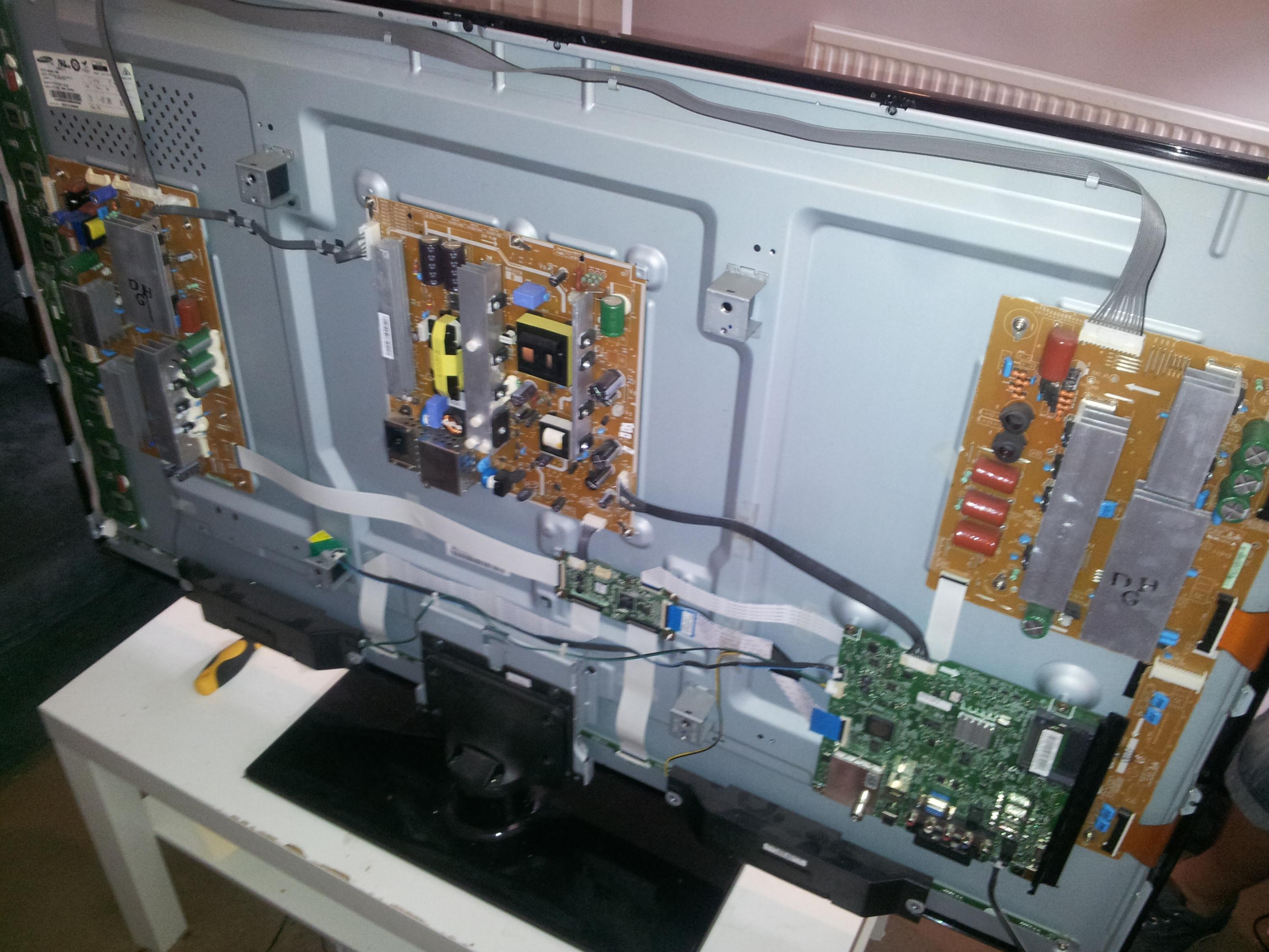

    Got this one cheap, 51" 720p plasma, 2011 model. Was expecting bad X-main or Y-main by description but then found it is completely dead. No power light, PSU has 5.3V standby, PSON is HIGH and main voltages from PSU are not active (this is OK, it is active LOW on Samsung PSU.)
    Ran test patterns panel is perfect, had slight pink tint on full white raster so upped Vs on PSU to 212V (rated 205V) which got rid of that.
    Main board seems reasonably obtainable and cheap, so will probably end up swapping that in, but would be interested if anyone knows of another solution or if this is a common problem.

    what boards do you want i might have some ?
      Re: Samsung PS51D450 dead no power - bad main board
      BN94-04349D
      X9 PDP 51" 450 XU
      Printed on side connector for CI/PCIMIA slot
      The board is about £15 on eBay so I'm not too worried but none of them are tested, would prefer to get a tested one.
      If you have a PS51D490 main board & 3D transmitter I might be able to convert this to a 3D TV

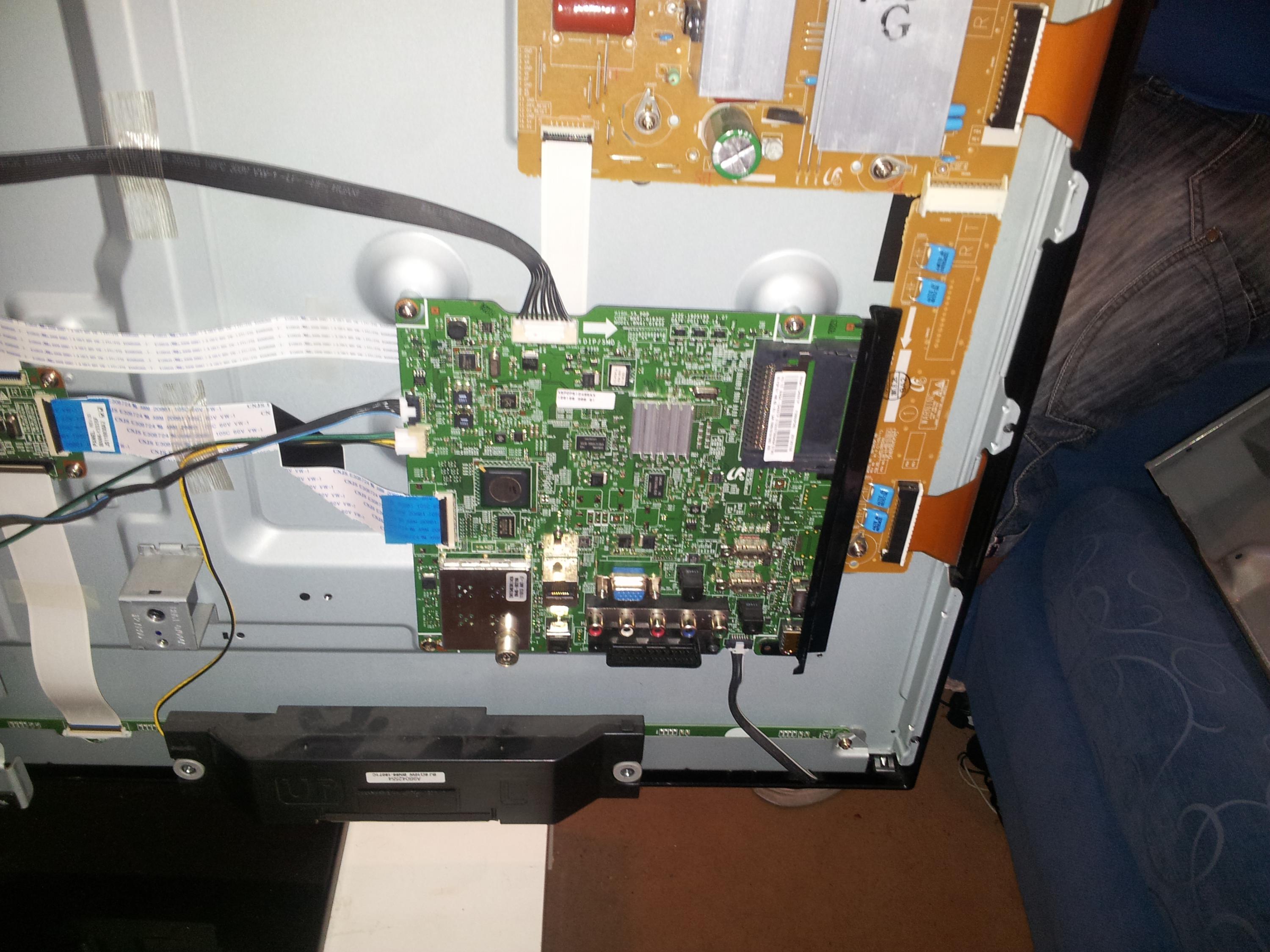

        OK... Crazy idea. Only difference between this and PS51D495 (3D version) is the main board and Bluetooth 3D transmitter. I've never done a 3D TV but it sounds like I can convert this one for about £8 (cost of transmitter, the main board is same cost)
          I haven't got the board you first listed what's the board number for the other ?
            BN94-04891P main Bd
            And
            BN96-17107A transmitter
            Also need cable for transmitter to main AV
              I bought the main board.
              This upgrades the TV from SD Freeview, 2 HDMI, 2D only to HD Freeview, 3 HDMI and 3D capable. Needs bluetooth TX and a pair of glasses to completely work, will update on progress.
                cool be nice to see if your upgrade works ok has the back got the extra hdmi hole cut of or will need modification?
                  The board I am getting has a plastic side panel included, which has space for the extra HDMI.

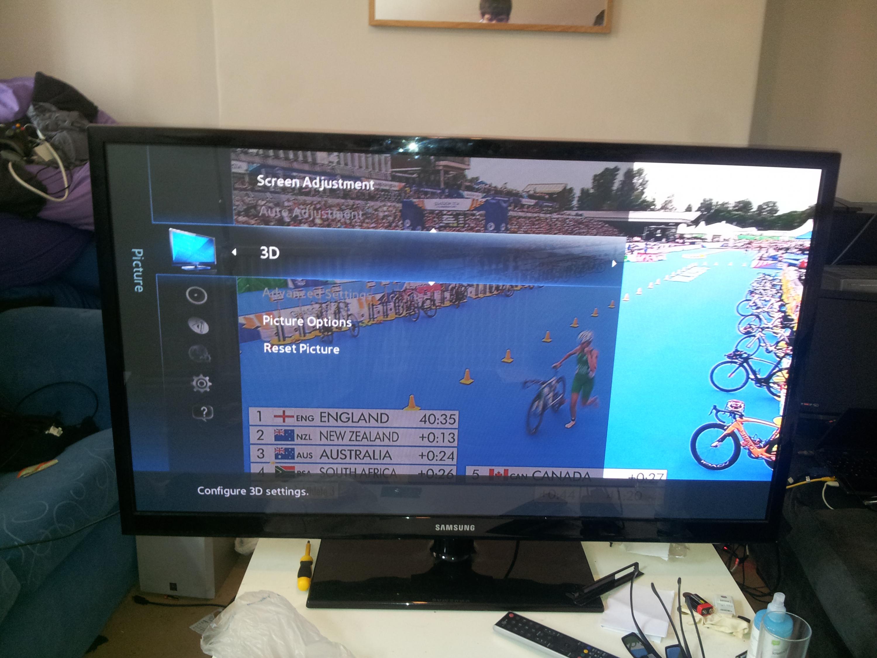

                      Well, the 3D upgrade is possible and the TV works too.
                      My experience of the 3D is - underwhelming - it's barely noticeable on most content :/ I think this is typical of most 3D displays. I expected it to be far more noticeable but it really is only barely noticeable... plus the image is dimmed by the glasses... meh.
                      Also gives TV a Freeview HD tuner and extra HDMI port.
                      To upgrade:
                      • Replace main board with: BN94-04891P (get one with plastic bracket included)
                      • Cut hole for ethernet port
                      • Install bluetooth transmitter: BN96-17107A
                      And it's a good'n!
                      Thanks to Sordids for supplying transmitter, arrived same day as main board.
                        So I only just got a look at this panel in a dark room. It is full of maldischarge! For a 2011 Samsung panel, come on Samsung!! I had to tweak some of the settings to get rid of it.
                        I upped Vs to 217V from 205V which is just outside Samsung's "tweaking range" of +/-10V, I don't expect any harm to come from this. This increase in Vs resolved the pink tint to white, and uneven look of white. In 2D it was OK at 212V but 3D needed the extra 5V. I left Vsc at -187V. I lowered Ve from 86V to 81V, adjusted Yrr to 11 o'clock, and Yfr to 4 o'clock. The panel maldischarge is now gone. There are no sparklies on 3D content, unlike before.
                        And to answer the question: in 3D mode, it halves the subfield count from 10 to 5, so each eye sees 5 subfields. The dithering does work surprisingly well though - with the glasses on, it looks identical to 2D. Which is quite an achievement. Unfortunately the rest of the 3D is very "meh".
