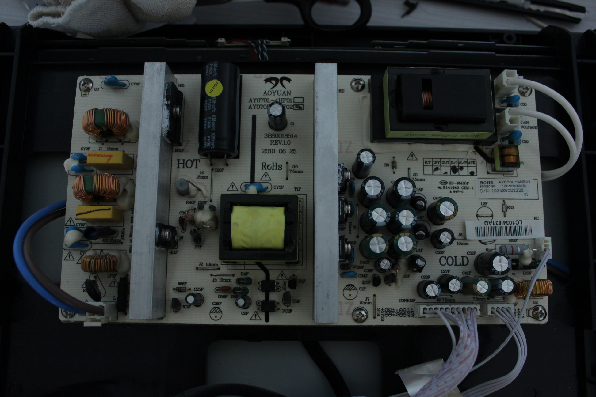

    I have a problem with my LCD TV 26" "VD TECH TQT26AVD.She stay in standby.
    All capacitor seem to be good, I have checked the output of the PSU board and all voltage are good just the last "the standby connector" have 3,78v I ‘don't know if it is good or not?
    In some LCD it is the EEPROM component who need to be change but I haven't this component...
    Thanks in advance

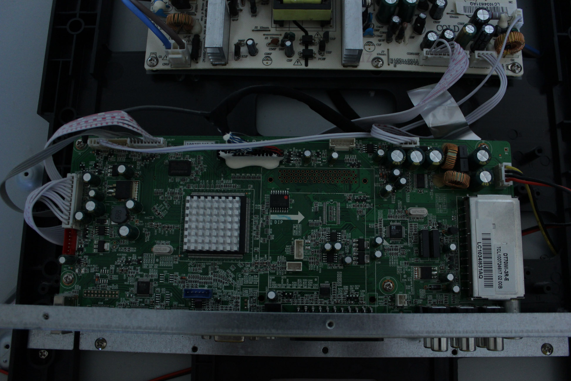

        Ok -it is still usual to get some sort of "Hit"
        As there is nothing you will need to to post pictures of the back of the set
        showing the generl layout then pictures of the individual boards and also give the board numbers - they may come up on a search.
        Try and find a small 50v cap on the Primary HOT side of the power supply
        and CAREFULLY test the voltage on it do not touch any other componnents or heatsinks in that area.

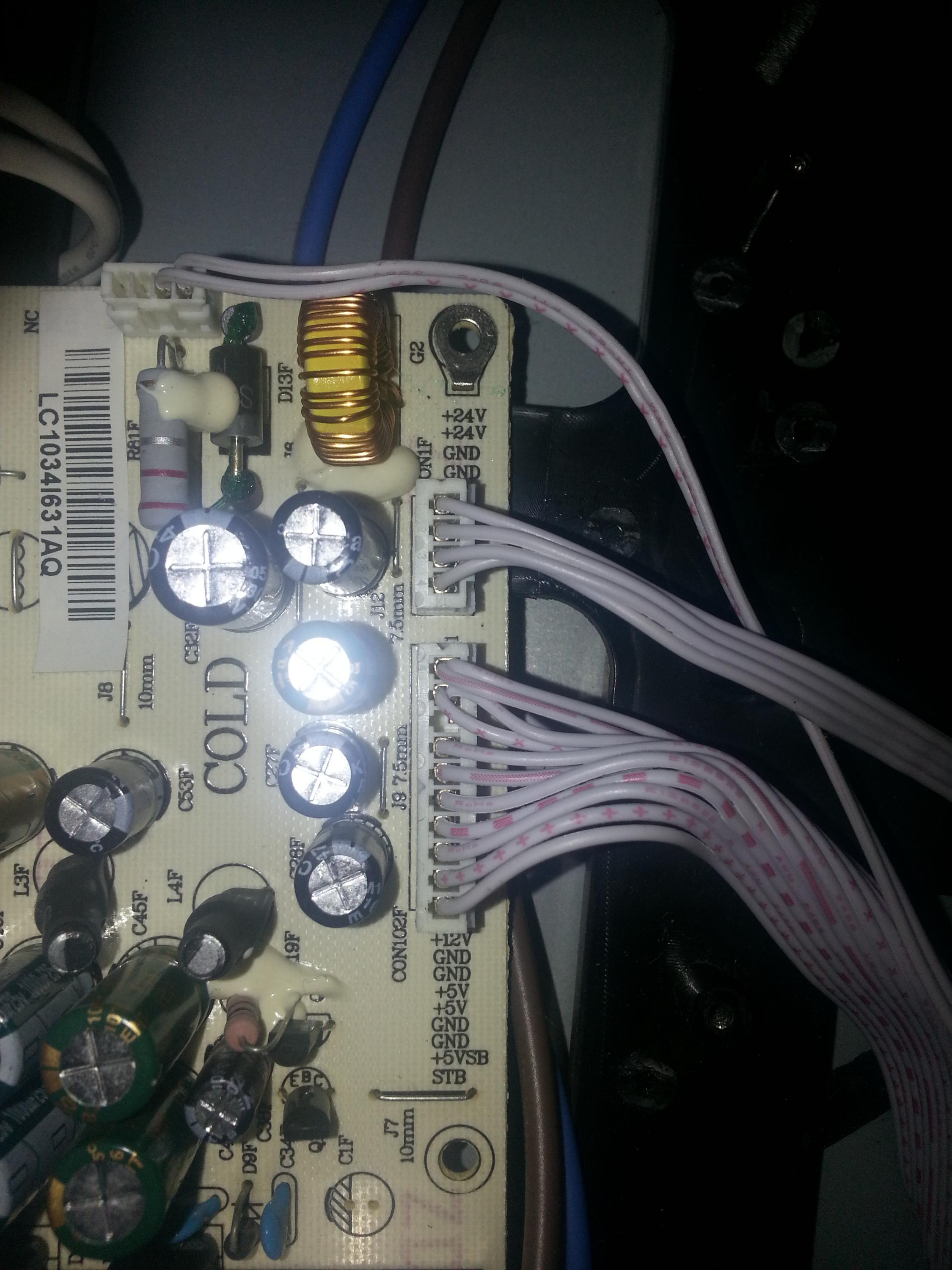

                                  Ok one or both of the 50v caps are start up caps - if you can get to them it would be useful to know what voltage they are at on standby and what if anything changes when you press the on button. Another idea I just seen mentioned on another thread is to pre heat those two caps with a hairdrier for a minute or two before switching on.
                                  I am still thinking about jump starting. There seems to be more cables than usual and I cant see all the pin details - example what is on the two pins next to 24v? What is that
                                  cable with just 2 wires - perhaps pictures of each connector would help and also look
                                  on the back to see if any more descriptions.
                                  Do you get any voltage on the 24v pins?
                                  Probably a tomorrow job now as I guess its midnight there.

                                      24v pin are good, 24v on It.The TV after some restart still on but I have tried to do the test on 50v caps but I did a short circuit .

                                        It is looking like a loose connection/bad solder joint so pictures of the backs of the boards may help us spot something.
