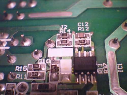

    I think I have done a big mistake.This morning I have bought fuses and a resitor because a resistor was burn on the board.But when I have remplace it the new one burn to and I don't know where the problem is.

      I find a resistor burned but I cant see ohm on it so I can't change him .If someone have a solution ?

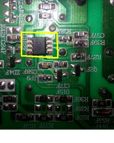

        Is that a different resistor to the one you replaced?
        I can see 2 numbers on it so it is 10? or ?01.
        As with the other chip you need to try and clean it - get some IPA from a pharmacie
        and do it gently with a q-stick.Do not use your other "cleaner"
        I suspect you have been unlucky and the slip has damaged the U102F
        What is the part number on that - maybe its datashet will give us the resistance for the resistor

          The résistor I have change burn when I turn off the psu but the r39 seem to be burn too but I can't see what is write on it I will try to clean it with your product. I done some research but I can't find the datasheet or a picture of the psu so if someone have one of the two?

            Maybe it is 100 ohm an other cap near this one is a 100ohm.

                  Originally posted by flosers
                  The R39r.I havent found IPA but I'm afraid that the resistor is burn so a product on it don't help to see something on it.
                  No! The IC see pic
                    #29

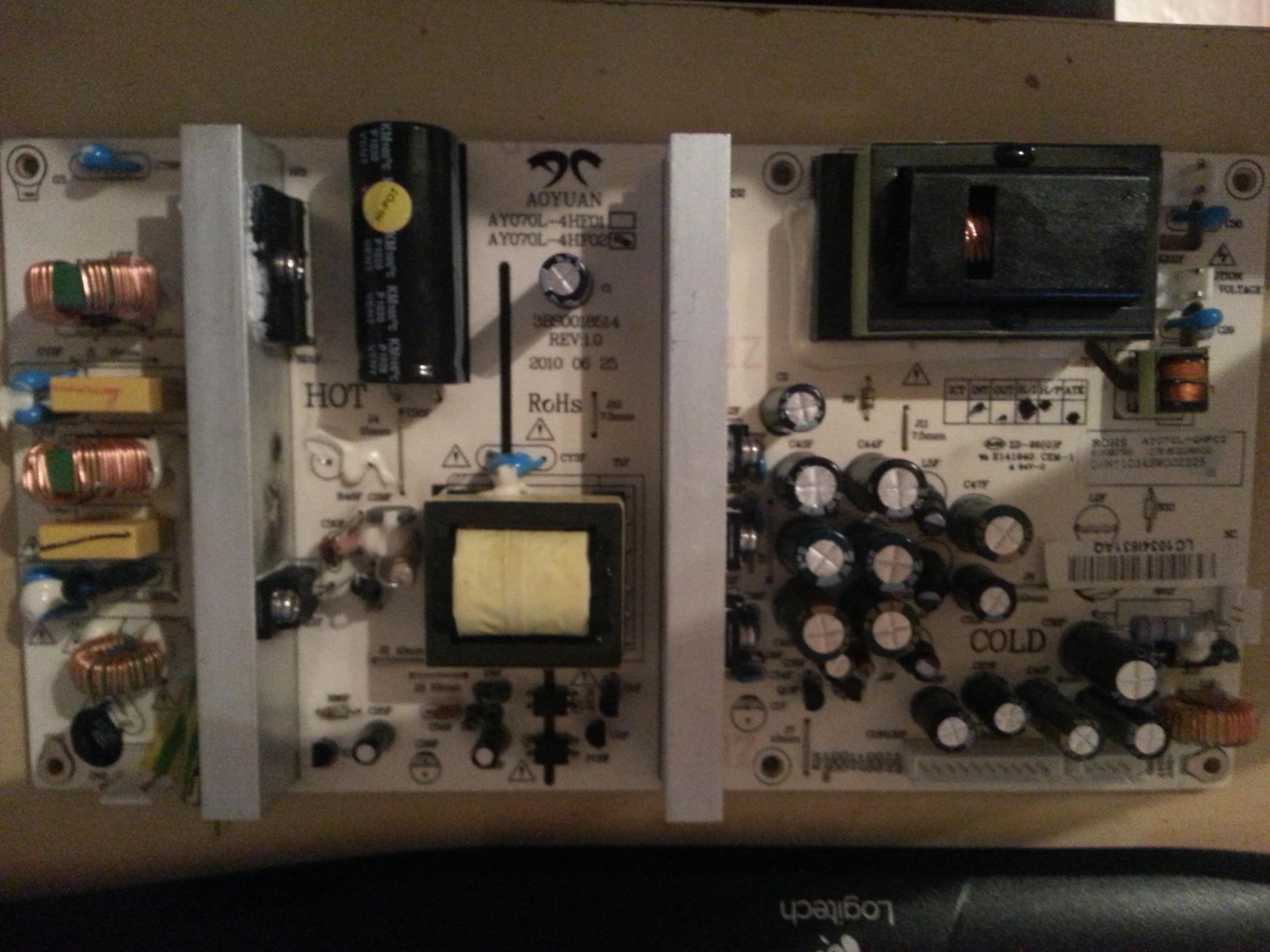

                    Can we get bright and clear pictures of the top and bottom side of this power supply/inverter board?

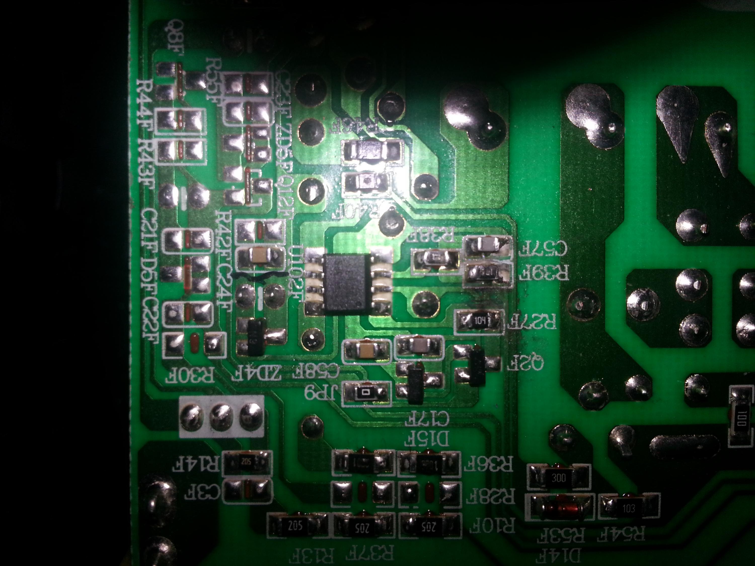

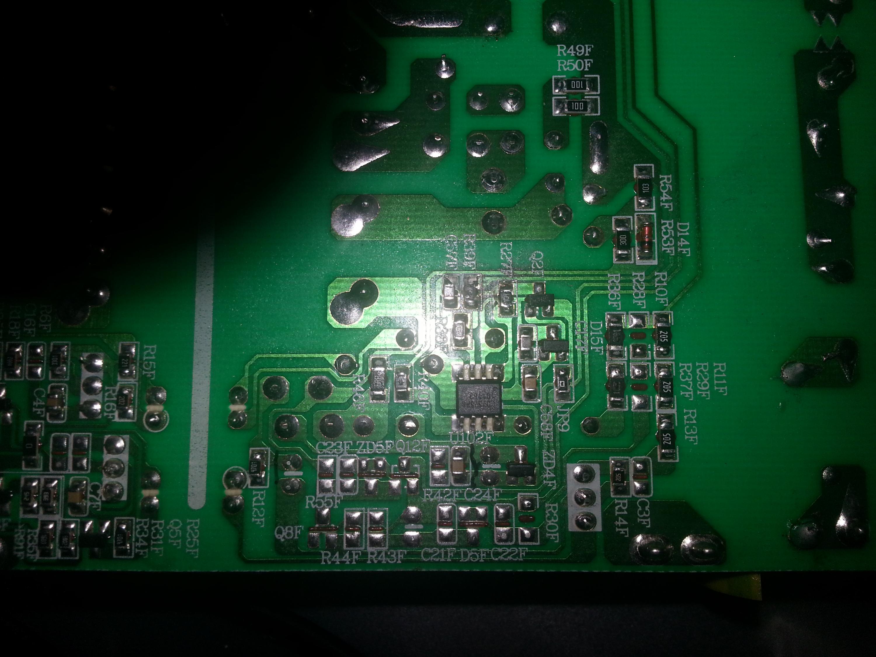

                      #30
                      Re: LCD TV 26 Stay in Standby mode Red led
                      I'm not sur but I read: C07575PS
                      101168
                      On the U102F.
                      Some picture in Attachment.

                          First thank's for the doc, It seem to be the GND and they are no information on it.I heat and I will check what voltage i have before this resistor.Any other suggestion?

                            I am looking for a circuit using the IC may give us a clue to resistor values.

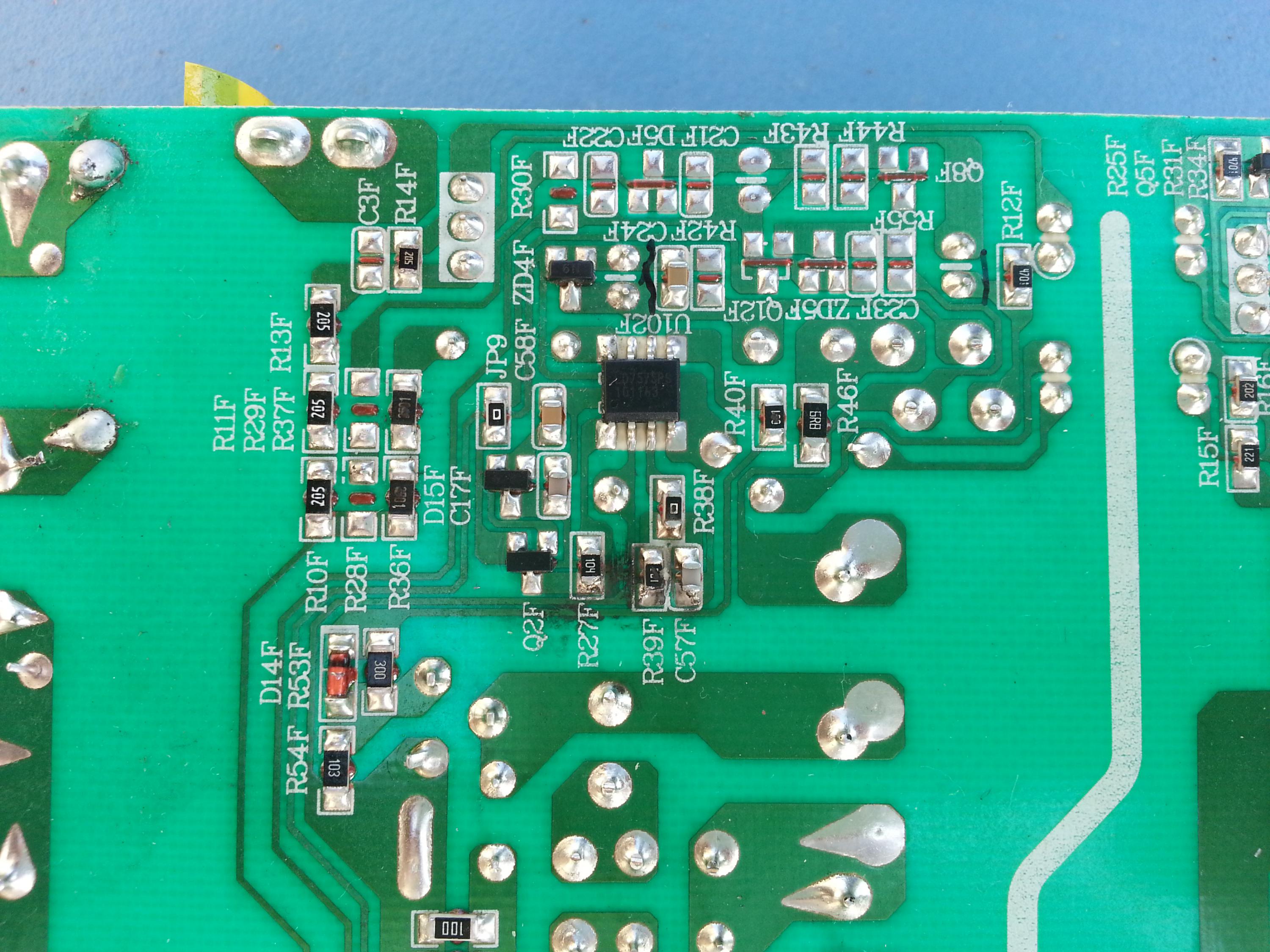

                              Well I found this : on the picture the right resistor is write "104" and in my PSU the resistor at the right of the burn resistor is write 104 too. So according to this pic my burn resistor is "103" apparently 1000ohm?

                                Looks possible - I would rather budm had a look - the IC could still be bad but
                                I dont know how to test it.
                                Budm also want a good clear pic of the TOP of the board

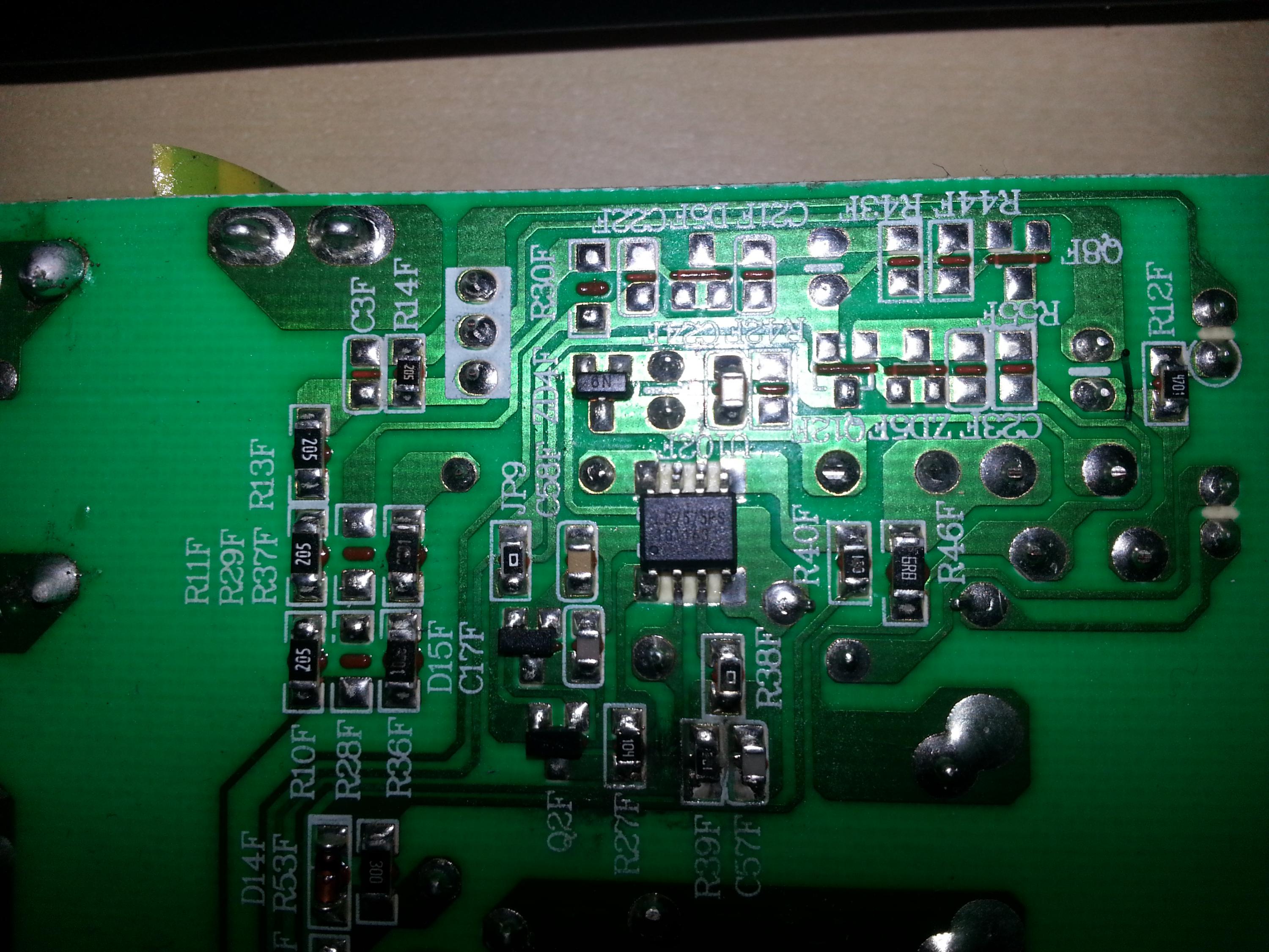

                                  Ok
                                  A new pic:
                                    No, 103 would be 10,000 Ohm. Assume that circuit uses the same resistor values as yours anyway.

                                      Can I test the board with a 10 000ohm resistor?

                                        #39
                                        Sorry, I meant to write "Assuming"
                                        We don't know if it uses a 10K Ohm resistor there on yours, but it does seem similar by the picture...
                                        That pin 3 is current sense pin from MOSFET and R39F is part of filter network as shown in datasheet, so probably the values will be the same as the other board, why would they use different ones for the same IC?
                                        Anyway... it looks like R38F is bad too.
                                        Also, R36F and R37F that feed the VCC pin look bad, so I would not be surprised if that controller IC is shorted at the least, the MOSFET maybe too, and could even be a problem with MOSFET snubber circuit too. You should check all these before you replace the resistors and power it on again.

                                          #40
                                          I have 4 on the 2 resistor (R37-R36) with the multimeter on 200k, that's a good sign I have the same value? If it's not maybe I can replace all this part? It's a current-mode but I don't know what that is.The R38F is good I have 0.
