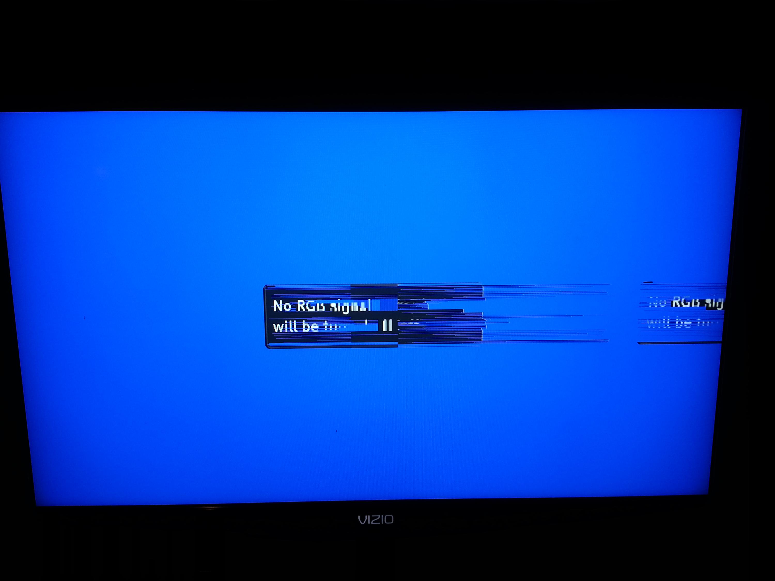

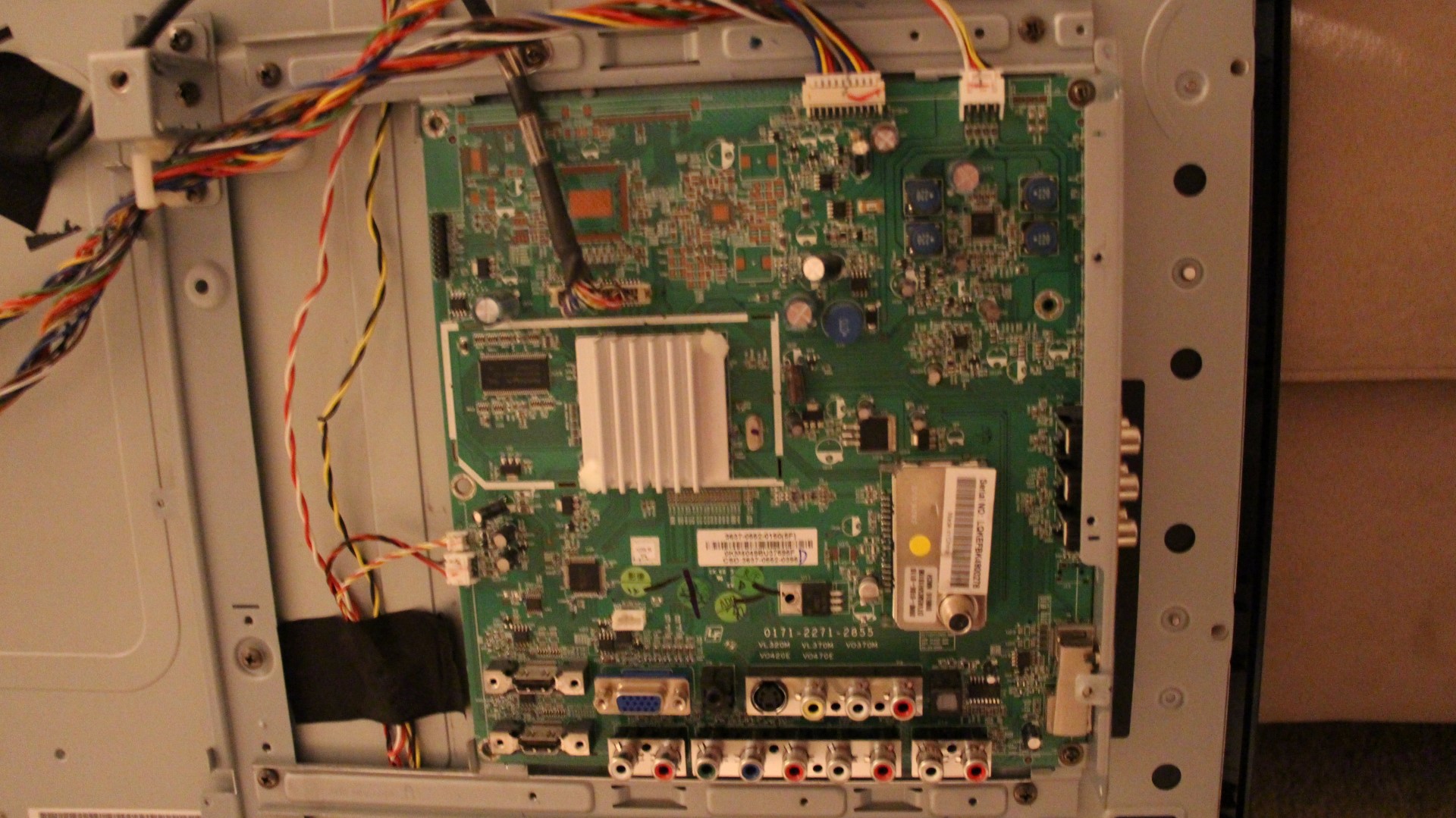

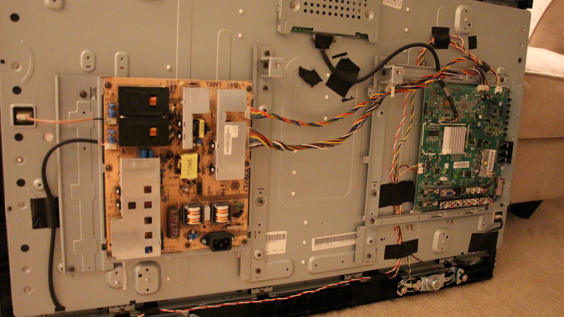

    So I have this Vizio, and I'm not entirely sure what the problem is. I'm hoping a corrupt eeprom, but I don't usually get that lucky. Audio works perfectly, but video is garbled. Even the bootup vizio logo looks the same. When playing a source via HDMI, there's actually no video 99.9% of the time. Every once in a blue moon a garbled image will flicker for a few seconds and then go away. Backlighting never fails. I hopped through the inputs via the source button on the side three different times tonight, and during one of them the TV turned off.

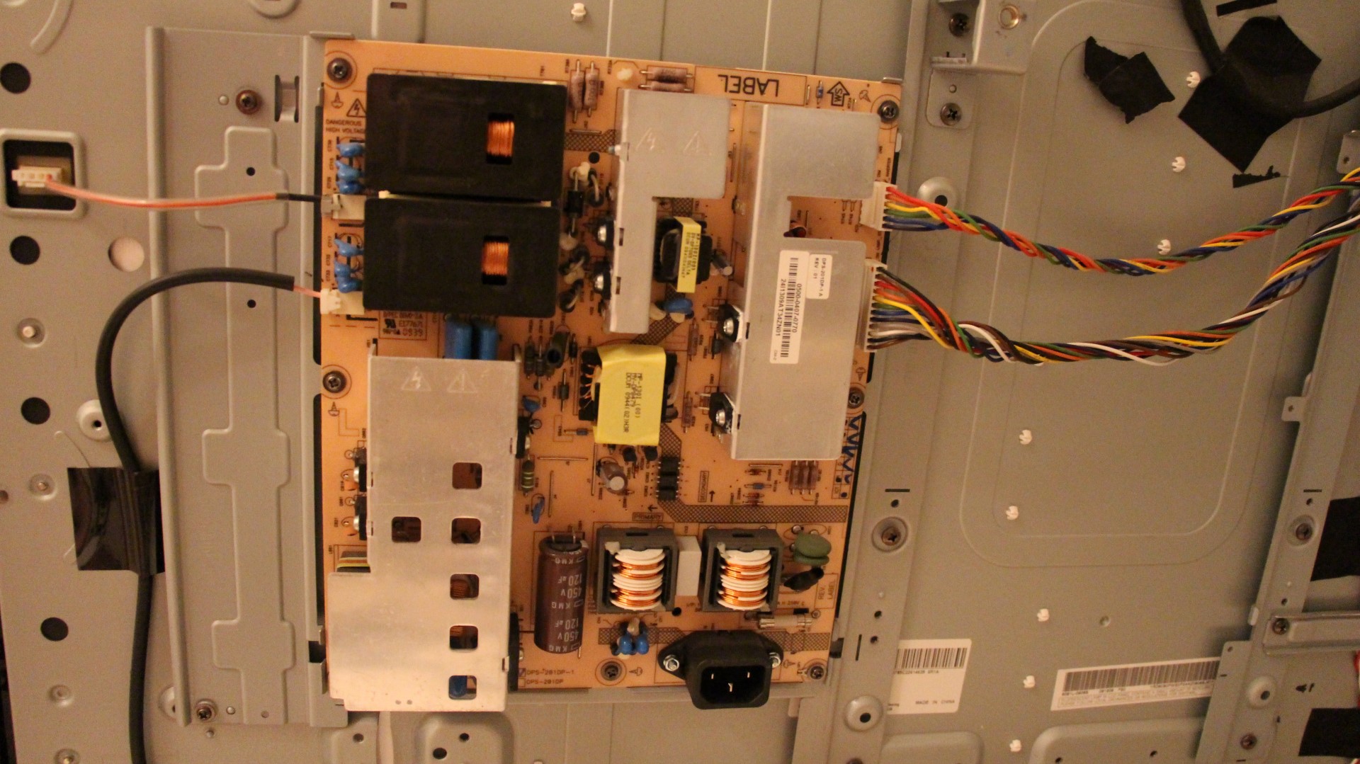

    All voltages check out. A bit high (5.2v and 12.25v), but they're consistent.

        This is what I get. That's obviously not going to allow me to do anything, unless I know the exact key presses to perform a reset (which I don't).

          Now I just feel silly! The bright blue blank screen on the VGA input made me believe the panel was just fine. It just felt like a signal issue. Reseated everything on the tcon, no dice. Disconnected and reconnected the LVDS cable on the mainboard and Bob's your uncle. Picture looks awesome again. Thanks for taking the time to give me some input, selldoor! The time and effort everyone here gives is always appreciated more than you guys can know.
