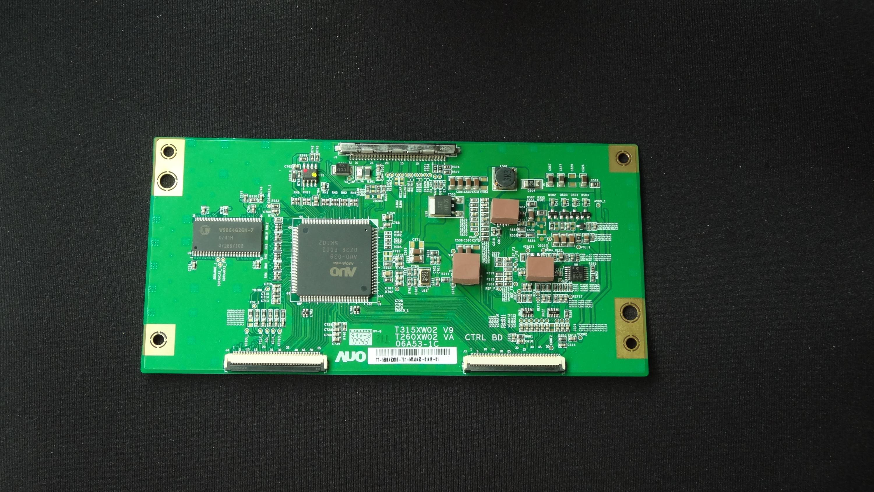

    I thought I was being smart and I tried to do a mainboard swap with a newer mainboard. Unfortunately I forgot to set the 5v/12v jumper and I accidentally sent 12V into the T-con board for this panel which was only suppose to get 5V.
    I think I also blew a transistor/FET on the mainboard, one that switches power on to the LVDS connecton. Luckily I was able to swap that transistor with one from a similar mainboard, and I even got it working.
    I know the mainboard works now, because I plugged it into an AUO T315xw01 VC panel, which is also 5V and has the same LVDS connector pinout.
    But now when I take the same power supply and mainboard from the working panel, and plug it into the one I accidentally zapped with 12V, the power light changes from red to green, goes dark, and then goes back to red. Looks like I have a short somewhere that's resetting the power supply. If I unplug just the LVDS cable, then it turns on fine, i.e backlight is working, but of course, no picture.
    Just to make sure, I connected the mainboard/PS back to the good panel, and it was working fine.
    So back to the bad panel, I'm pretty sure I zapped something on the t-con, but so far I've only been able to locate one fuse (marked F1_3A), which appears to be ok. The only issue I been able to find is a schottky diode that appears to be open (D504 - SCD34 3A 40V). I know it's a long shot, but does anybody have a schematic for this particular t-con? It's marked T315xw02 V9/ T260xw02 VA/ 06A53-1C.
    If not, anybody want to guess how likely the only problem is just this diode? This particular board seems to be pretty common on ebay for $10 so if it's more than just a diode, I might just buy a replacement instead, but I'd be kicking myself if all it needs is a $0.50 part to get it working again.
    Prior to accidental zapping, the panel was working fine with the old mainboard and the same power supply. Earlier that same night, I also managed to accidentally short out an inductor coil with a loose ground wire on the primary side of the power supply and it burned through the coil. Luckily I was able to fix that, but perhaps I really shouldn't work on these things late at night when I'm tired.

    Did you try it with the panel ribbons out - just in case the panel is damaged?

      No, I haven't tried that, although I realize I made a mistake in my previous post when I said the diode failed open. I should have said it's shorted in both directions, not failed open. I'm hoping that it sacrificed itself to save all the other components.
      BTW, when I powered it on with the 12v instead of 5v, there was no drama, no sparks or magic smoke. Just a backlight, but no picture. By the time I realized my mistake, it was too late.
      I think the failed FET on the mainboard prevented the P/S from resetting. After I replaced it, the short on the t-con caused it to reset. I think I will try to replace the diode first, if I can find a spare on another board. Otherwise I'll have to order one and wait for it to arrive.
      I'm am somewhat surprised that the fuse didn't pop.

        Shorted in both directions - what was your meter setting?
        What voltage do you get on each side of the fuse.
        As you say if they are both rated at same amps and voltage well over that applied why would one blow instead of the other. Though the fuse could be time delay type? giving the diode time to blow before the fuse had chance.

          A fuse has a blow characteristic. It will not immediately pop at 101% rated current (3.03A.)
          Example: ATOF fuses (used in cars) go something like this:-
          100% rated - more than 5 years @ 75°C
          110% rated - more than 500s blow time
          200% rated - up to 45s blow time
          300% rated - up to 5s blow time
          400% rated - under 1s blow time
          500% rated - under 0.1s blow time
          Every fuse varies, but it is possible for 3 x current to pass in this example for up to 5 seconds without the fuse blowing.

            I tested the diode with the power off, the power supply resets back to standby (probably because the 5V line is shorted and pulled back low) so no voltage reading.
            My multimeter has a diode setting which is the same as the 2000 ohm scale. I checked the diode with the leads in one direction and then the other. Both times it read 0-1 ohms.

              Did you tried with the ribbon off like Tom suggested. Are you saying you have removed the diode and the power resets?. If not remove the diode and try in case something else is shorted.
