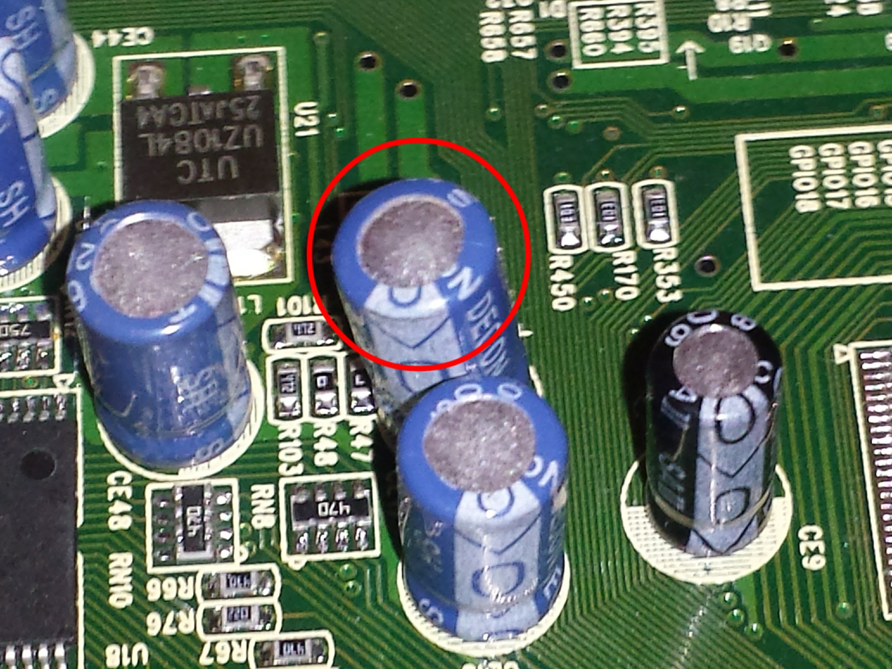

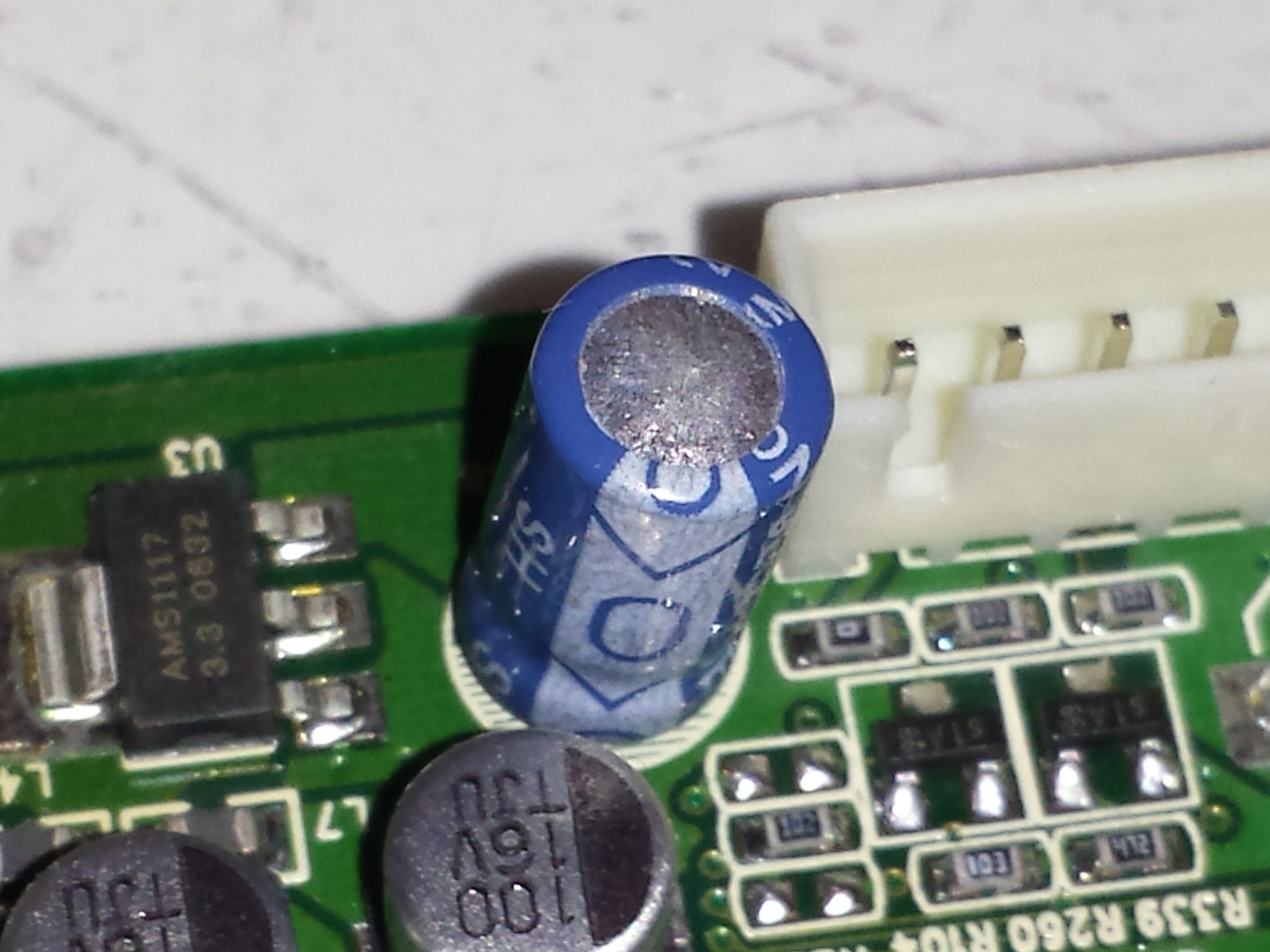

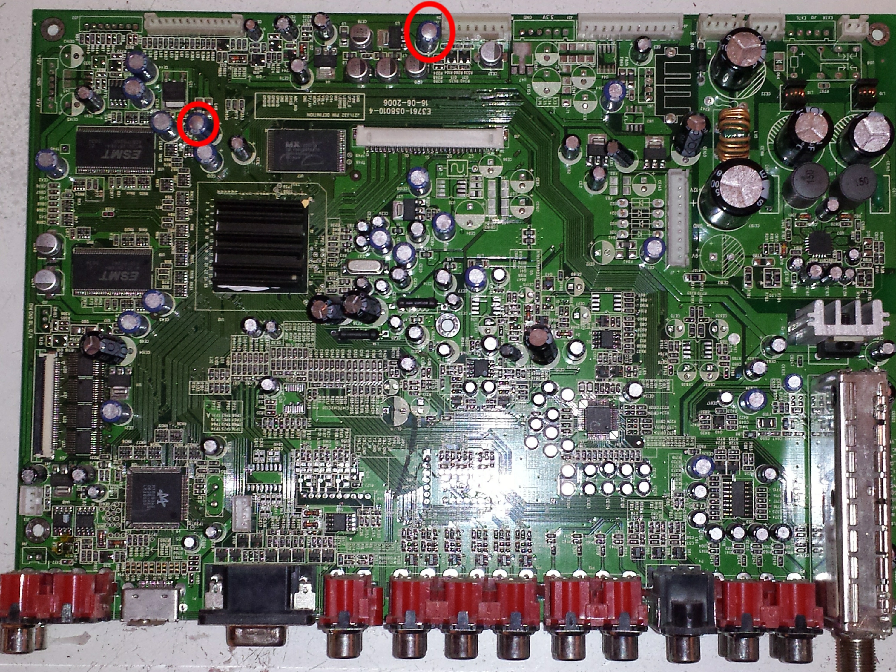

                      Haven't had much time lately but I pulled the main board and did find 2 bad caps. Haven't checked the rest for high ESR yet.

                          I replaced those 2 bad caps and I think it's ok now. It comes right on without a problem. ESR on those 2 caps was 30Ω and 34Ω.

                            Nope, not fixed. It works fine if I turn it on from the power button, but if I use the remote I get the little sparkles and the buttons become unresponsive. But also, once I unplug it, and plug it back in, then everything will work fine, including by remote. I think I should have recapped the entire board.
