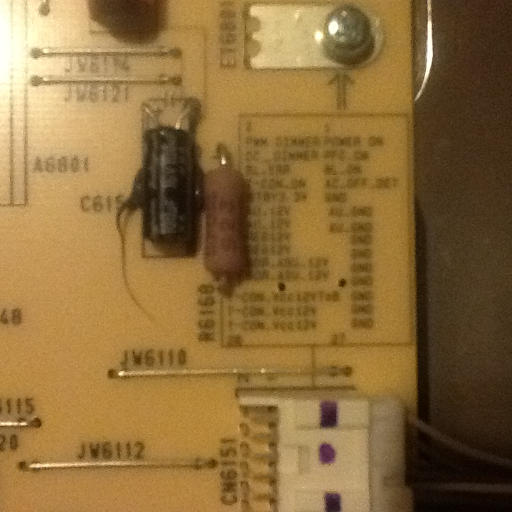

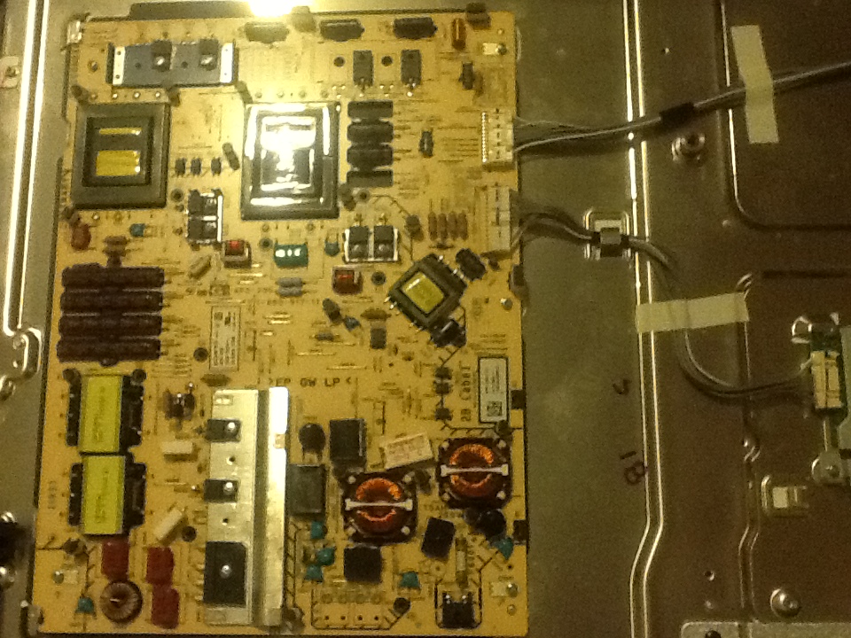

    I do not know what the Standby Voltage for this model is, but if it does have a pin on the connector to tell you what it is, then check the DC voltage without having the main board connected and without the main board connected.
    How about straight shot pictures of the power supply board and closed up around the connectors so we see the labels.

      Sure, let me get the iPad out again. I didn't get any readings on standby at all(with connected and not connected on backside of PS), no voltage anywhere but the caps.
        Re: KDL-46EX621---No Power/No Standby---Bad PS?
        I cannot find the service manual so I have no idea which connectors have the standby voltage and what the standby voltage is, 5V??, 3.3V???.
        BTW, can you get the P/N as printed on the power supply board so I can see if shopjimmy will have good clear pictures of the board?

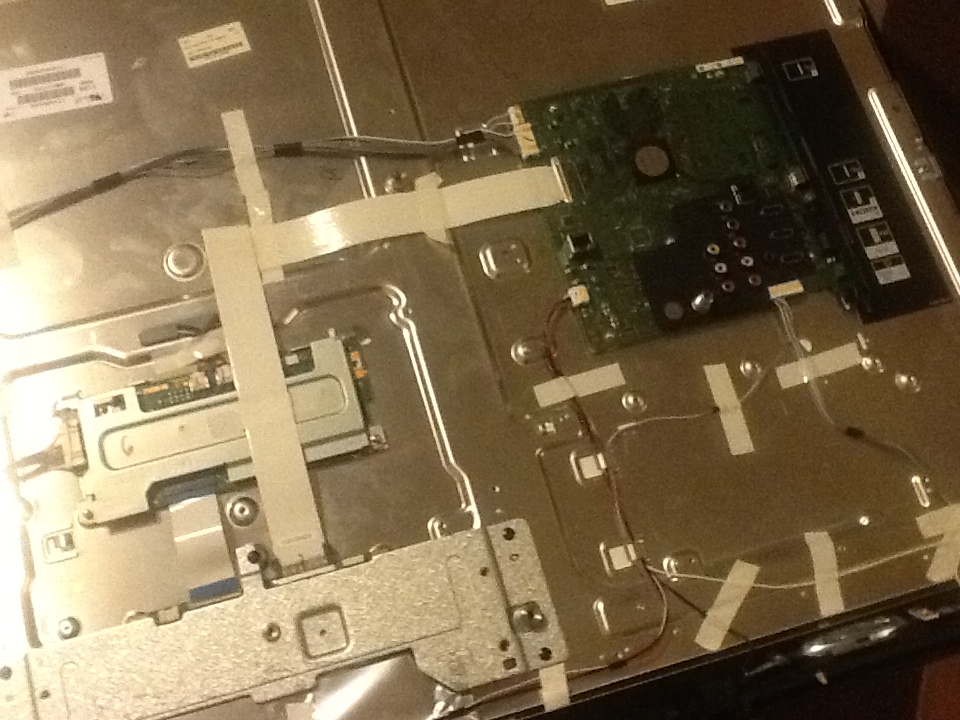

              Ahh "I figured with the way this one was setup, I can get the backlights to turn on by disconnecting the main to see if it's a main or PS issue but no luck. It looks like the backlights are powered by the LED driver board which runs directly to the PS. " So that means the power supply board has biult-in pull up resistors for the PS_ON and the BL_ON. When the cable not connected, see what Voltage you have on the main filter cap.
              Also try disconnecting the cable between the T-CON and the mian board to see what happen.

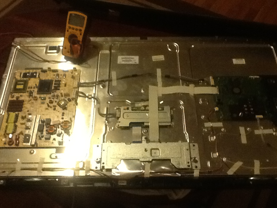

                Did the best I could on it
                  When the main is plugged in, I get 171.3 on each cap and when I unplug, I get 172.1 on each one. No difference with T CON disconnected.
                    Way out of focus for me to read. Any P/N on the sticker on the board?
                    • ALR
                      • Nov 2012
                      • 111
                      Yeah it's the Sony 1-474-309-11 (Aps-298) G5 board
