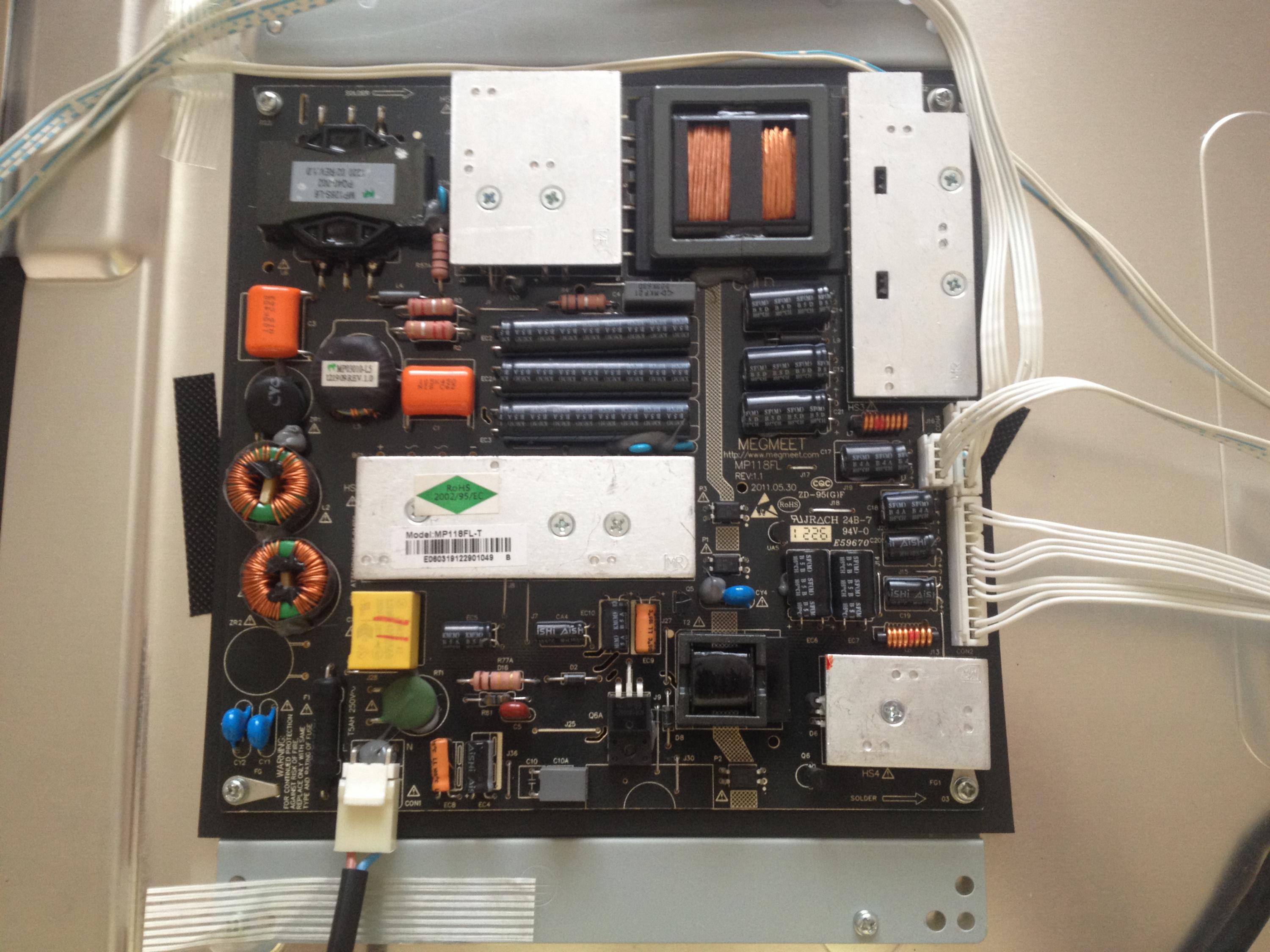

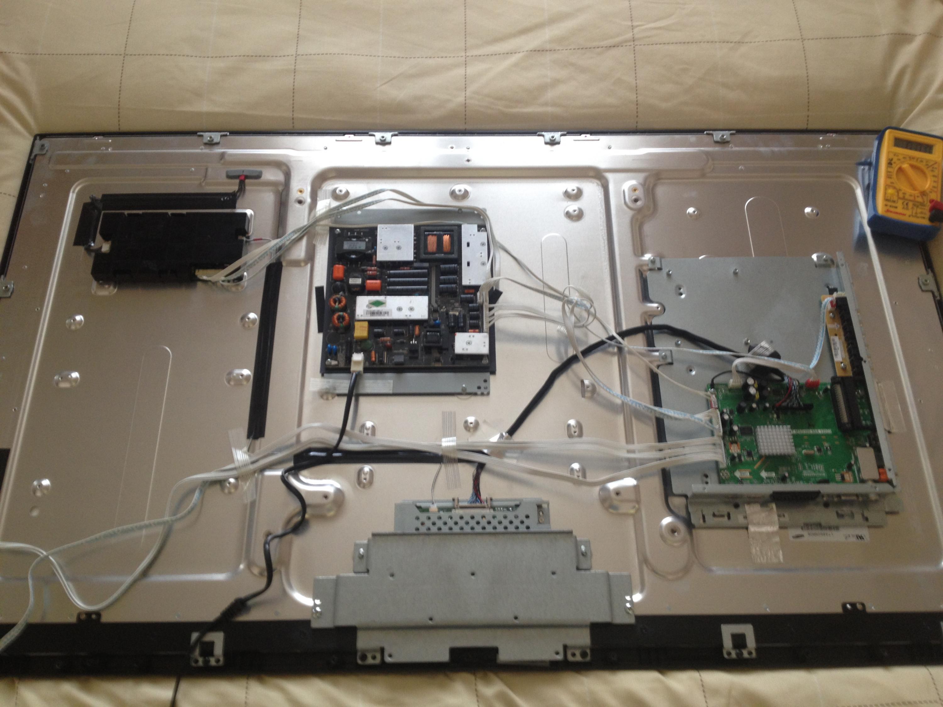

    this is an intermitent problem with the standby light,
    the light will turn on when first pluged in and stay on for around 15 seconds before going of,
    other times the standby light will stay on for hours.
    after doing volt checks on PS, all are correct, 5 volt standby is constent from the board to the main board,
    now this has a 2 colour LED, red for standby and blue for on, while the red is on i read 1.78v, when the light goes out after 15 or so seconds the reading drops to 0.28v.
    now, i must point out that if you hit the power button at the right time the tv will come on and stay on with now problem for days, other times if the timing ain't right the standby light will turn blue to say its on, but nothing happens.
    any ideas ?

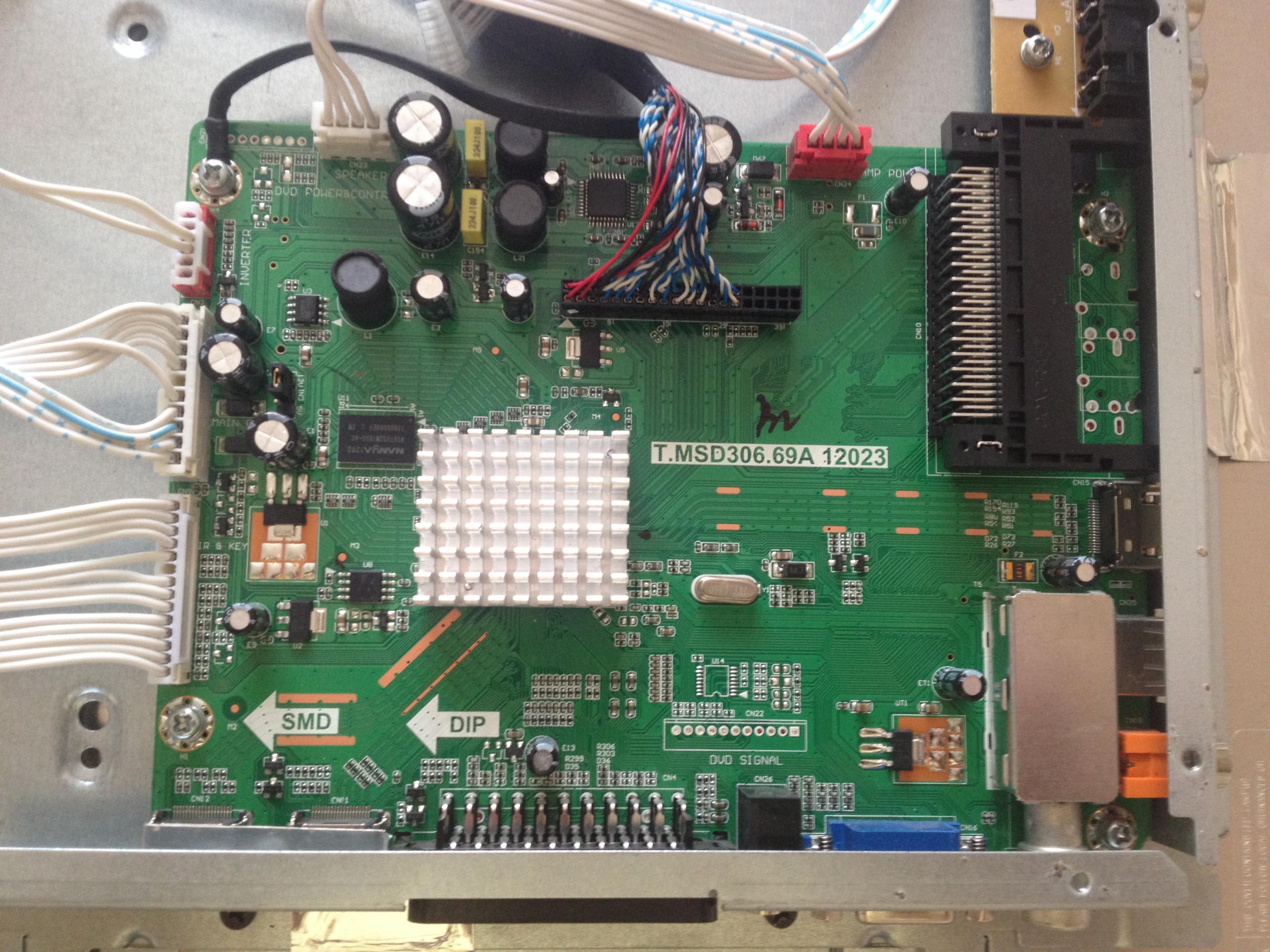

          Re: JMB JT0246001/01 Stand by issue
          tom, can you point out regs from my pics at all ?
            See this thread
            https://www.badcaps.net/forum/showthread.php?t=22231
            • finntricky
              • Jan 2014
              • 449
              • uk
              thanks tom, that helps alot
              this is my findings
              reg is
              1117 - 8
              AD 642 k
              pin 1 = 0.61 and sometimes 0.00
              pin 2 = 1.87
              pin 3 = 3.52
              all other regs read the same
              pin 1 = 0.00
              pin 2 = 3.30
              pin 3 = 5.15
              all reading done from left to right, gnd out in
              so looks like i have found the bad reg, YES ?
                The reg with the leg at 0.6V may be OK, it is an adjustable type. However please check the voltages on this regulator when the TV works and when it does not, including both when the power light stays on or goes off.

                    i have had problems with JMB sets stuck in standby and its all ways been eeprom try with main board number T.MSD 306.69A and look on OHM supplies and see if Andy does one,it my not be for this set but if it has same panel it could work, also try looking up the Sky media web site there could be a firmware update on this model Flocko

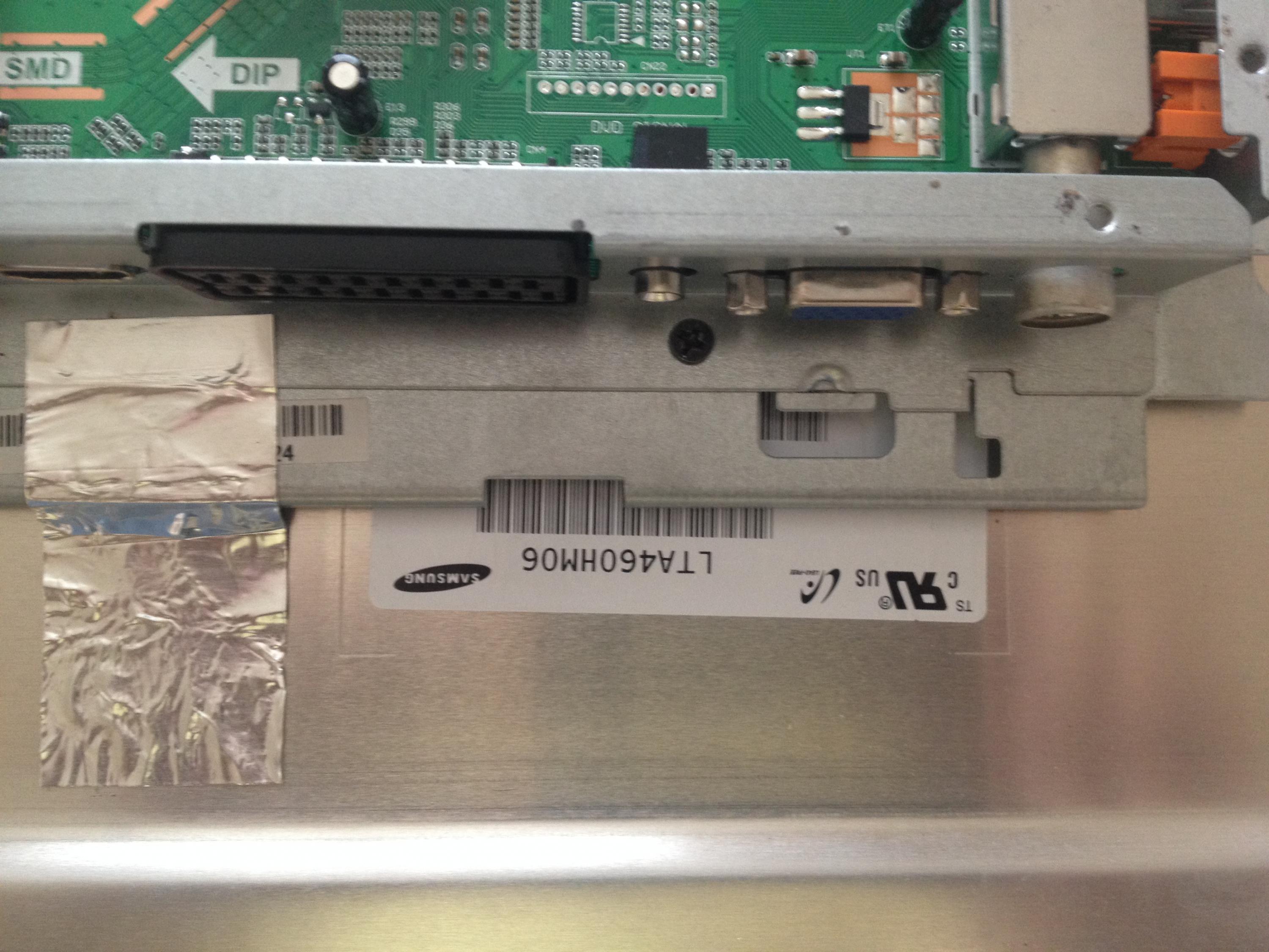

                                Lta460hm06
                                  Ohm Supplies list for a technika 40" that has the same main board T.MSD306.69A and all so uses the LTA4000MO7 samsung panel and lists as cct u10 that must be on the back of the board as not in photo,if it was me i would first check that your board has the eeprom there, and if so i would give it a try, as all these are made by the same factory and with the same main board and panel (LTA)as yours i am thinking it will work,as i said i have done this mix and match before and it worked i cannot 100% say it will but the odds are on your side Flocko have looked on Ebay and main board is the same type 181432735269 in to ebay to look
                                    beginning to think firmware as well now,
                                    as i have just discovered that the power to the main board all shuts down after 15 seconds except the standby power, this keeps the standby light on solid with no probs.
                                    it seems that the boot process gets to the point of saying, ok im ready to go,
                                    or it get to the 15 seconds and says, no way and shuts of the standby light, and leaves power on the mainboard, while it tryes to sort it's self out,
                                    how does that sound
