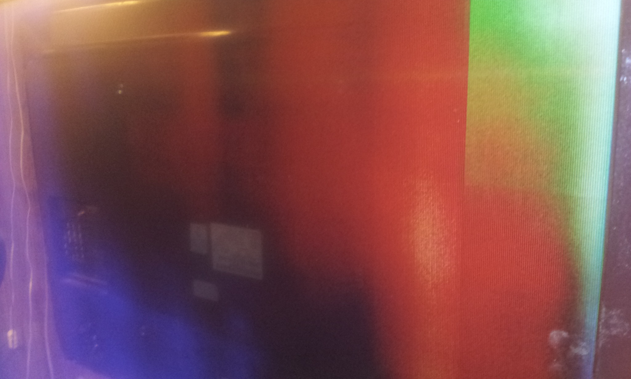

    Sony KDL46S5100 Screen or Main Board?
    Had no backlight. Tried another P.S. same. Jumpered back light on and screen lite up but no pic or sound. Main board is bad because it does not send backlight on command to P.S. No sound either. So is thee tcon and screen bad also?
