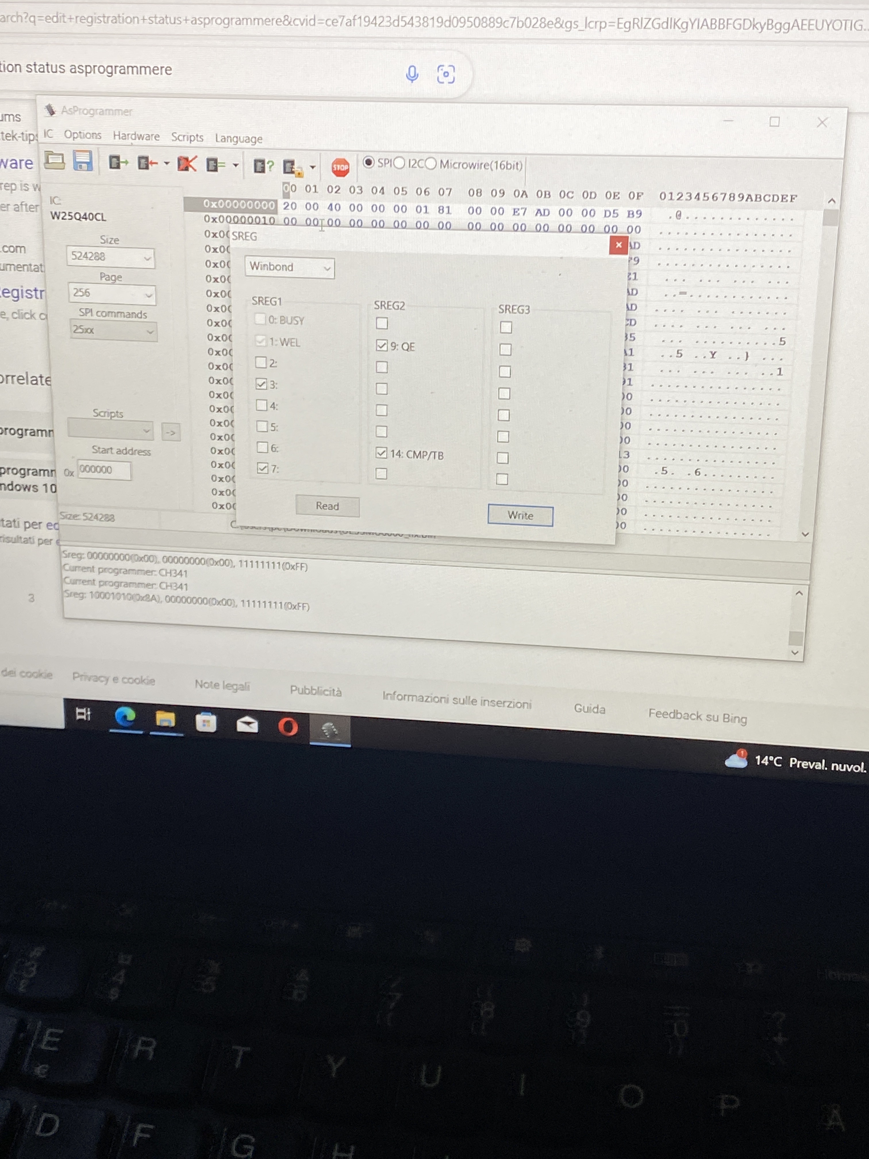

Someone can Check my UE55MU8000 Bios, Backlight no screen no standy
  • Asraf Atb
    • Jan 2025
    • 9
    • Italy
    hi following my post of yesterday i manage to extract the Bios from the chip of my UE55MU8000, can some have a look and see if is corrupted like other MU series that happen often, appreciate in advance
    Yes, I can, the dump has been checked and fixed, try it, don’t forget to set and write the status register (0x88, 0x42) after writing the corrected dump.
      thank for reply I need to put here ?
        What programming software do you use? You need the program "NeoProgrammer V2.2.0.10".
          my friend I’m using ASprogrammer and I find this menu to edit reg can you check

            ASprogrammer does not work correctly with the status register, install "NeoProgrammer V2.2.0.10".
              fixed my friend thanks you
                Hi my friend everything is working, only wifi look not working like there is not Mac adress in about tv, could be something related to the firmware or I could damaged wifi of the TV, let me know
                  This firmware has no effect on Wi-Fi.
