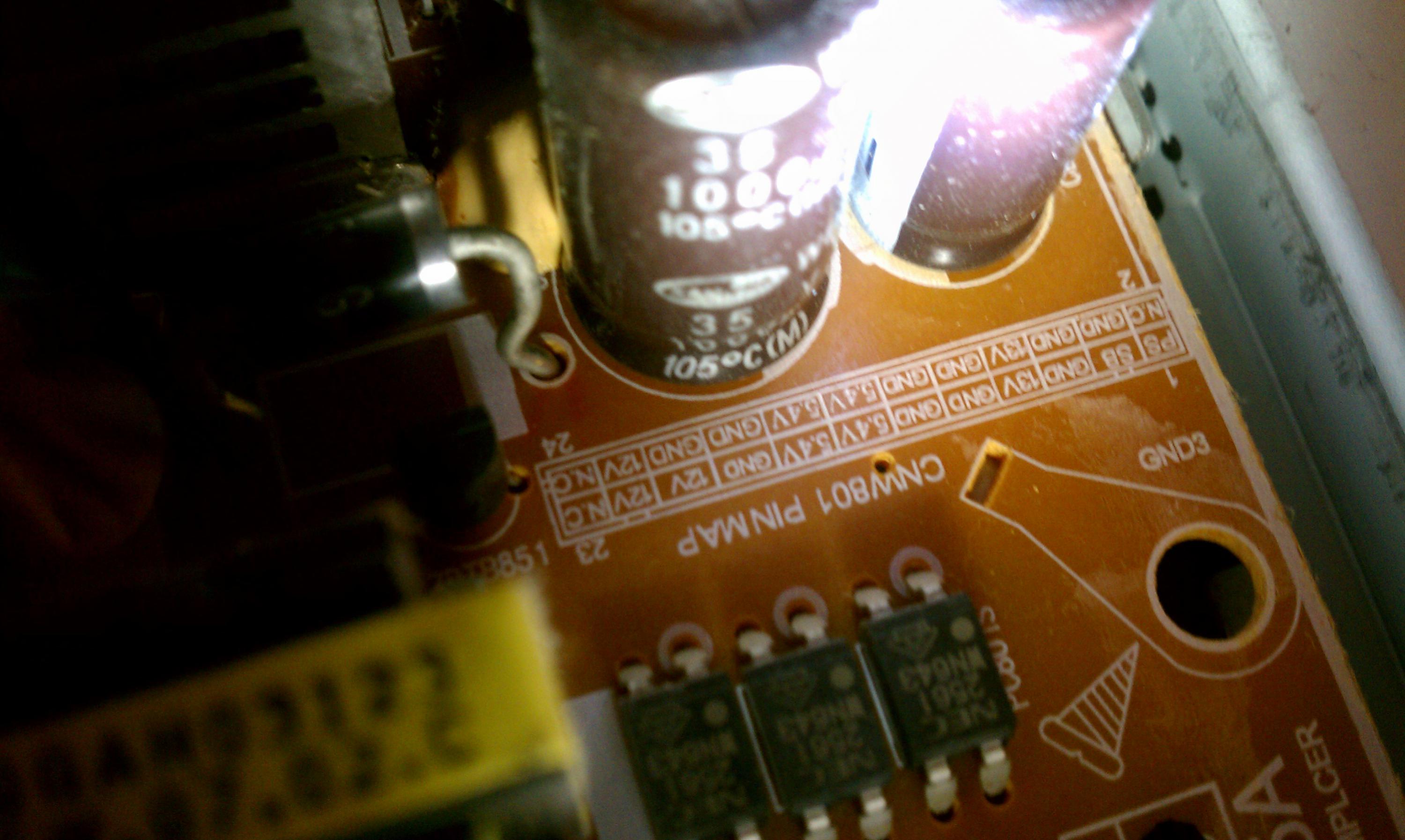

                            and wouldnt you know it but i got ANOTHER one of these TV's today...or so i thought. when i opened it up i noticed the PSU looked the same but the motherboard, TCON, inverter, and i assume the panel as well are all different.
                            and although the psu looks identical, it has a different model number!
                            way to keep me on my toes, samsung!
                            apparently this is the W model of this TV...
                            anyway im pretty sure it needs a new tcon cause the image is solarized a bit. im not sure if i want to sink money into a new tcon for this thing though because the screen has a fair amount of scratches and i might not be able to sell it for much. might be worth more as parts.
                            but then i was thinking what if i could swap the parts into the other TV? the connections look like they would work..but do i run any risk of damaging parts by doing this?

                              Re: Samsung LN-T3242H works fine for a day, then wont turn on. intermittent.
                              Have you changed the capacitor of psu? It seems that this models have some problems with their power supply.
                                neither of the PSU's has any trouble lighting the backlights so i dont think this is my issue...i since making that post did do a fair amount of swapping and found that the parts are compatible. you have to use some wires to get the small connector on the inverter to work with the difference size clip but they are basically the same i guess. one PSU puts out 12v and the other puts out 13v so i guess its close enough. i was trying to make a dollar out of 55 cents here but i guess i need a few more nickels. with any luck ill run into more of these TV's...
