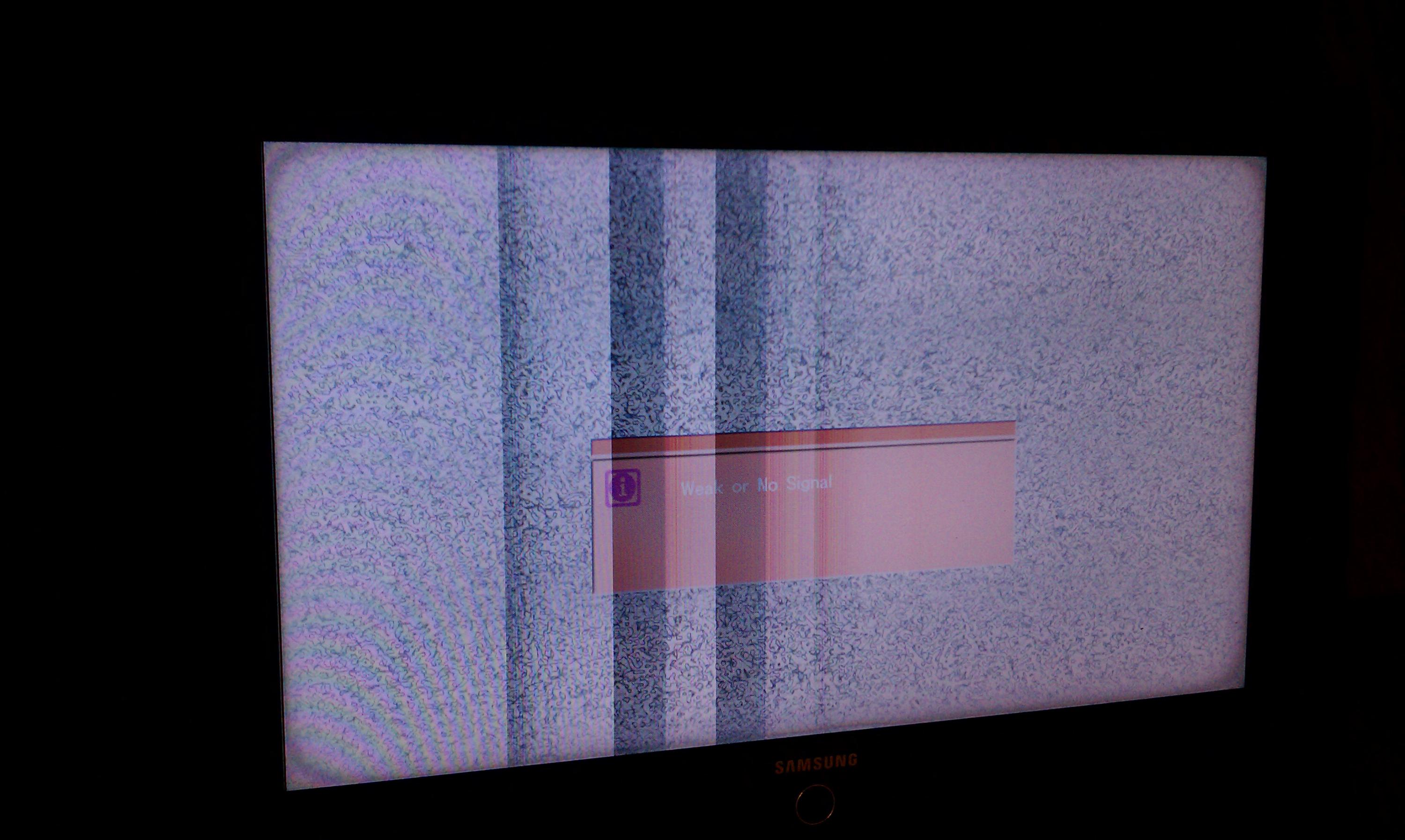

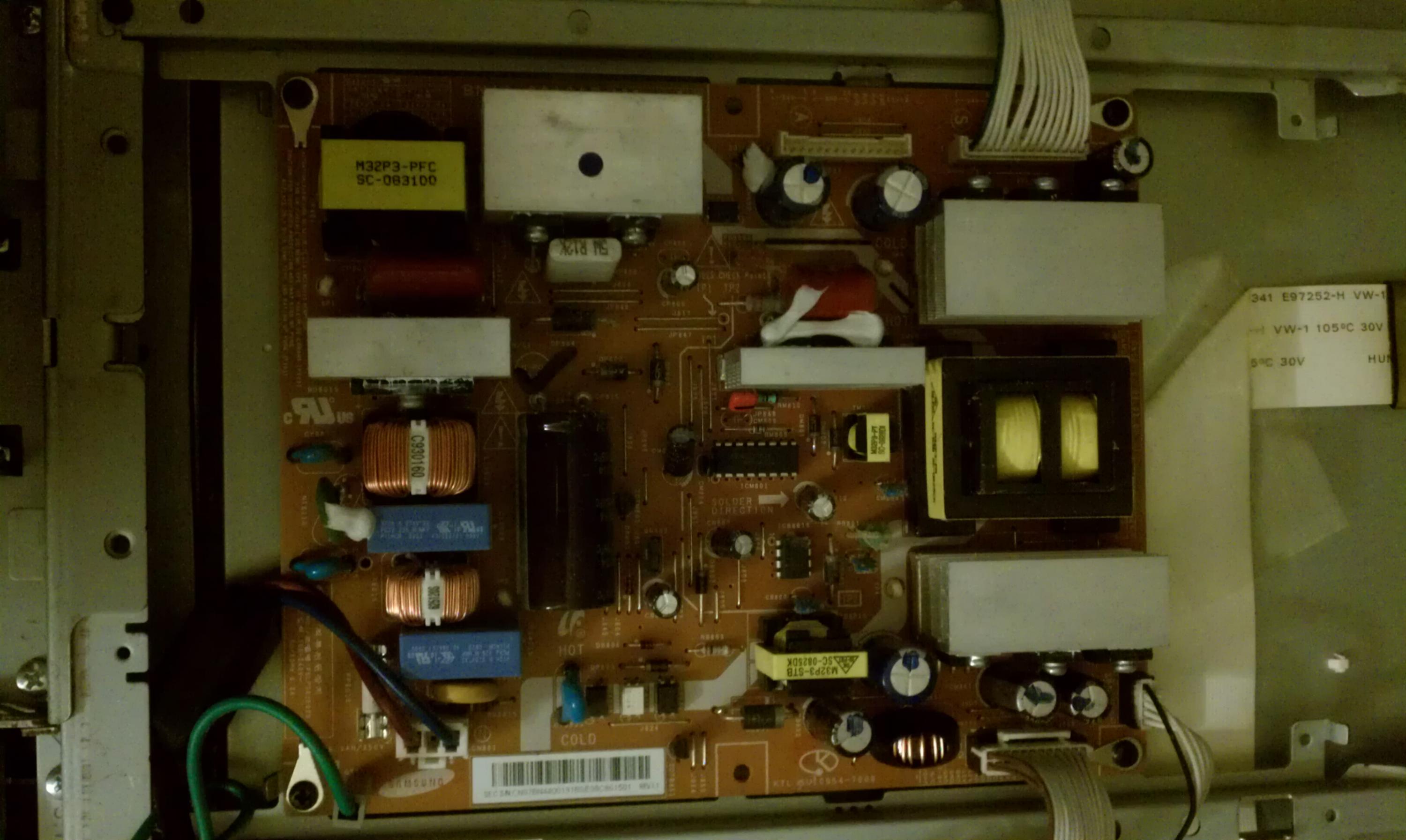

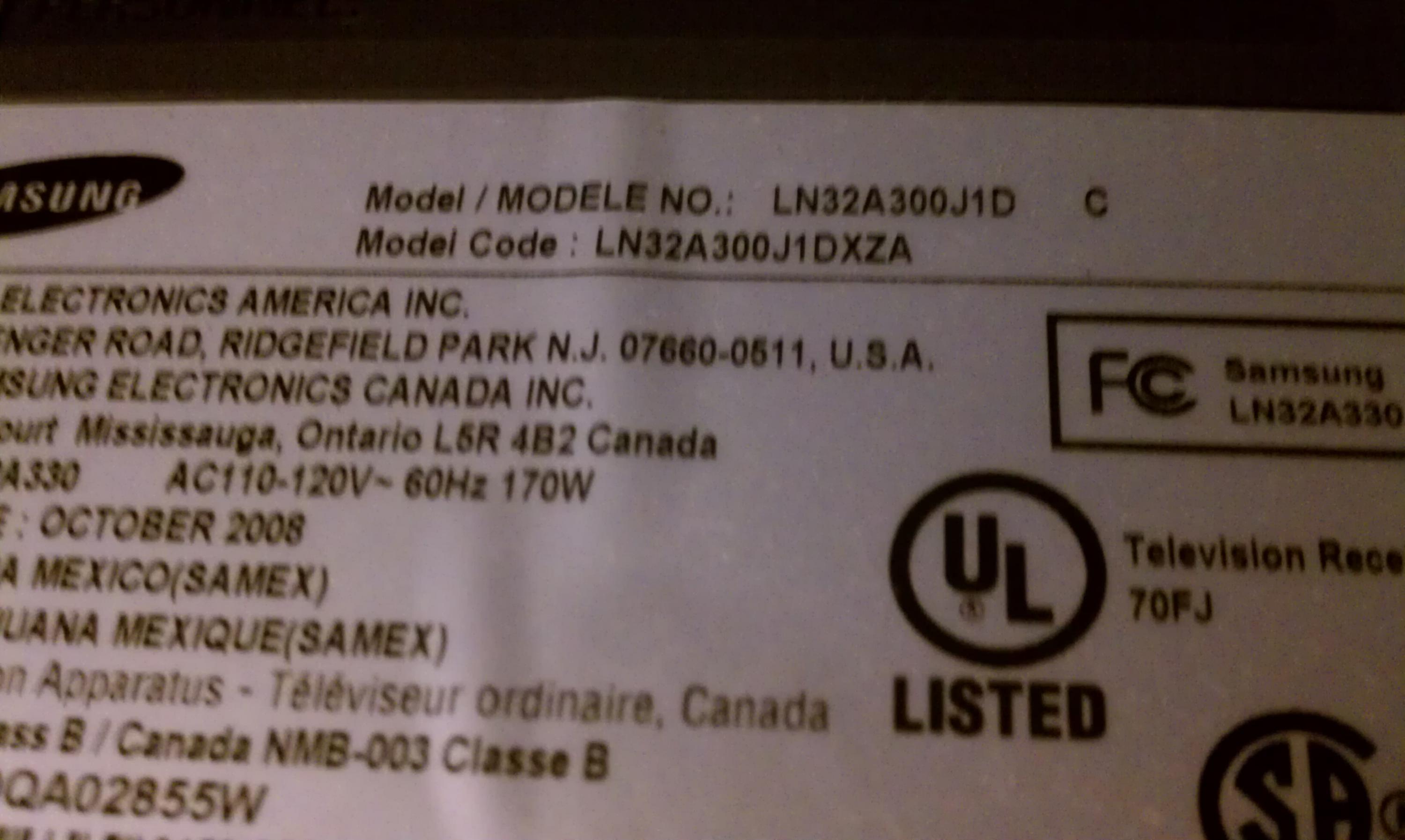

                          well an interesting thing happened...
                          since ive been buying/finding/being given all sorts of TV's lately, i came across a very similar model to this TV
                          the SAMSUNG LN32A300J1DXZA
                          it looked like it maybe had a bad TCON as you can see in the pictures.
                          turns out the LN-T3242H uses the same panel, and therefore the same TCON and same inverter board.
                          first instinct i had was to try the inverter board from the LN-T3242H
                          in the LN32A300J1DXZA to see if it really was a bad board as i was suspecting.
                          as i expected, the backlights would not come on.
                          so then the next thing was to try the known good inverter board from the LN32A300J1DXZA in the LN-T3242H
                          since last i checked, that was the only thing wrong, i thought for sure this would result in a working TV.
                          but when i turned on the LN-T3242H, it didnt make the good chime..it just made a long beeeeeeeeeeeeep that lasts like 20 seconds and then finally goes off for a while...then the tv tries to restart and makes the long beep again, and does this over and over again. no backlights, no nothing...
                          seems like the motherboard is throwing some kind of error code and shutting down
                          after unplugging the set and holding power button down for like a minute, and plugging it back in, i was able to hear the good chime, but then shortly after it went into the bad beep again...
                          i tried putting back in the original inverter, disconnecting the inverter, the TCON, speakers, button board, anything i could think of but the beep was still there (well not when i disconnected the speakers, but as soon as i hooked them back in it was there)
                          so it looks like i got some kind of motherboard issue now with this TV.
                          but then i realized that since the TCON were the same, and the TCON in the LN-T3242H was known to be good, i could swap them and at least see whether i had bad TCON or bad panel in the LN32A300J1DXZA...
                          after swapping the TCON, the LN32A300J1DXZA is a perfectly working TV!
                          this is the first time i have collected enough tv's to actually be able to swap parts. usually they make everything different as fast as they can!
                          anyway im real happy about fixing this new TV but i'd still like to figure out what's up with the original TV that now has a motherboard problem. since i have parts to swap out, i think i should be able to do it.
                          it even looks like the PSU and motherboard can be interchanged ...the connectors look the same but the PSU and motherboard's guts are definitely different. similar circuits, but different components... i didnt want to try it yet without asking for advice since i have one good working TV out of the deal and i'd feel pretty dumb if i blew it by trying to test the other ones PSU on it... how can i know fore sure if that would be safe?
                          or better yet, how can i troubleshoot the motherboard and stop it from going beeeeeeeeeeeeeeeeeeeeeeeeeeeeeeeeeeeeeeeeep??
