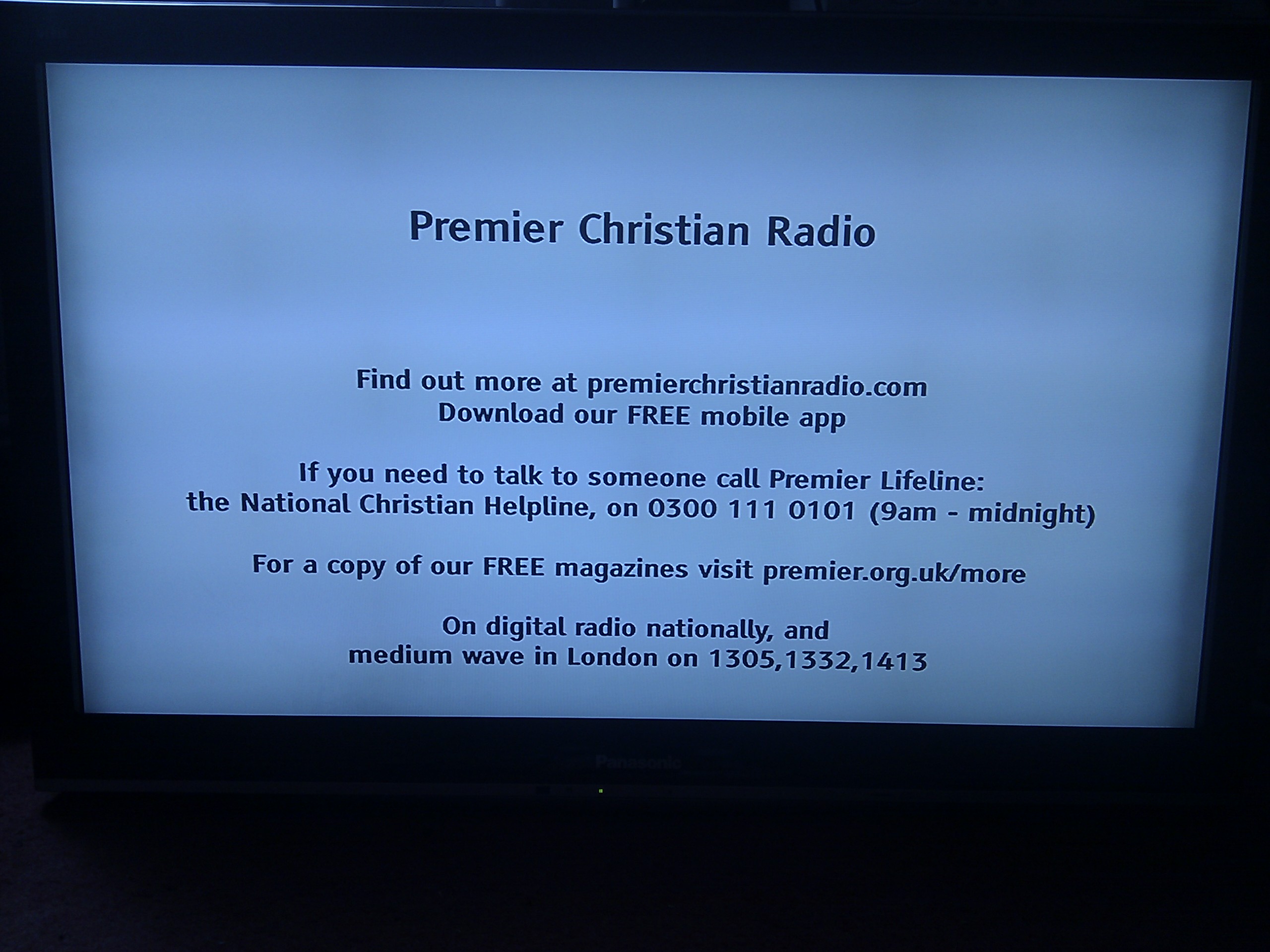

    I think my newly aquired second user TV (Panasonic TX-L37V10B) has mura, possibly.
    For a few centemeters on the left and right of the screen it is darker looks dirty but isnt, classic shadow, like a vertical strip it goes from top to bottom on both sides. More visible in light scenes and all inputs. Does this sound like mura?
    I only noticed this the day after collecting the TV, and not being aware of this type of thing existed I paid and left with the TV.
    I have yet to identify how to fix the tv, if at all possible. I am trying to avoid opening the back up.
    I have tried pressing a cold item from the freezer as a video on youtube suggested but to no avail.
    I am now trying the technique you are describing tom66. I have removed the base and laid the screen down on the carpet. I have laid it face down, so the screw side is on top, is this what you did tom66?
    I have lossened the screws, and it is laying screen down. What is the purpose of removing the cover only to put it back on after 2 days, what effect will this have?
    This may not come to anything, but worth a try. Any advice appreciated.

    Re: Panasonic TX-L37V10B possible mura or shadow or dark areas
    Loosening the screws of the case will remove any stresses the case may be presenting to the screen-frame.
    Must admit--Ive not heard of this cure for Mura--I'll try it when I find another set showing it.....
    Ive seen quite a few Toshiba with this issue--One set was perfectly fine when cold, but after 6 hours showed up pretty badly. Cold the next day--perfectly fine again
        Hi thanks for the replies.
        I thought I would post a picture so you guys can see what its like.
        I put it on this radio channel for the white background.
        It looks like the picture from cold.
        I wonder if this picture can give any insight as to what it is and what I could try to fix if possible.
        Would laying it down flat on its face make it worse?
        Should it be lying on its back with the screws down, or will this be worse as possible dust can get in?
          That is not mura, that is backlight unevenness.
          It is possibly due to slightly worn out bulbs from the panel being old. Probably bulbs getting older and darkening on the ends. I am guessing this TV either uses an LG panel or a Panasonic IPS Alpha panel.
          It might be annoying but 99% of LCD panels have this. Pretty much the only panels I have seen without it are the smaller ones, and LCD monitors. Look up LCD uniformity issues.
            Ah right backlight unevenness, thanks for the clarification.
            I have looked up on the net for a fix, but the only one I found was from you in this thread: https://www.badcaps.net/forum/showthread.php?t=20070
            Is an easy fix posible or very hard to say or no possible fix?
              Not possible to fix - fundamental characteristic of how the panel is made.
