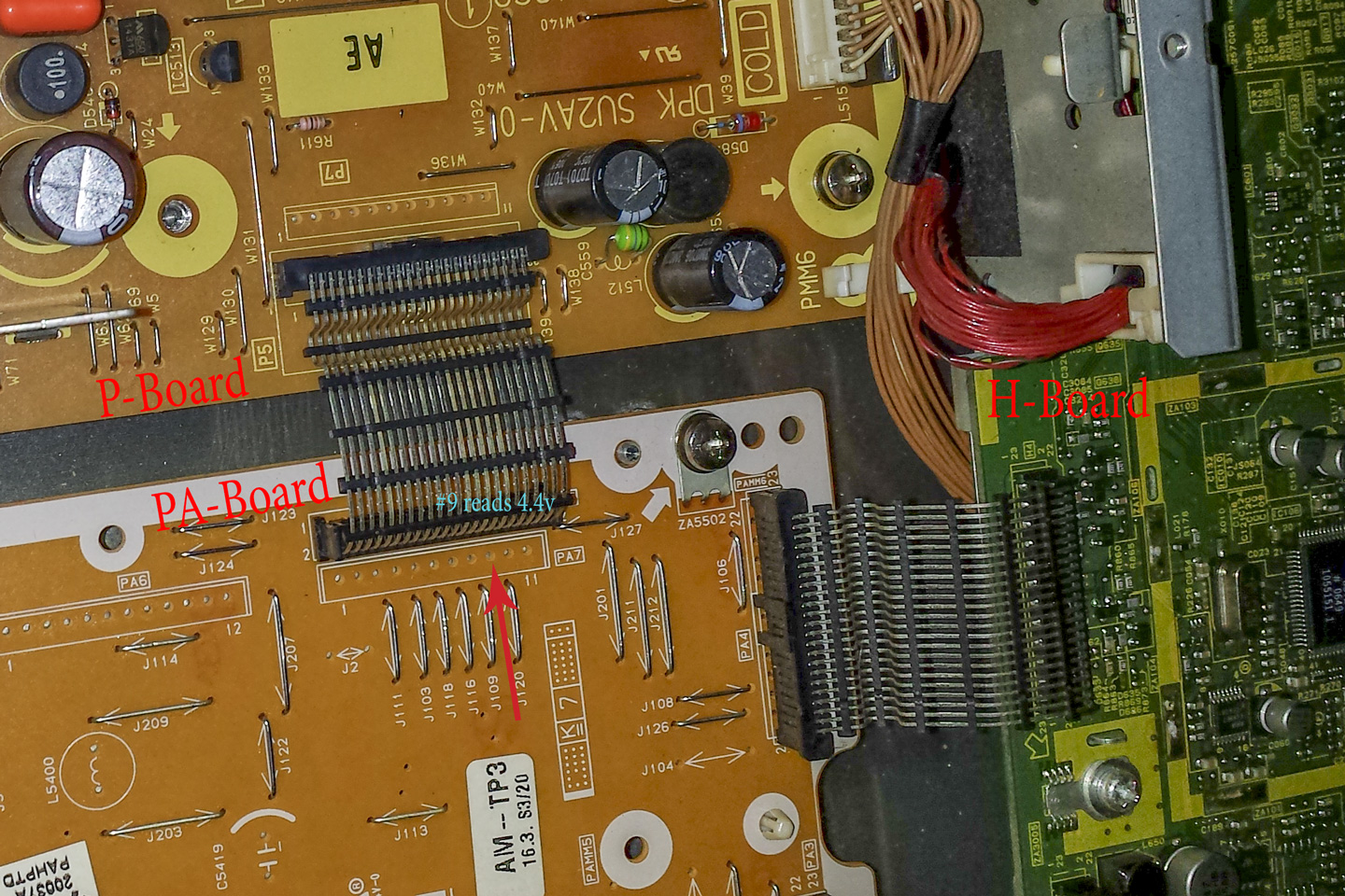

    The TV comes on for a while (about 30min.) then shuts off. If I turn it off and on again I get the 10 red blinks from the power light.
    When it does turn off the power light stays green, and so do the LEDs on the SC & SS boards.
    When it fails and I turn it off and on again, I get the 2 clicks then a pause the the third click and the red power LED.
    I've taken the back off and see no obvious signs of a problem. The caps all look good. All Rubycon & Nichicon. I did the self check and it came out all OK's
    It will fail on air channels or a digital source HDMI, and I can accelerate the issue by turning it on and off a number of times.
    Looking for some help here I'm a relative noob at TV repair. And reading the Service manual is like trying to read Greek
    Specific instructions on where to put the probe tips and what to test would be great help.

            Your tv seems to be completely different than mine, however two of your sub voltages appear to go through that triangular board in the middle, have you tested to see of the 5v and 9v are present there?

              Re: Panasonic TH-37PX70E 10 Blink
              See Pic., reading 4.4v doesn't sound right but I don't know.
                no 4.4 doesnt sound right, it may be that it is at the threshold of triggering the error and could be why it works sometimes. Was that will the other boards connected? Not sure if maybe you lave a leaky diode or something else dragging down your voltage. now to try and isolate which board has the issue. The service manual isnt very helpful on isolating each board resistance testing may tell you if you have a mild fault on one board.
                  Yes this was with all the boards connected, and the screen was on (ie TV working).
                  I'm going to try and get the voltage when the TV is in the fault state.
                  Can you expand on resistance testing?
                    Most of your voltage rails will have between 500-2000 ohms to ground, so you can check ( with a multimeter) the resistance between each circuit and ground on each board. if you were to find one that was low (say 100 ohms) then you could try to trace out what part on that board is causing your trouble.
                      I got 1 Meg ohm between the #9 and ground
                        So much for an easy one, you may have to look through the schematics as the fault can be beyond a switch, relay or mosfet and wont be apparent until the tv is on. It can be a real chore to figure out where all the circuit goes. I would test to see if you 4.4v does indeed drop when the tv is malfunctioning before spending many hours pouring over the schematics, it may be a red herring.
