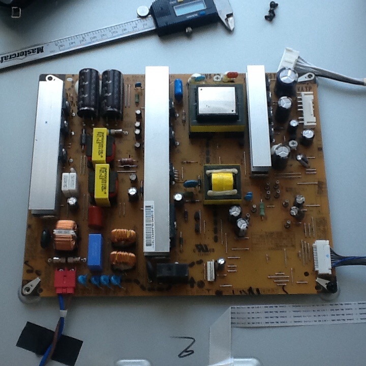

      I'd like to pick up where this thread left off: got the same model LG with the same symptoms. PSU P/N:EAY62609701
      Have disconnected all cables to psu except line voltage and jumped M.ON to STBY
      The relay clicks twice and there are no output voltages except 5.2vdc STBY

        Do you have a way to take an up close picture of your TV's power supply ?

          Re: LG 50PA4500 Clicking troubleshooting HELP please...
          Both sides?
            My psu
              ...and this
                Replace C802 Capacitor (circled in the photo below) It can be found on ebay.
                223J@1250V HIGH PULSE. If your unable to perform this repair I can assist you if needed.
                      So it looks like that cap is a .022uF @ 1.25kvdc pp. I'm not partial to eBay so ordered a hopefully suitable substitute from digikey last night; should be here by end of day... we will see if that's the fix...
                              Ok the new caps arrived; took out c802 and tested it-nfg
                              Checked the new cap- on spec@ .0215uF
                              • Fwrothy
                                • Feb 2014
                                • 178
                                #35
                                Ok new cap in and board remounted in chassis...
                                Left all cables but AC disconnected.
                                Powered up psu-ONE RELAY CLICK!
                                Checked voltages at main cap- ~390vdc
                                Jumped M-on to STBY, all voltages including VSTP & VATP check out.
                                Power down, reconnect Y&Z sus cable and main board cable.
                                Plugged it back in and it Works!
