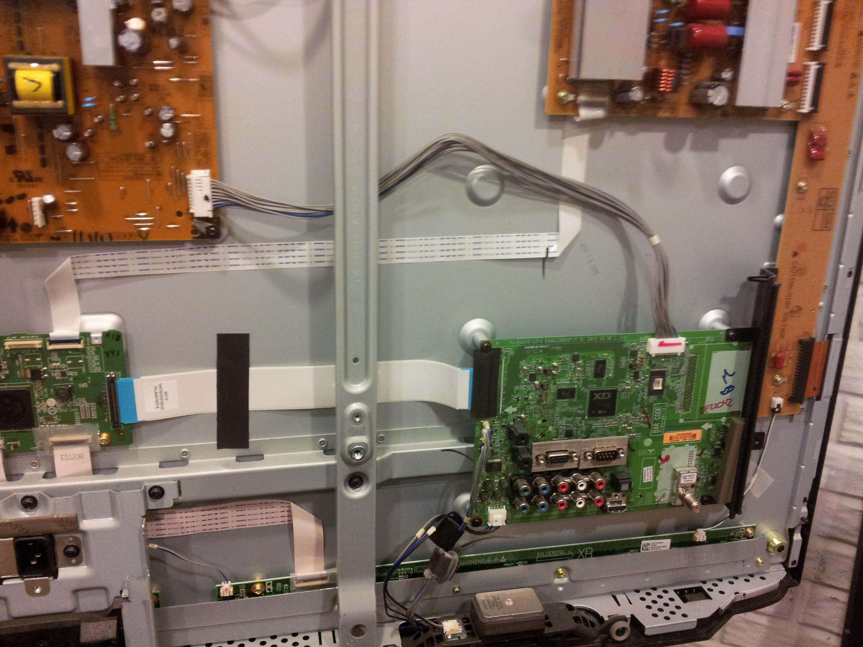

    I have a LG 50PA4500 That's just clicking never turns on. I have the back off and am wondering what order to remove cables for troubleshooting. or if even better yet anyone has a service manual for it ? any help is appreciated. I searched the forum but only 3 threads none of which pertain to anything but lines being displayed. Thanks
    Re: LG 50PA4500 Clicking troubleshooting HELP please...
    Any pictures of the boards inside? Did you check for the common torn ribbon issue, which affects the PA5500 and PA650 models?

      I've checked all ribbon cables and they seem to be good as I didn't see any obvious issues but I'm unaware of the ribbon issues with the models mentioned and can't seem to find info on it so not certain where and what exactly to look for there. here are the pictures of the setup.
        Does the set click continuously or just a few times?
        The ribbons are on the left of this image, orange ones. The razor thin design on these seems to eat into the ribbons making the panel essentially junk.

          When I plug the set in it clicks repeatedly not just a few times. it's as if it's trying to start over and over again . each time it tries a little red light comes on for a half a second on the mainboard.
          The ribbons all appear to be good to me from what I can see .
            OK, the Z-sustain (right hand board) is connected to the power supply
            Try unplugging that then powering the set on, does it still repeatedly click? Note, it should still click once or twice, just not continuously.
            Then try unplugging the Y-sustain (left hand board) from the Z-sustain and reconnecting the Z-sustain. Check again, does it click?

              When I disconnected Xsus it would only click one time. reconnect Xsus and disconnect Y-sus and it would only click one time. reconnect all of them and it only clicked one time as well. but if I unplug it for a while it will go back to multiple clicks. I only disconnected the cables going from PSU to the board no others.
                From your description, it sounds like it might be a main board fault. I'm thinking this because there doesn't seem to be a consistent pattern with one board unplugged that allows it to work?
